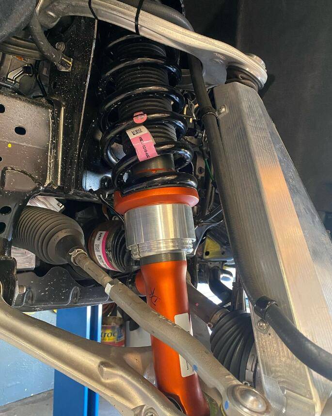

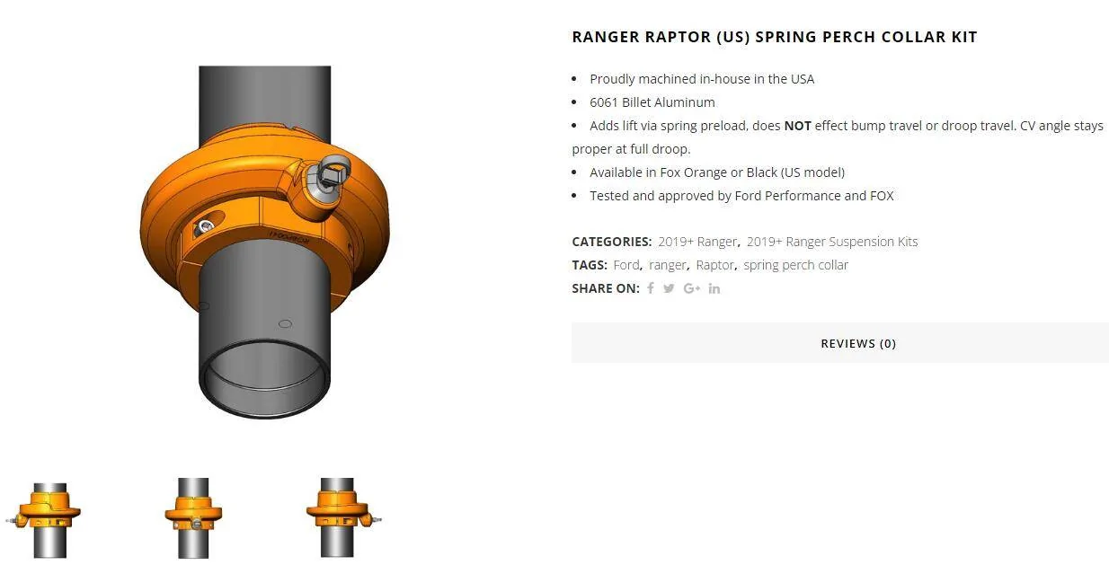

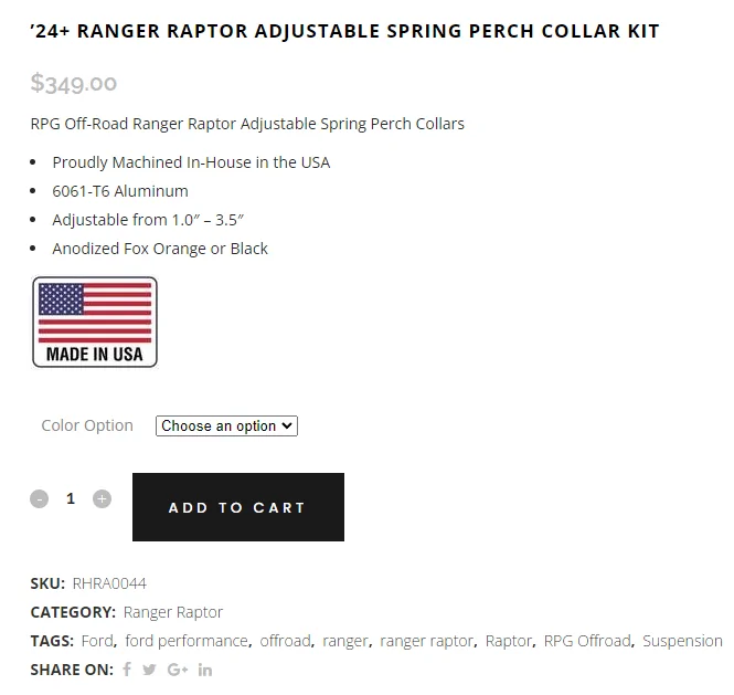

RPG Off-Road Ranger Raptor spring perch collar kit (US). Looks like they are approved both by Ford Performance & Fox.
Priced at $349
who's getting these?
https://www.rpgoffroad.com/product/24-ranger-raptor-adjustable-spring-perch-collar-kit/
Welcome to the RPG Off-Road ’24+ Ranger Raptor Adjustable Spring Perch Collar Kit!
If you’re looking to increase the ride height of your all new Ford Ranger Raptor, whether it be for better ground clearance on the trails or a meaner overall stance, RPG Off-Road has you covered with the Adjustable Spring Perch Collar Kit. Machined in-house in the USA out of 6061 Aluminum, these collars give you plenty of ride height increase adjustment so you can dial it in as you’d like. These adjustable spring perch collars will allow you to choose between 1.0″-3.5″ of ride height increase by simply using the correlating snap ring groove.
These collars can be used on both the front coilovers and the rear coilovers. So far, we’ve seen that the Ranger Raptor needs to be picked up around 2.5″ in the front to sit level without any load in the bed.
