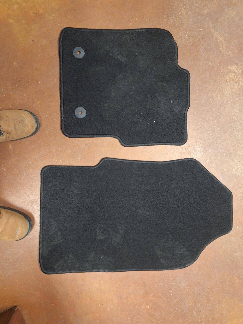

I'm in Cameron, central Texas.
Does the OEM set from your STX attach via the floor cleats? My probem here is that my STX with vinyl floor has no cleats, and no way to secure the mats. This is just another stupid Ford thing; no vanity mirrors, no driver's hand hold, no carpet attachment. Sheesh, how cheap can Ford get?!?
It is the STX, ie the stripper-model.

I took on of those cleats out of the truck at work, it basically just straps through 2 oblong holes in the vinyl. If you could get some cleats, you should be able to install them. You can also order XLT sun visors if you want the vanity mirrors. Not cheap though.

The trick is to run a hot wire or screwdriver through the bottom hole into the vinyl floor and melt a hole in it then work the bolt through the small hole so it kinda seals around the bolt and then screw it down. Id did it in my old jeep carpet to allow water to drain faster through the drain plugs. I rode with the top off and random rains would leave me with a lake in my floor boards lol.
