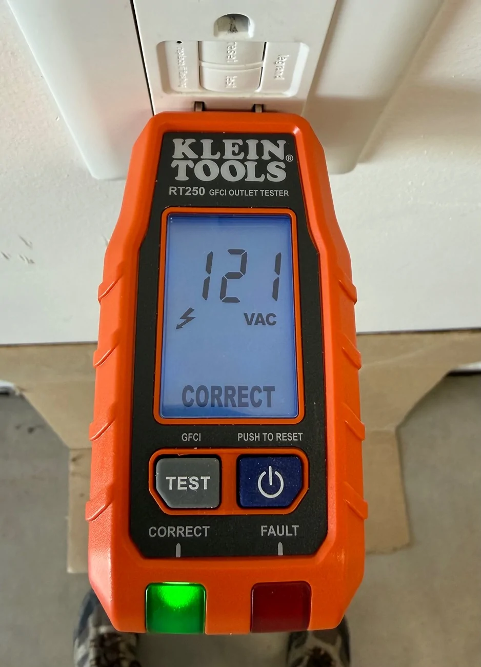

2024 Ranger Raptor, both the console and the bed outlets are dead. I am pretty sure these worked when I got the truck three years ago, but this is the first time I actually tried to power my Ecoflow battery bank. I used a Klein tester to see what is going on, engine running and in Park. Here is my wall outlet:
Ford Ranger 400 watt inverter dead, 30 volts, shows faults with handheld tester. IMG_3143

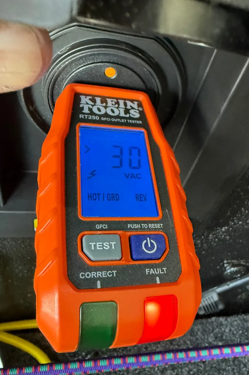

Here is one of the truck outlets, both show the same faults.
Ford Ranger 400 watt inverter dead, 30 volts, shows faults with handheld tester. IMG_3144

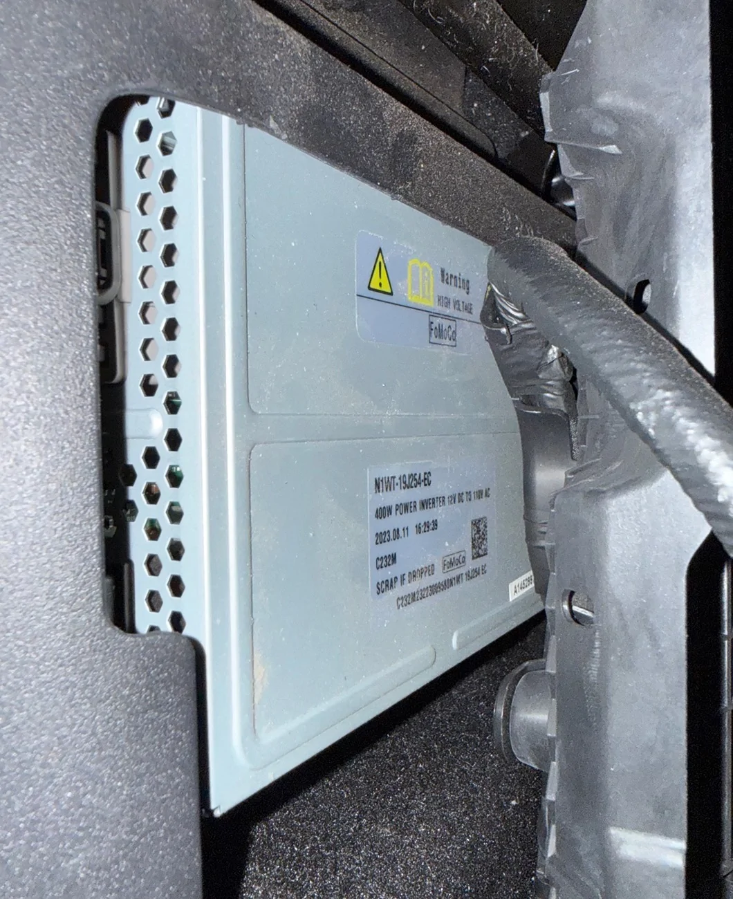

Ford Ranger 400 watt inverter dead, 30 volts, shows faults with handheld tester. IMG_3152
Any suggestions? Is the unit failed? Does it have a physical reset button? Are there any Ranger related service bulletins related to this problem? I have not checked any fuses yet.
Those HOT GND and REV errors sure look like a failed connector, outlet or harness……

well that delta 3 classic advertises one hour charging with ac so that means it’s drawing 1000 watts in ac mode and that is too much for the inverter.
but I imagine that tester is showing the voltage without a load?
I wonder if a fuse is blown.

The 60 amp fuse was fine, I am still in warranty, so we shall see. I have a couple of recalls to fix.
