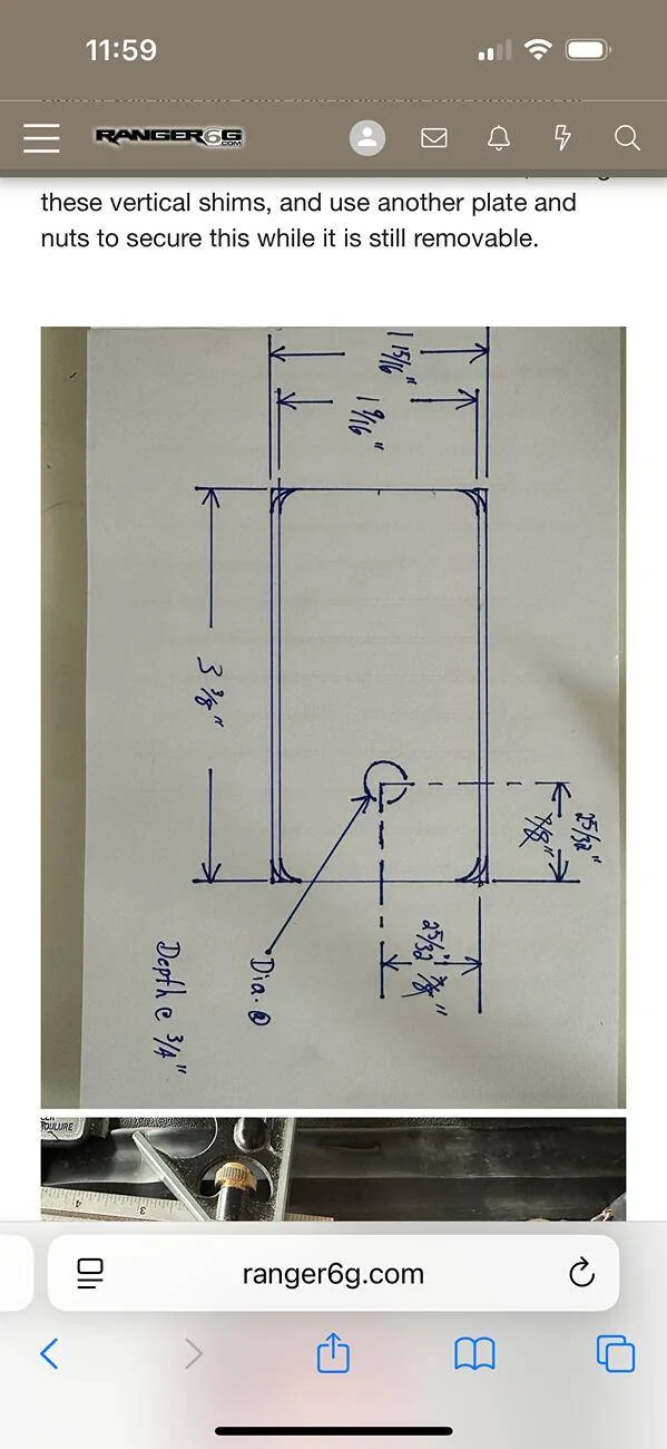

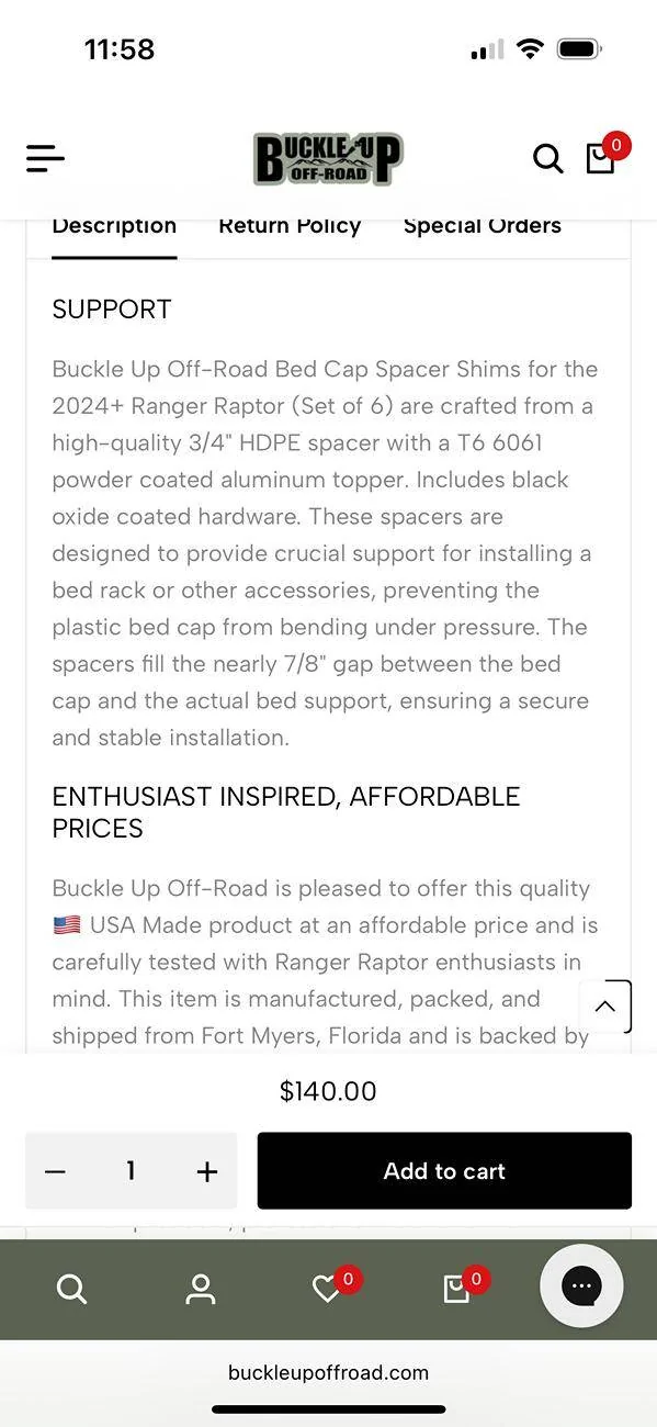

They should work. Their website indicates a material thickness of 3/4” Thats what I measured the depts of the pockets at from my 2024 Lariat.
