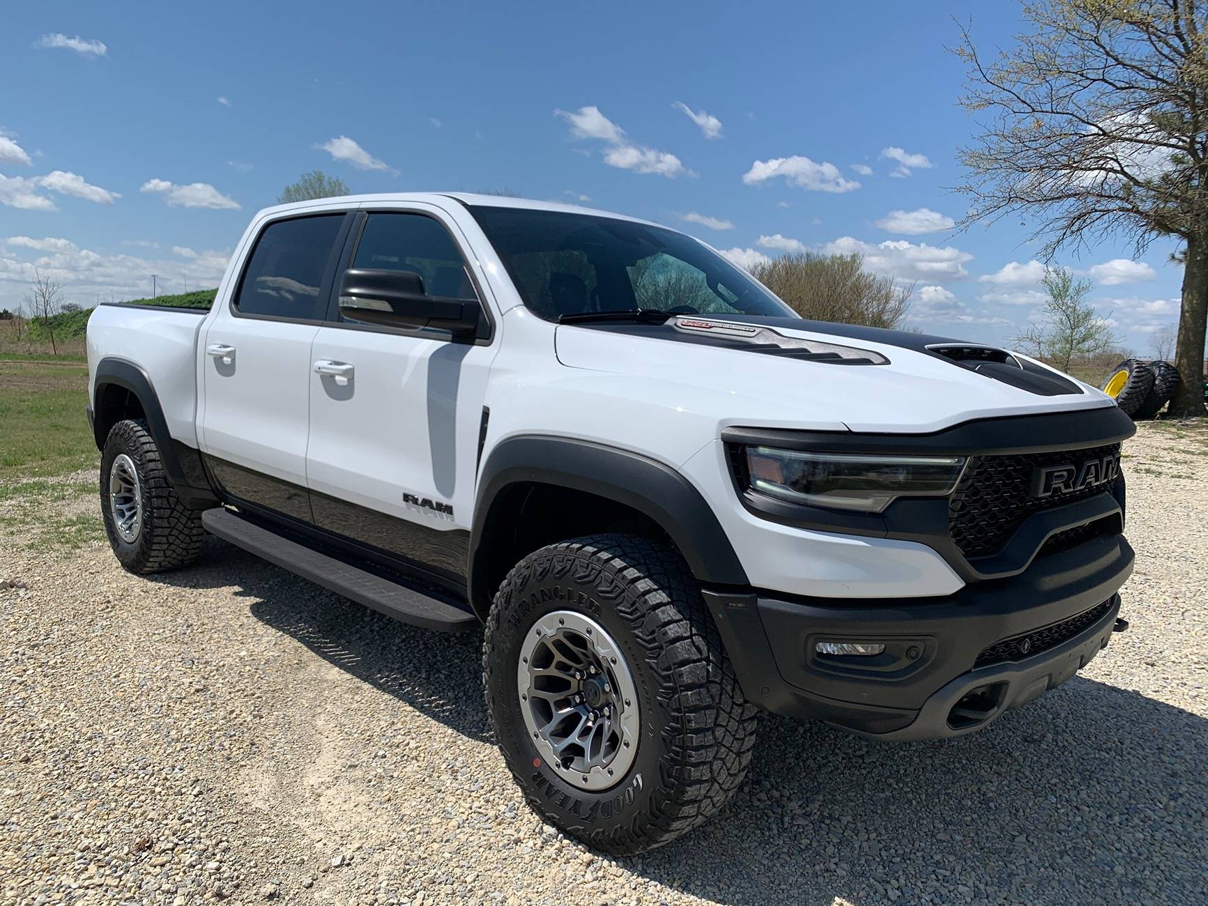

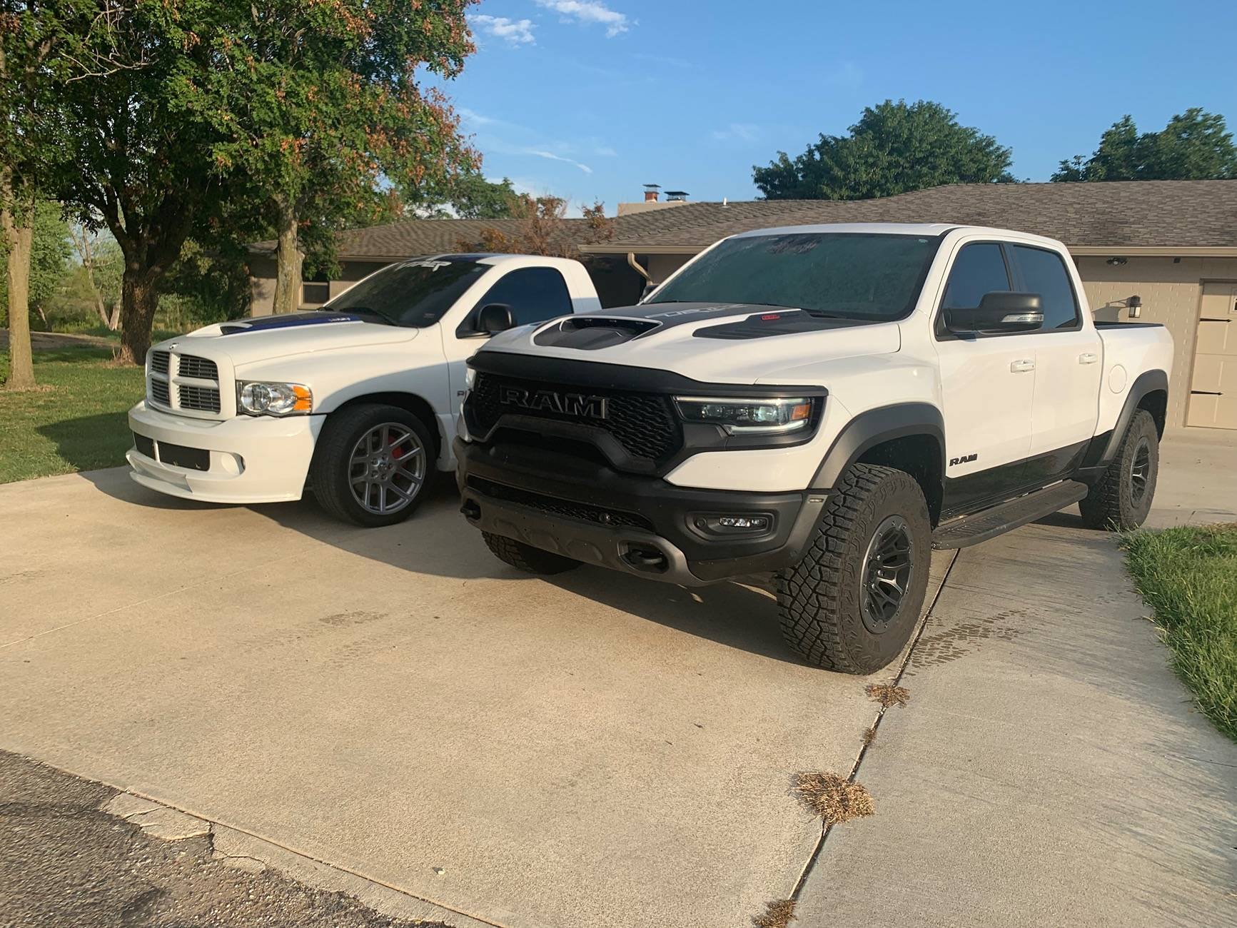

Did a color change via powder coating on my TRX rims.
They were grey with bright rings, now black with dark grey rings.
Should be very easy and pretty reasonable if just color changing the rings.
Before in stock grey with machined rings.

After color change rim tho black with color changed rings to grey.
