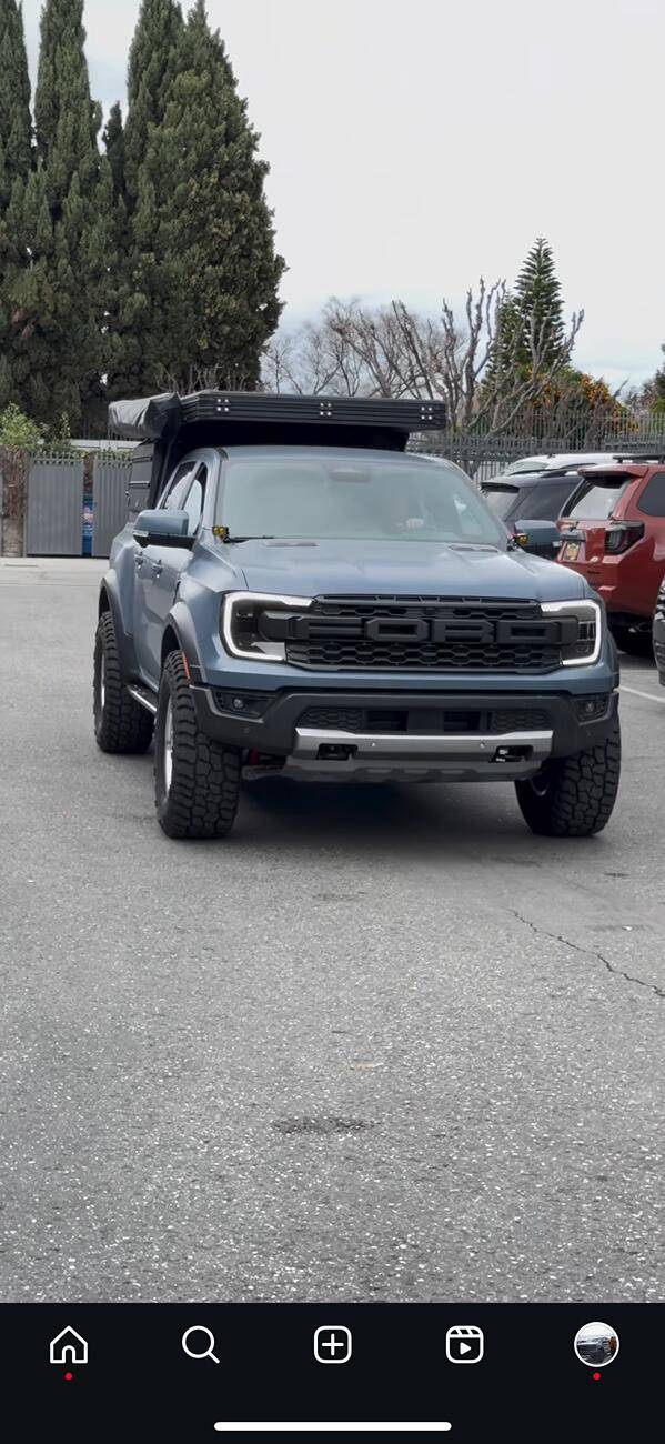

I just slapped on the 35x12.5x17 Mickey Thompson Baja Boss AT tires with Method MR703 +35 offset wheels. The only mod I did to make these fit was change out the crash bars with Readylift high clearance ones. So far no rubbing on normal driving. Looks like I would have to do some trimming in the front wheel well in the rear fender to clear the tires while rock crawling. Looks like the +35 offset wheels is the safe bet when going bigger with tires.

Do you have photo straight onto the front? Is there some poke from the tires or flush with the fenders?
Not yet, but I will soon when I go on my Death Valley trip. Right now the face of the outside tires are flush with the top portion of the fender. I don't like when the tires are poking out a lot.
