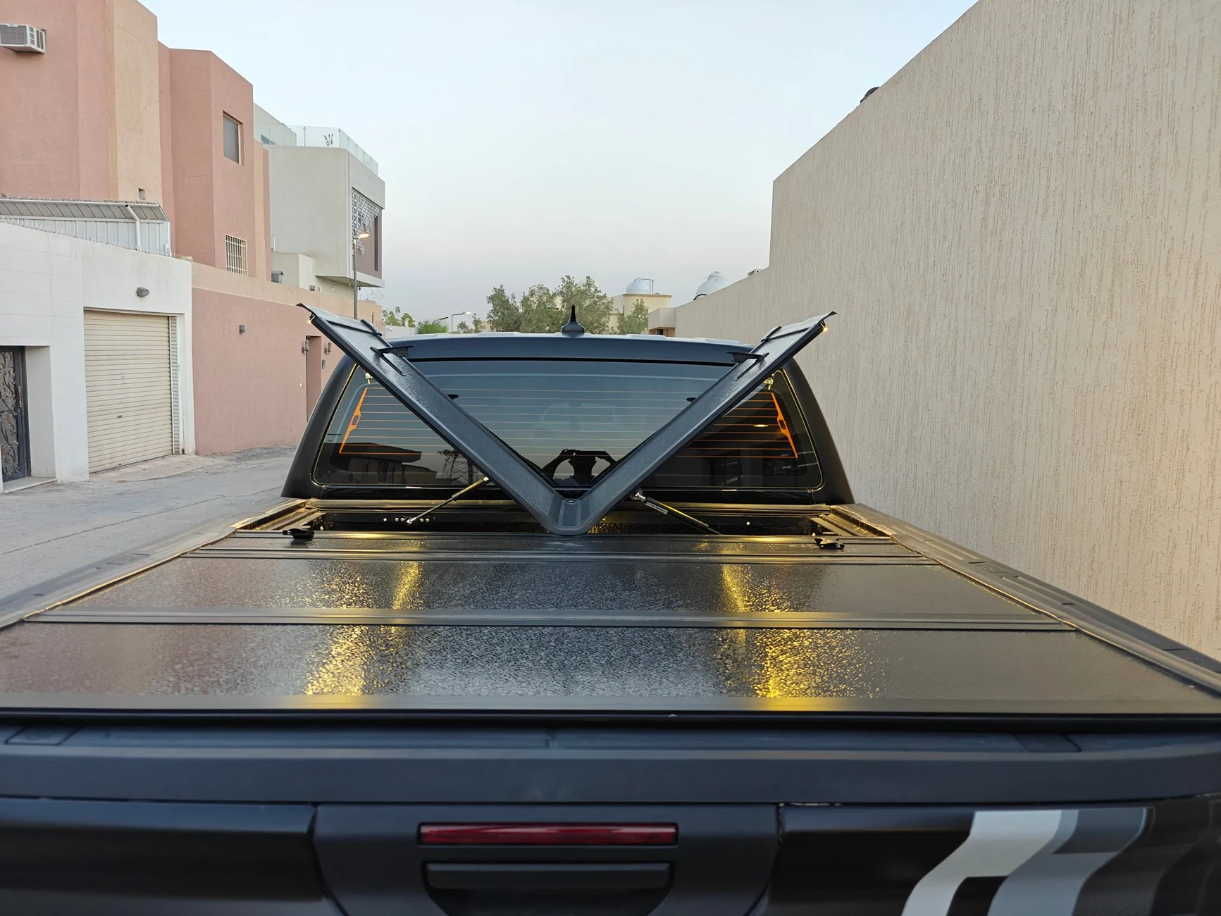

wanted to share custom job i did @ true cover in Riyadh, Saudi Arabia

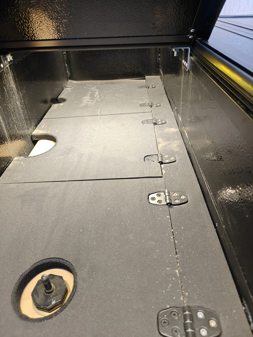

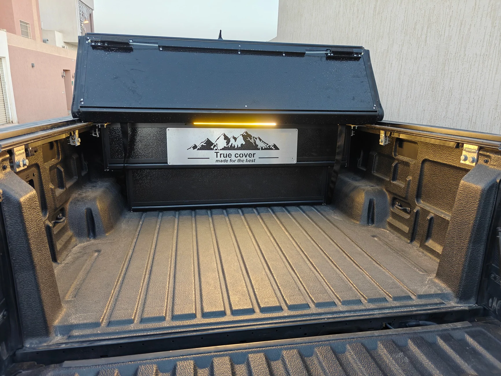

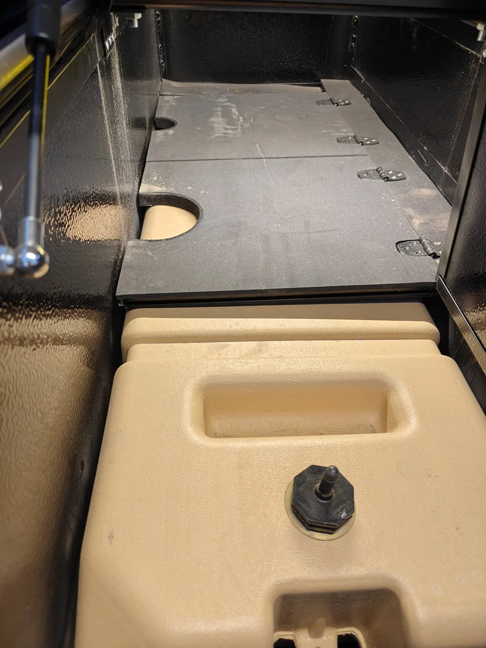

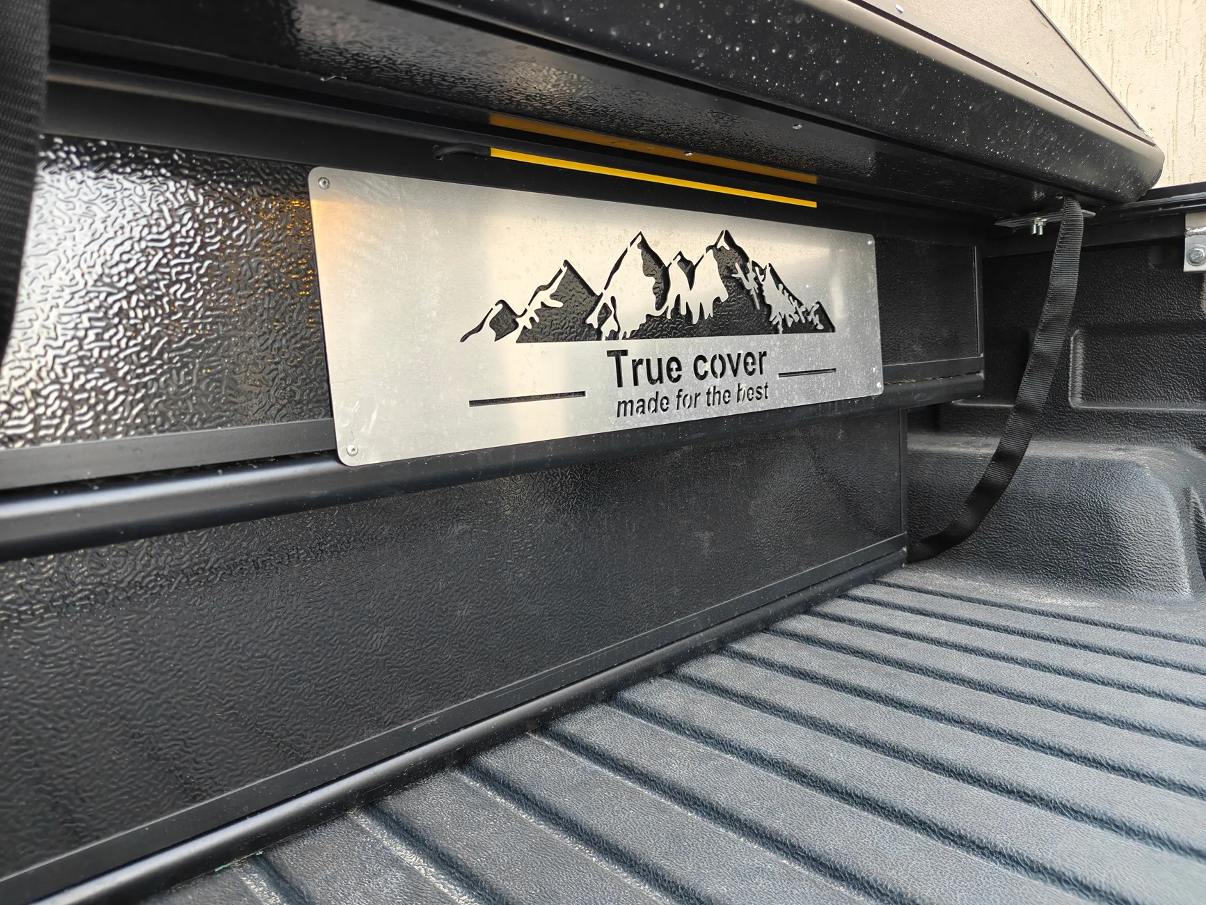

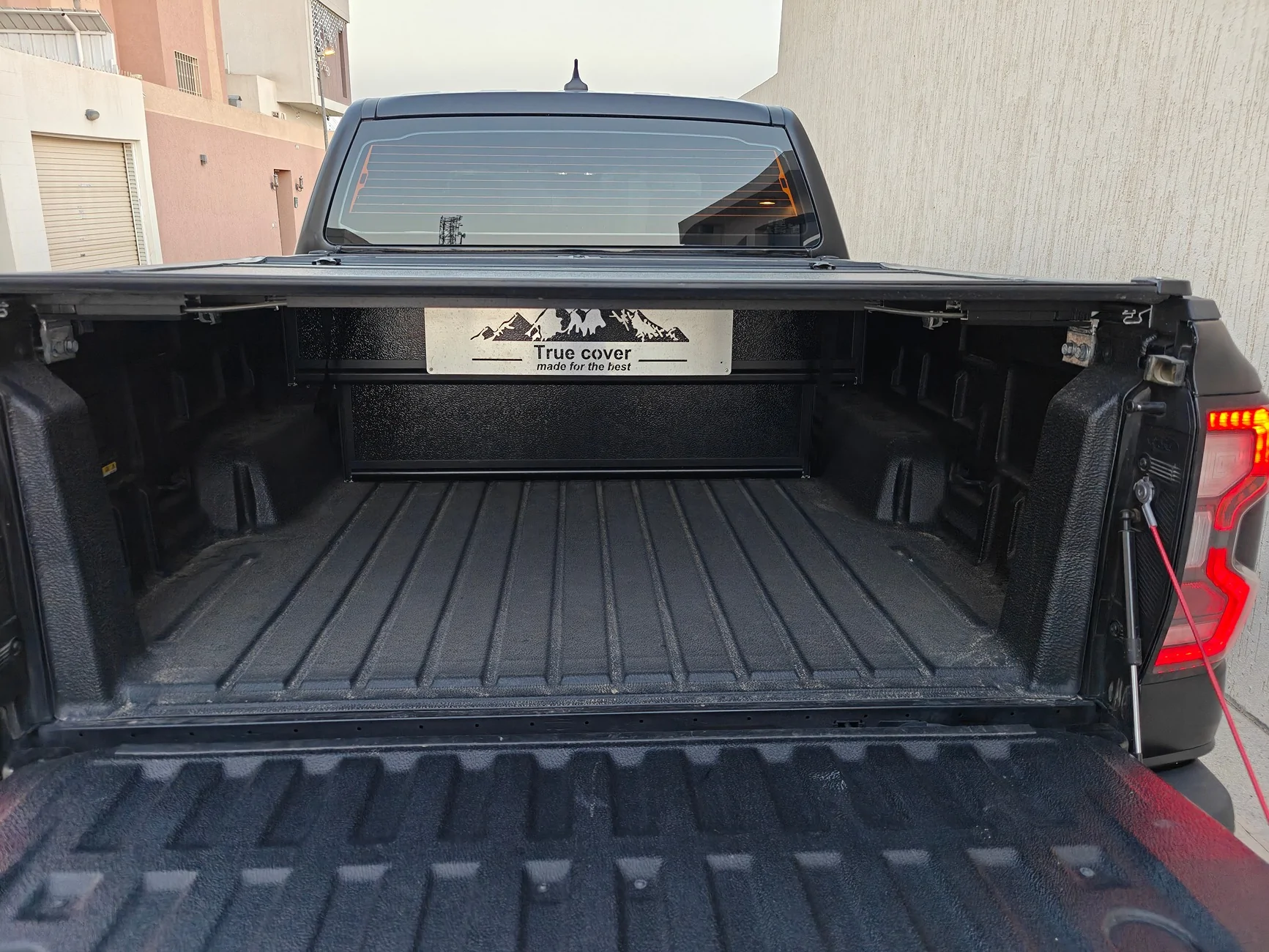

i wanted tri-fold cover, but i also wanted to add water tank (70L), along with a lockable storage compartment. the garage was helpful, i added some lights in bed, straight to battery instead of aux.
the separator between the water tank and storge is good for a lot of my stuff (air compressor, tools, recovery..etc) it has been installed for over 5 months now, i would say there is minimal dust and water goes into bed, but acceptable, i could add some weather strips.
here are some pics, happy with the results
