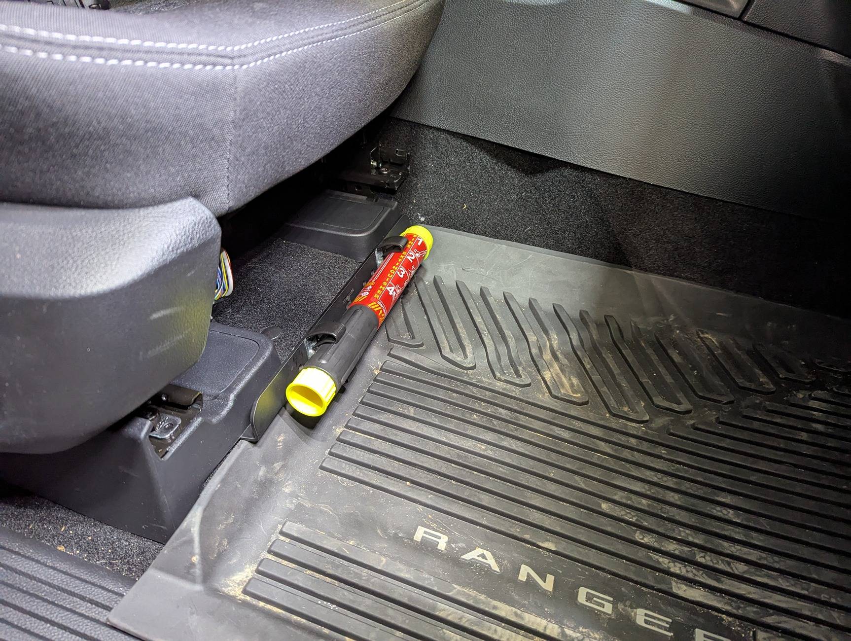

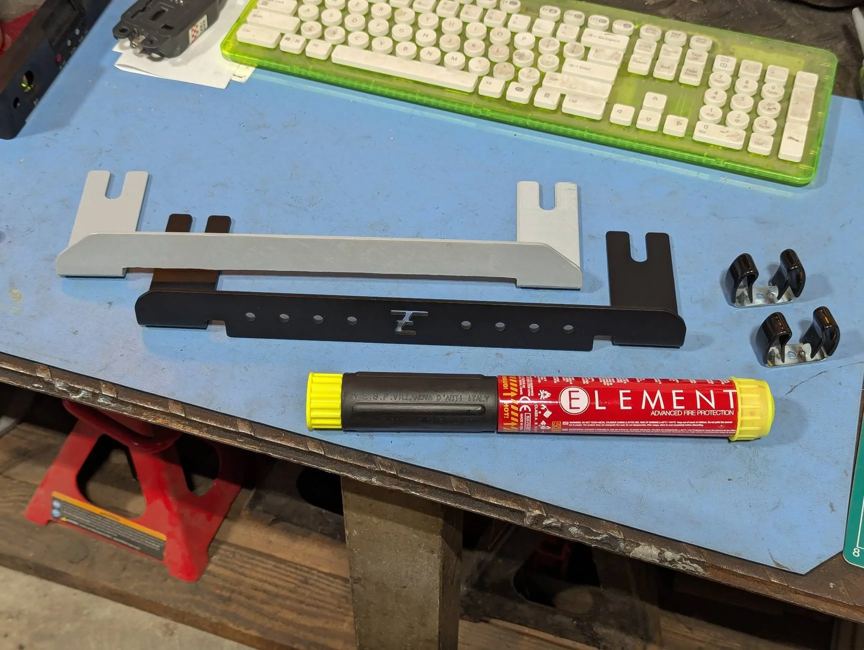

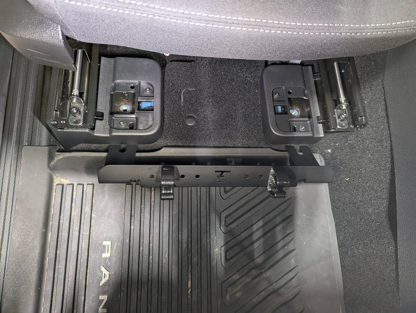

Since I'm towing my track car with my '24 and plan to do some camping/overlanding with it in the future I really wanted a good secure way to mount a fire extinguisher in the cab. Most of the mounts I was finding were from Australian companies which put them on the driver's side of my NA truck which I didn't want. Taking some inspiration from their designs and some measurements from my truck I modeled up and printed a few prototypes before having one laser cut, bent, and powder coated.
The end result came out pretty slick and nice and low profile
Ford Ranger Custom fire extinguisher mount PXL_20250402_004756676
Ford Ranger Custom fire extinguisher mount PXL_20250402_003557180
Ford Ranger Custom fire extinguisher mount PXL_20250402_002309922
Where I currently have the clips for Element E50 is unfortunately limiting the forward travel of the seat a bit because of an electrical connector under the seat. I may move the clips to other holes and see if I can clear the connector entirely, but I'm honestly not too worried because I can't think of a reason I'd have the seat a max-forward position.
