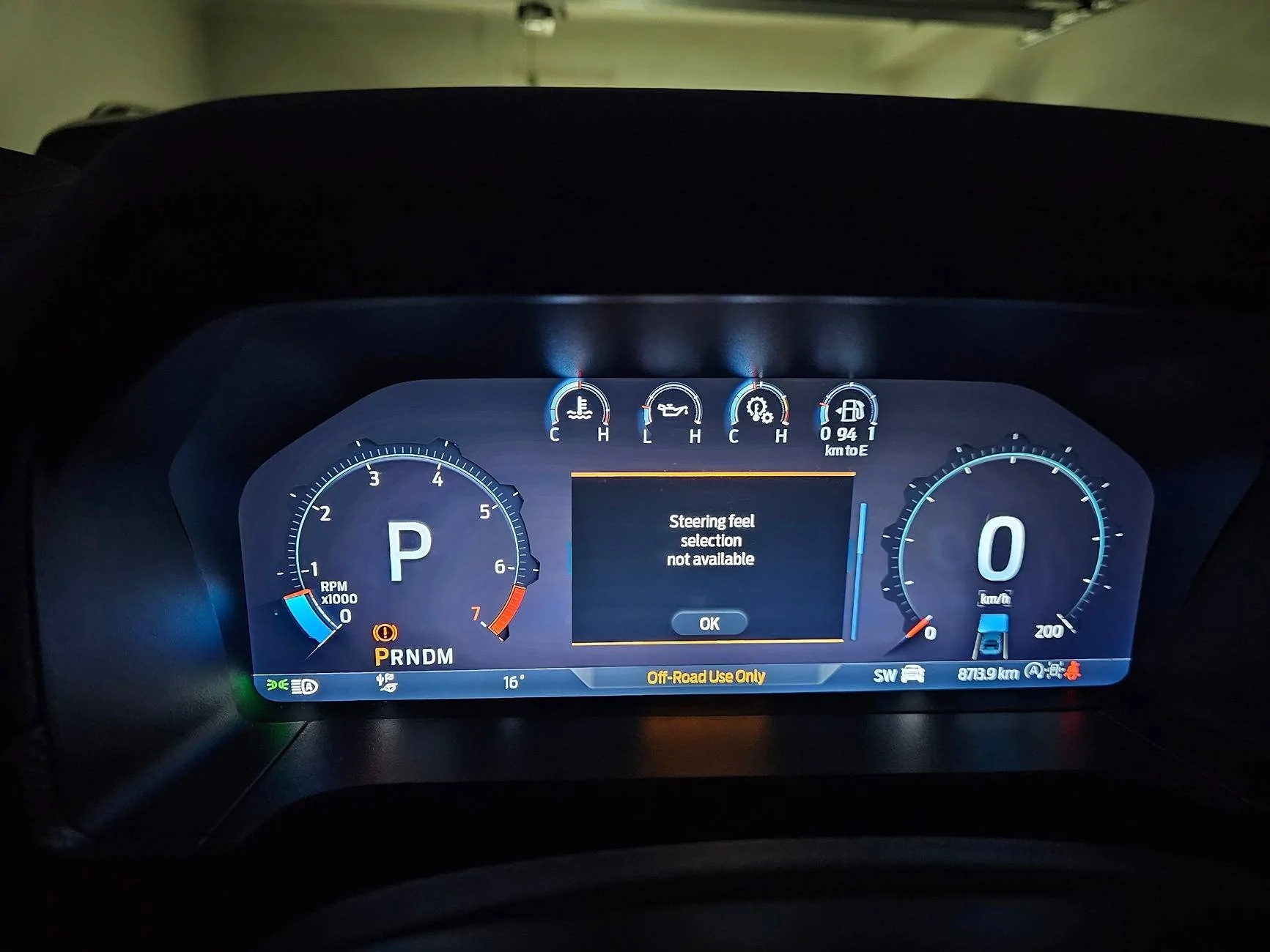

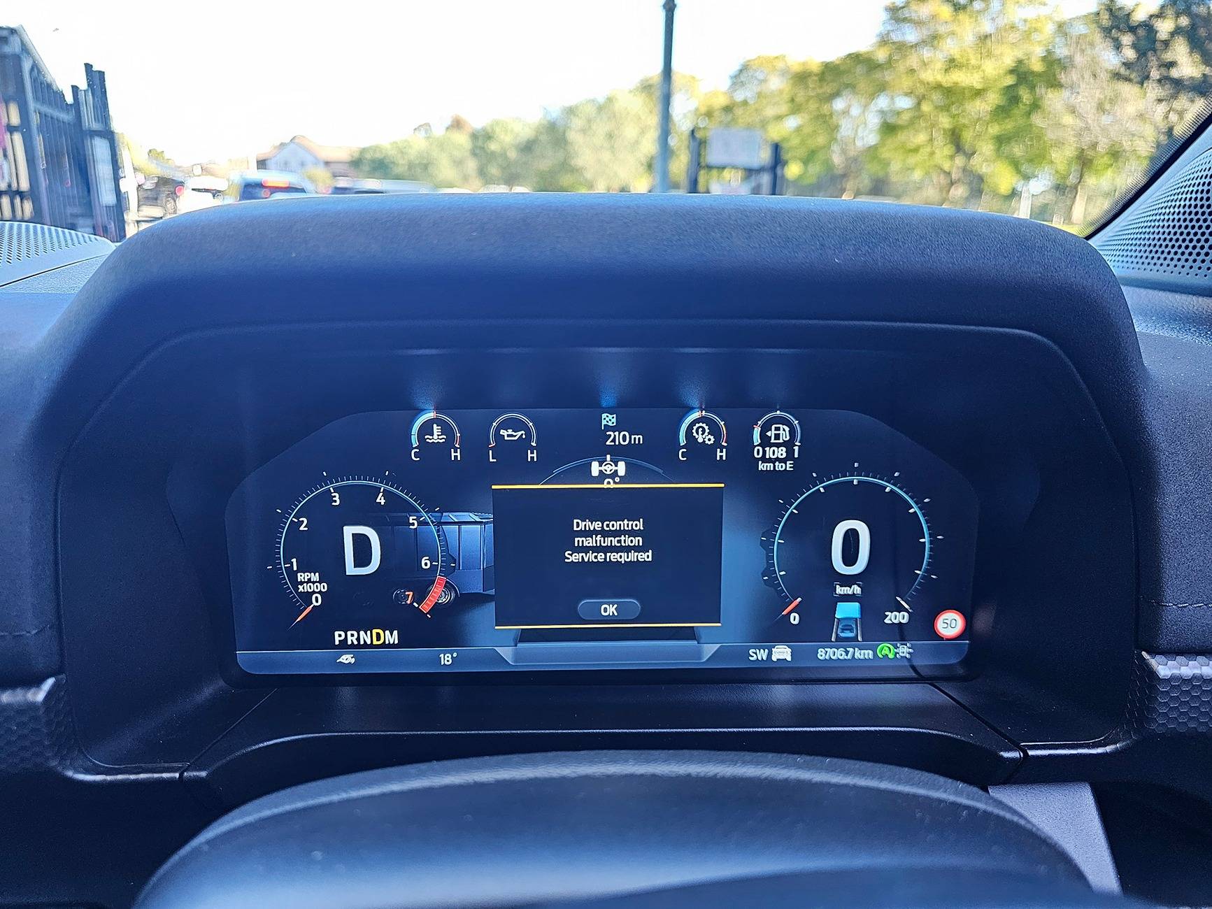

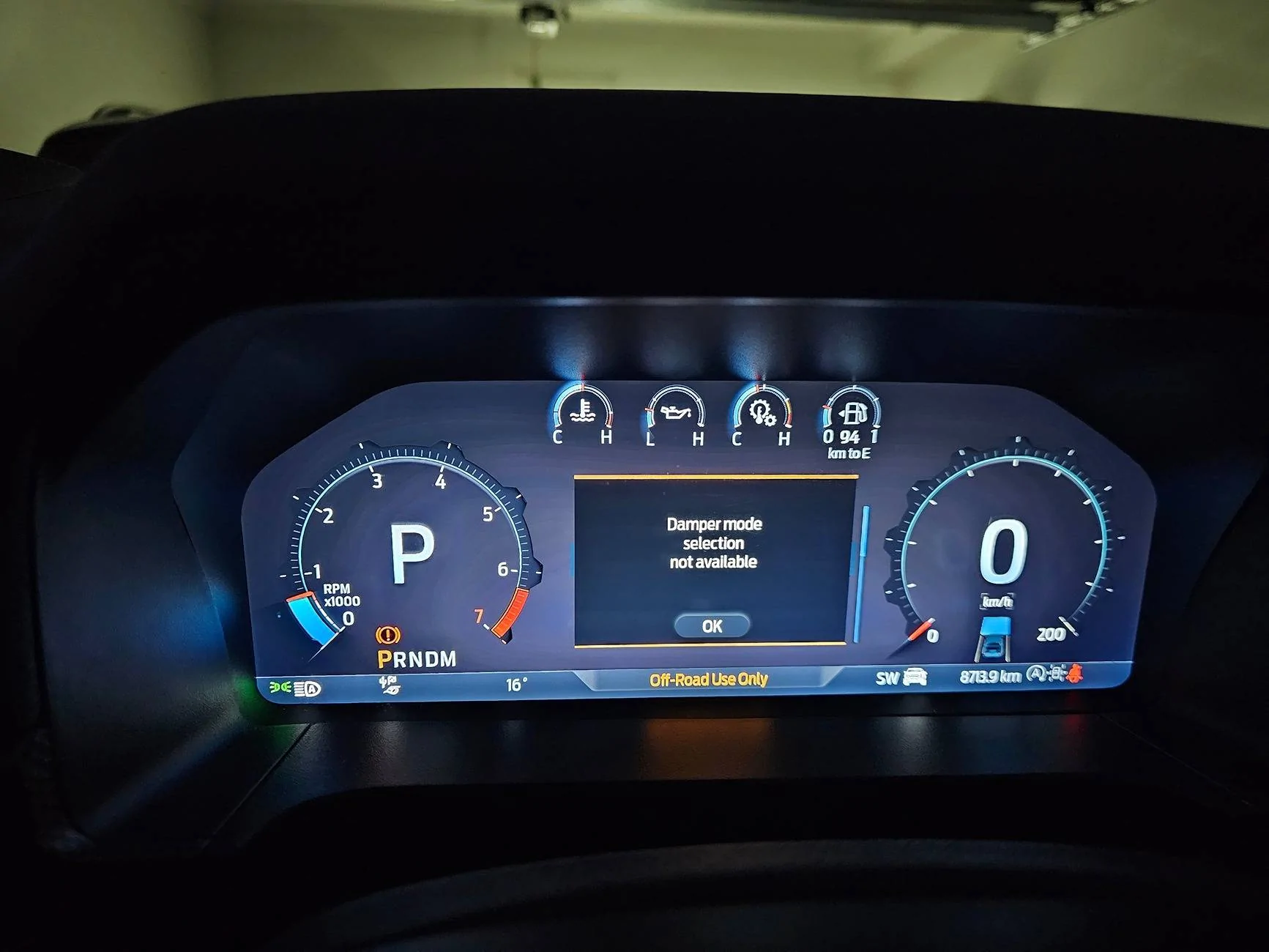

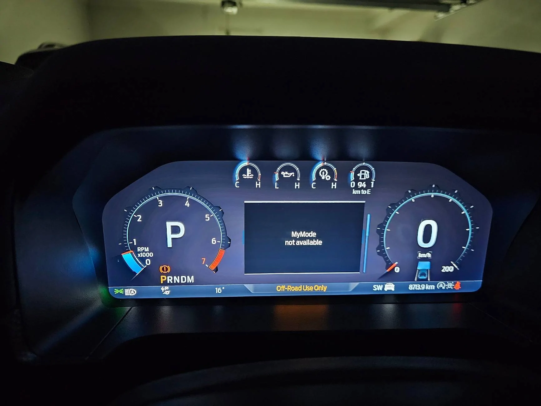

Good day People,
Has anyone experienced "Drive Control Malfunction" error before on their Ranger Raptor 2022+
Any idea what's going on?
Any advice what to do?
Thanks in Advance!
Ford Ranger Drive Control Malfunction 20240628_171944
Ford Ranger Drive Control Malfunction 20240628_171948
Ford Ranger Drive Control Malfunction 20240628_142854
Ford Ranger Drive Control Malfunction 20240628_171951

Yes
Mine had the same issue .
It was pin 9 connection on the ecu on mine
Replaced pin and bravo .
Has stuck in my mind as it has been the only fault / issue to date .

Thanks mate, Glad to hear. This error is super annoying.
Can you help me to locate Pin9 in the ECU? Any photos?

Sorry mate no pics local ford repaired it under warranty.
took 3 visits and a lot of perseverance with a load of red herrings but they got there.

Yep " My Mode not available", happened once and no issues since, just waiting. I didn't know this might be a thing.
