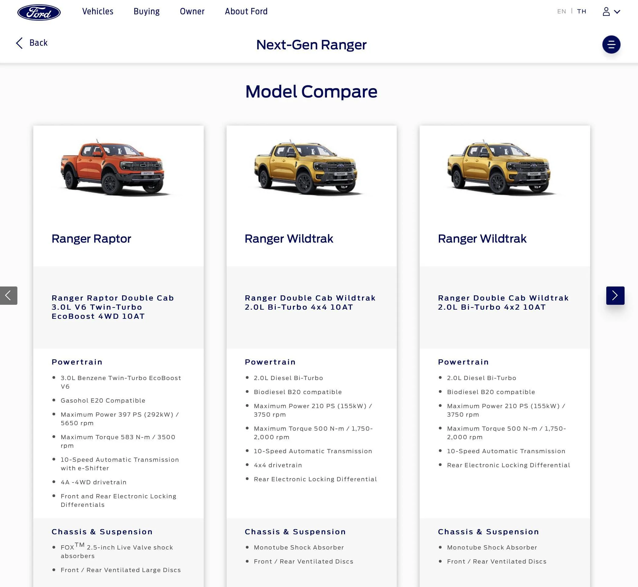

I'm in Thailand and was a bit gutted to learn we will not get the Ranger in Diesel V6TT full-time 4WD form (not actually sure if that variant will even be made here, or only SA?). It is what it is so I must accept it (lucky we still get the Raptor in V6), but it got me thinking. As far as I can tell:
* The outgoing model of the Everest here has (permanent) full-time 4WD with the 2.0D TT and the 10R80
* The Thai Ranger Raptor is full-time 4WD with the 3.0V6 Petrol TT and the 10R80 (not the same 4WD system as the Everest?)
* The Thai Wildtrak in part-time 4WD form has the 2.0D TT and the 10R80 (which has the same control as the Raptor minus the 'A' option for full-time 4WD)
So, if some Ranger (Ranger-based) vehicles have the 2.0 Diesel TT and the 10R80 gearbox with full-time 4WD, what would be involved in converting the new Thai Ranger Wildtrak from part-time to full-time 4WD (which has the 2.0TT and the 10R80), i.e. have the 'A' option on the drive selector (which is currently missing)? In my dreams it would just be some type of 'clutchy thing' in the gearbox like the Tritons have? and possibly another ECU and/or minor work on the loom? This is a less-than-ideal idea for a new vehicle I know, but just want to better understand the mechanical differences to try to gauge my chances.
I would appreciate any input from those in the know (even if it is bringing me back to reality). The alternative would be a Triton (hence my attempt with this thread) as it is the only pickup over here with my much desired full-time 4WD option.... which I love here especially as it is a flat country with lots of rain, surprises on the road, and exciting drivers.
The basic specs from Ford Thailand are included below:
Ford Ranger Full-time 4WD Ranger: Possible or dreaming? Screen Shot 2022-04-24 at 01.22.05

Hi Tim,
The Ranger's AWD T-Case is different to the outgoing Everest's, the Everest was permanent AWD with low range, but no actual lock (i.e. it did unlocked AWD high and AWD low). The new Ranger (in some configs) borrows the Bronco's T-Case, which can do 2WD high, AWD high, locked 4WD high and locked 4WD low. In Australia the Ranger with the 2.0TTD is only coming with the standard 2H, 4H, 4L same as the outgoing car, only the V6TD and V6TT Ecoboost are getting the permanent 4x4 T-Case (which isn't permanent as it can do 2WD). FYI the Ecoboost gets the 10R60 transmission.
As for manufacturing, Thailand will be building V6TD vehicles, as Thailand supplies Ranger and Everest to Australia.

Thank you very much for the excellent reply Bill - just what I was after!
Unfortunately it looks to be a no-go, so glad to have been brought back to reality. Also sad to hear the V6TD will be made but not sold here - to get a similar V6TD full-time 4WD drivetrain you are spending 3-4 times Wildtrak money for something in the X5 class (Apples and Oranges I know).
Anyway, I'm sure Ford Thailand will miss the one V6TD sale they would have made haha - who knows, maybe in a few years it will be released. I can't for the life of me think of why it would not be sold here given it would be less than the Raptor and 10x more practical for Thailand IMHO....but I expect there are reasons.

Unfortunately I think it'll be way too hard, the mechanical side would be the easy bit. It's the PCM side that'll be difficult.
