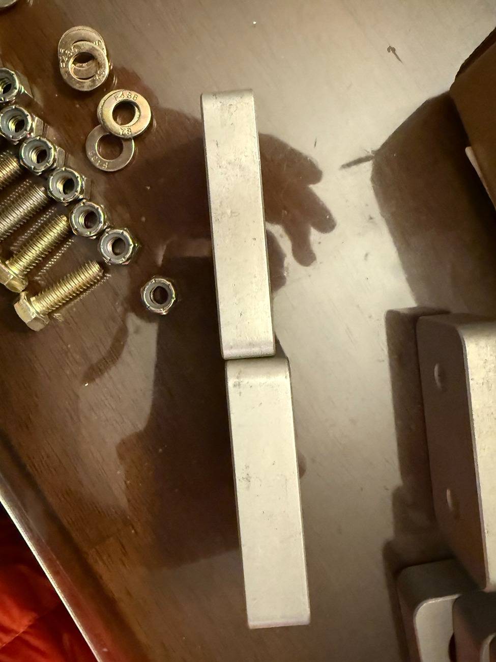

I'm very curious about how they overcame the limitations of the bed rails. Do you have any photos of the aluminum pucks for the stake pockets in the bed rails? I've seen some other companies completely remove the plastic trim.

have some photos of before install
Looks like i got different grade of bolt; i'll have to keep an eye on them...
