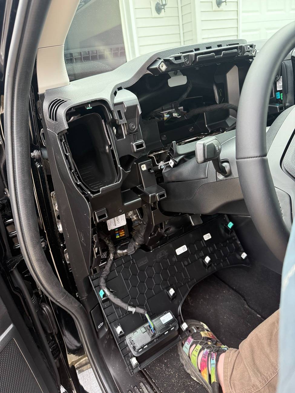

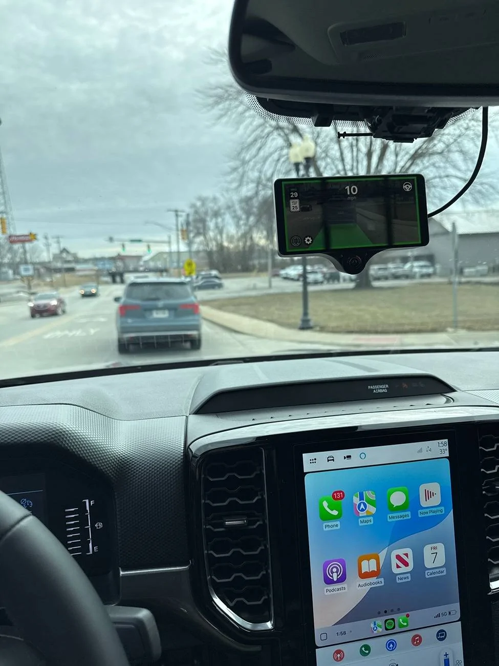

Happy to report that openpilot works on the 2024 Ranger for hands of wheel driving goodness. You need a truck with adaptive cruise control and that's it.
^ not my video
Install is moderate, have to plug in behind gauge cluster (video: )
It works well enough, some software/tuning is still needed and comma seems to be buying a F150 to get it dialed in fully. Ford is the only company who has road curvature, etc CAN bus signals expected to the PSCM so it isn't as easy as just sending EPS torque commands like all other models (Ford is built from ground up for autonomy).
I'm really loving Ford's Adaptive Cruise, the automatic speed limit is A++ and it works better than Chrysler, Toyota's systems.
Been contributing to openpilot since 2019 and it's so cool to have a truck now with it, should make those long haul camping trips that much more fun. Only a matter of time until Ranger gets TRON (CAN bus encryption, booo).

Compatibility with this is one of the reasons I went with my 24 ranger raptor.
Took it on an 8,500 mile road trip from the east coast through colorado, utah and wyoming last September. We drive stragiht from new england to colorado in about 30 hours taking shifts and open pilot is the only way it's possible. This way we have more time in the mountains. Did this towing a home made 2,000 lbs fully loaded camp trailer.
Previously did this with our subaru. The ranger (and raptor in particular) opens up a lot of exploration. Did the alpine loop in the San Juans and a bunch of the 4x4 roads in Arches, Shafer Canyon Road in Canyonlands / Moab, Hurrah pass, etc.
Highly recommend open pilot, and works well with the ranger raptor thanks to efforts of those working on blue pilot. It's not even comparable to the stock lane keep. I use the stock ACC and don't mess at all with traffit lights / stop signs for now.
For ford, blue pilot is a must.

https://comma.ai/shop/comma-3x?make=Ford&model=Ranger%202024
You need a Comma 3x, with a Ford Q4 harness. They have it labeled as "ranger harness" to make it easier to find. The Comma 3x should come with an 8 degree mount when ordered with a Q4 harness. Ranger windshield requires the 8 degree mount.
You need to purchase a USBC extension cable. I used this one. 6.6 ft. https://www.amazon.com/dp/B09FDWG61C?ref_=ppx_hzsearch_conn_dt_b_fed_asin_title_3
It doesn't hook up in the mirror box. You need to run the extension from the mirror box down to behind your guage cluster. You install the harness there. There is another wire that goes down to the ODBC port. You can opt to not have the ODBC port I think, but you'll get dash warnings on boot up as the device wont be powered until the car starts up. ODBC provides constant power.
Older cars needed the ODBC to read the fingerprint of the car. Ford passes this via the canbus I IIRC.
