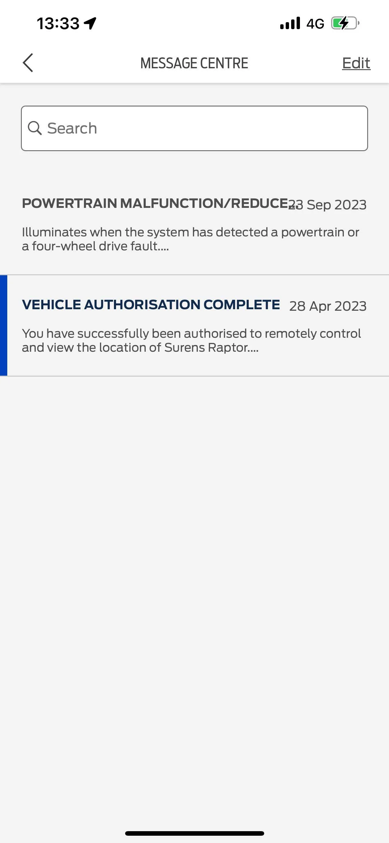

Just came across this post because I was searching the forum to see if any one else has had a powertrain problem.
My 2023 Ranger Raptor is saying the same thing on my FordPass App; "Powertrain Malfunction/Reduced Power" and says the system has detected a powertrain or four wheel drive fault (see the photo from my FordPass App) and that I should contact my authorised dealer as soon as possible.
I normally drive it in the "2WD" mode. However, there is a very noticeable reduction in power when I drive it in the "4A" setting.
I hope my fix is going to be as easy. I will (or, get the dealer to)check out the connector on the wiring harness under the drivers side panel.
I wonder if any anyone else has had the same problem.
