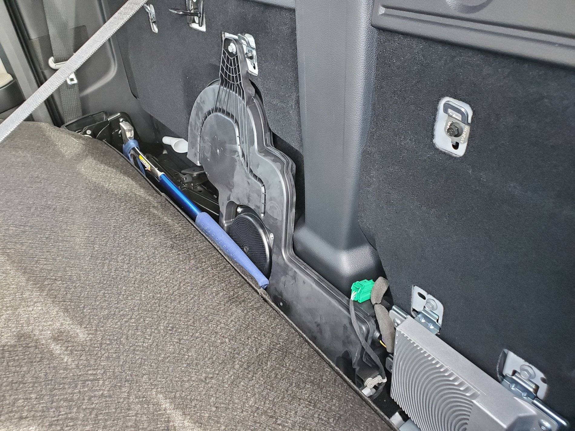

I have taken rough measurements on the sub area and it's really tight back there. Most "truck" subwoofer enclosures will not fit there, including the relatively small Alpine SBT-10SV, SBR-S8, and others. Looks like the maximum total depth may not be bigger than 6 inches near the bottom. I'm on the fence between making my own enclosure or working on something off the shelf. I'm a lot lazier than I used to be but audio is still a fun hobby!
-- From a WAG on some measurements, the 10" JL TW1 based CS110LG-TW-2 might squeeze in with trimming
-- Pioneer UDSW250T (~3" mounting depth) & UDSW250D (~4" mounting depth) enclosures might squeeze in with trimming, use sub of choice

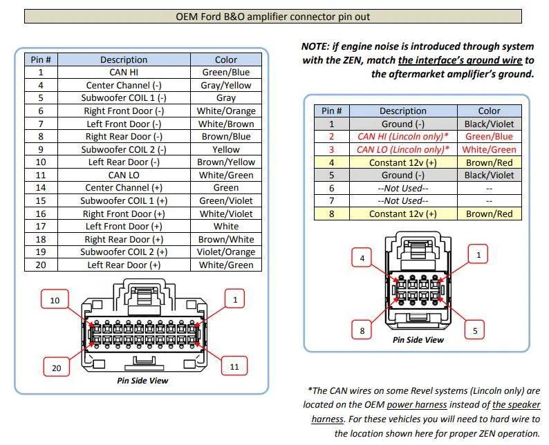

Here are B&O schematics from the F-150 that someone posted. Page 3 seems to confirm the dedicated wiring to the front A-pillar tweeters. This means that one should be able to run components in the front and put the passive crossovers in the back by the replaced amp, or use active filters on a replacement amp.
Again, I have not personally verified it on the Ranger yet.

The green plug is the high level sub signal from the B&O amp. The OE ported sub is a convoluted structure because they were trying to make it as big but efficient in space as possible, so it fits the nooks and crannies back there like a glove.

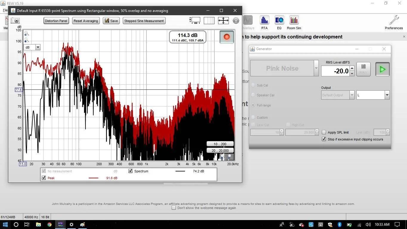

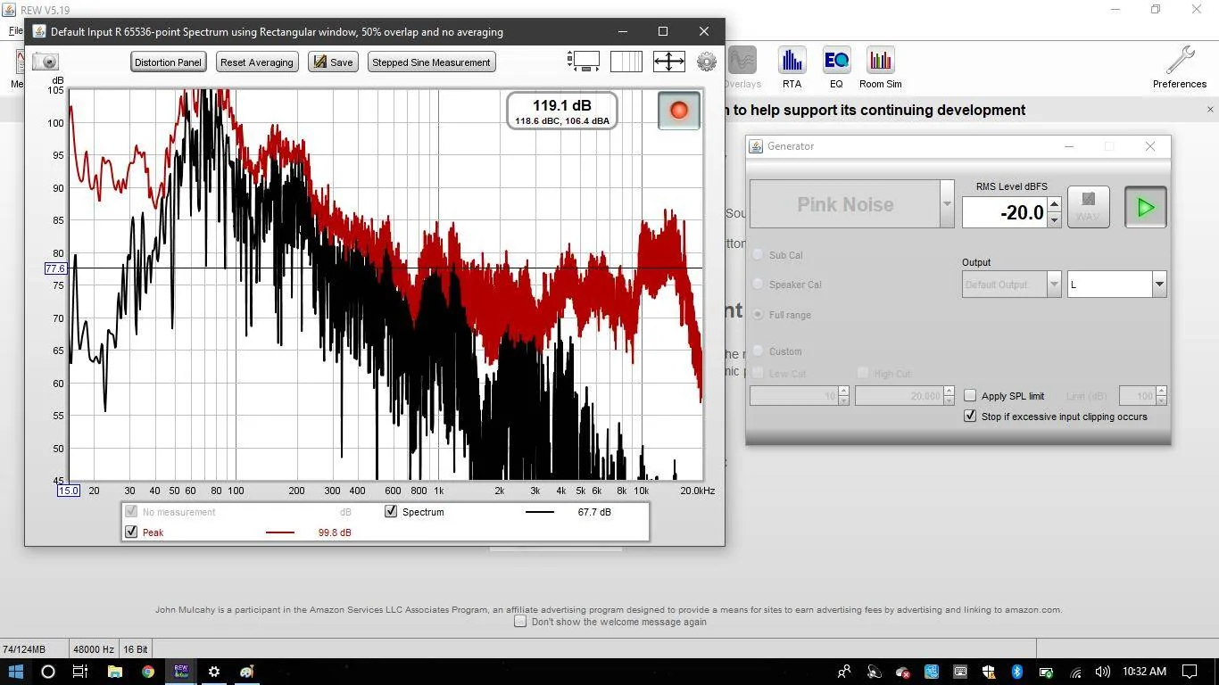

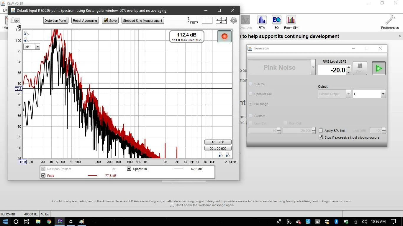

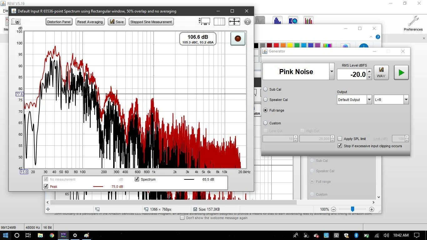

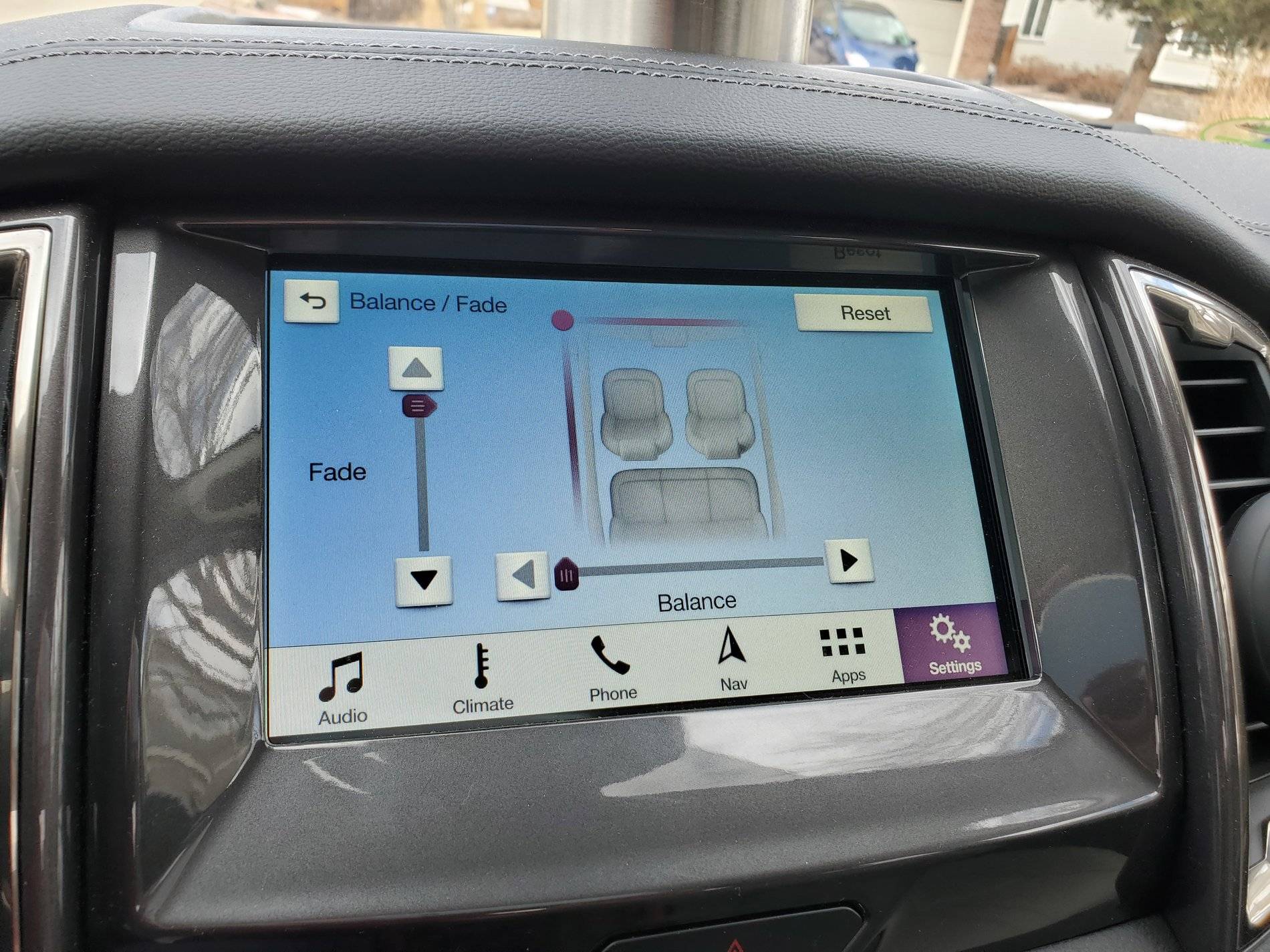

I just did some quick and dirty RTA measurements of the completely stock 2019 Ranger B&O sound system with an old laptop, REW, and a miniDSP UMIK-1 microphone. I was able to connect to bluetooth to do the measurements via the laptop, I was worried for a minute when I got out there and remembered there is no aux in.
All measurements are with the doors closed and no bass/mid/treble on the Sync3, I wanted to see how they tuned for cabin gain. I don't think these measurements are truthful in the kHz range, but the near-field on the tweeter and woofer should be an idea of the filtering they are getting. Nearfiled at the sub is with the seat folded back up to be in as normal of a state as possible.
Given that this is B&O EQ plus cabin gain, there's not a good way of separating the responses. I did the measurements with the driver's front only, and then one with the full system playing to get an idea of the total bass response. One can generalize that the door speakers boom at 70 Hz, the sub booms at 50 Hz, and that there's not an impressive blend between the two.
Filtering on the woofer/tweeter looks like the very common range of 2-3 kHz. If we take more measurements to get the B&O speaker sensitivities nailed down, one could fairly easily drop-in a tweeter or woofer upgrade and still keep the B&O system in balance.
The system bass is somewhat level below 100 Hz, but the dip between the door's and sub's responses I think is due to either's inherent peakiness. Bass drops like a ruck below 30 Hz. These measurements are also at low volume level, subjectively I can say for sure the low bass goes away once the knob gets turned up loud.
