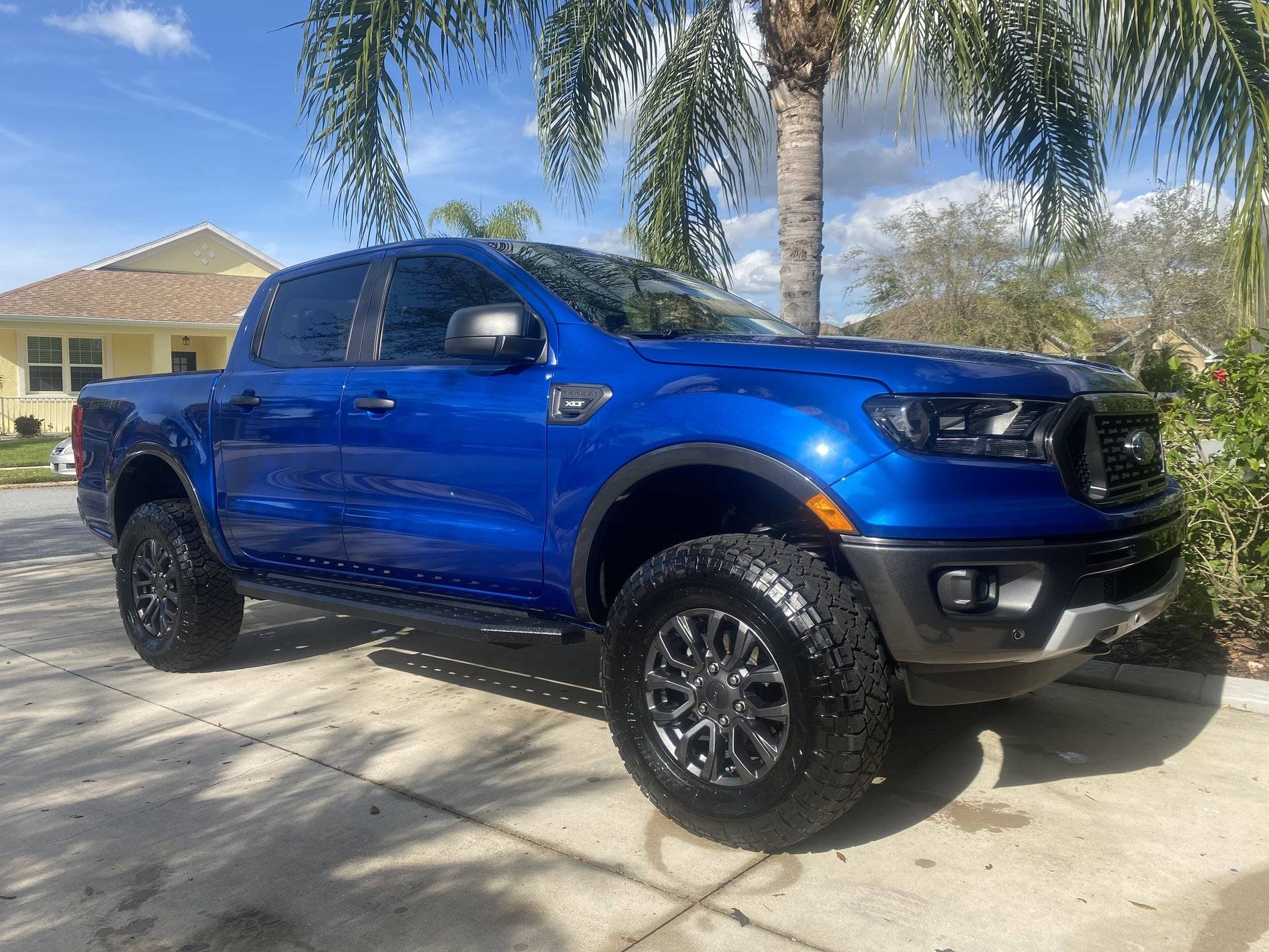

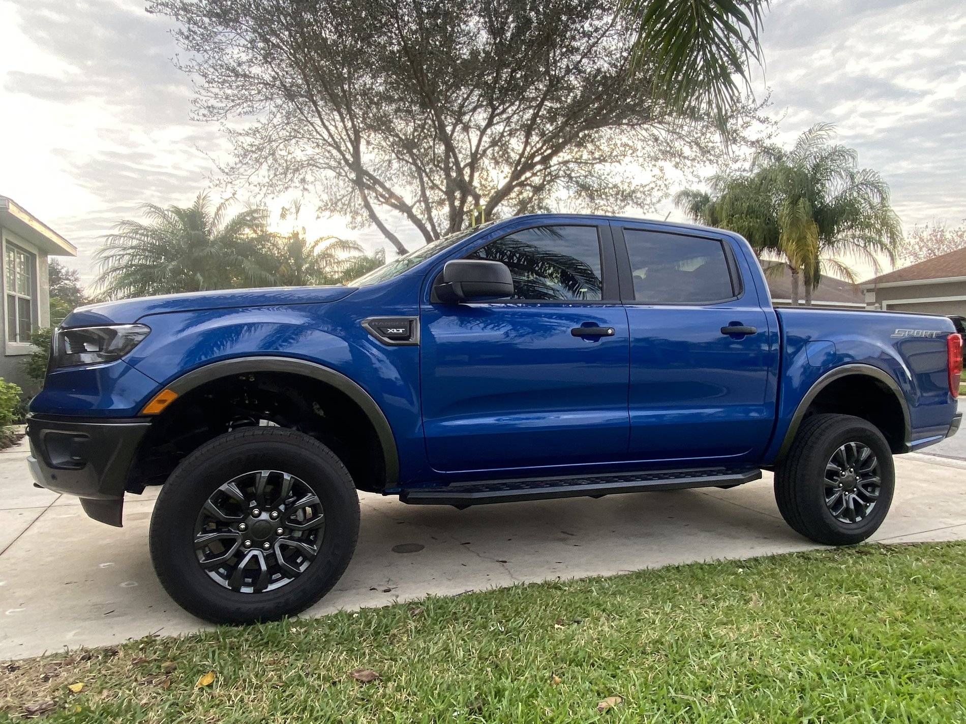

As of today
2019 xlt 301A
285/70R17 nitto ridge grapplers(P rated 116Q, I don’t off-road and they weigh a lot less that the LT)
Stock 17” sport wheels
Eibach 3” front(with springs)
Eibach 1” rear blocks
1” bora wheel spacers
Crash bars adjusted full forward, no cutting so far.
Go Rhino RB20’s sprayed with linex premium (installed as directed, some folks like them backwards to give the larger tapered end in the back)
Bed sprayed with line-x premium
Tail gate assist
Tail gate inlays
auto folding mirror mod

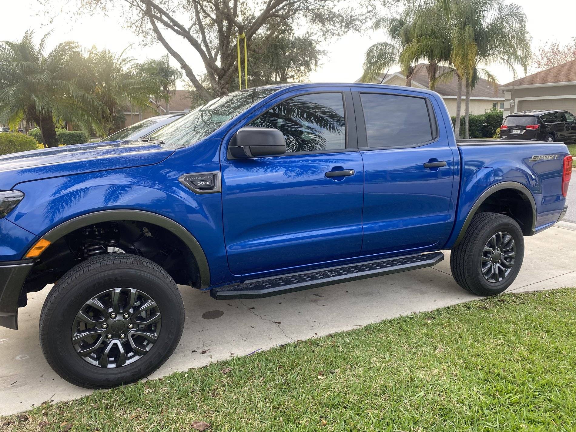

The day I bought it.

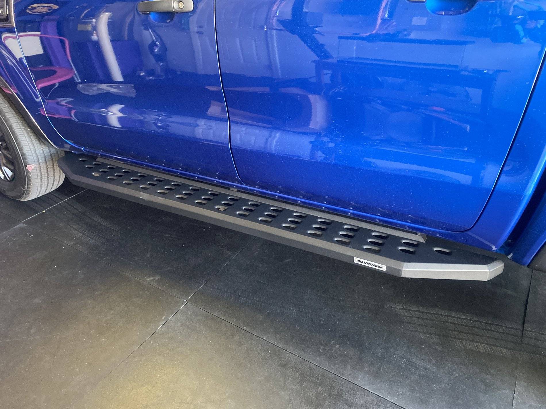

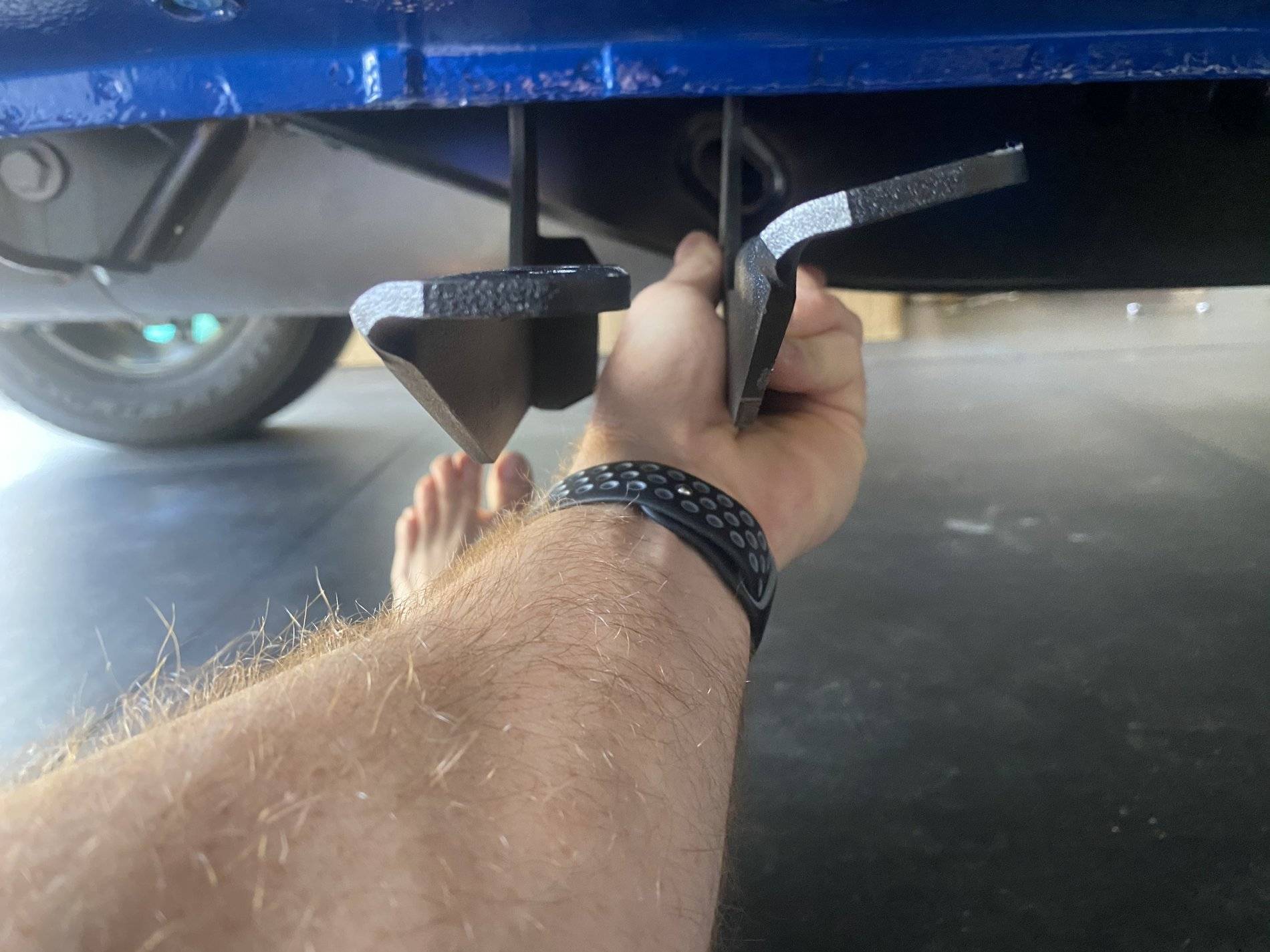

The RB20 install hit a snag. One of the supports wasn’t really close to 90 degree. They were quick to resolve the issue but I drove around with one step on for about a week.

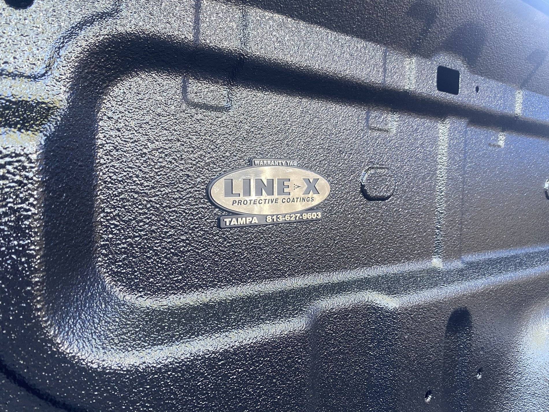

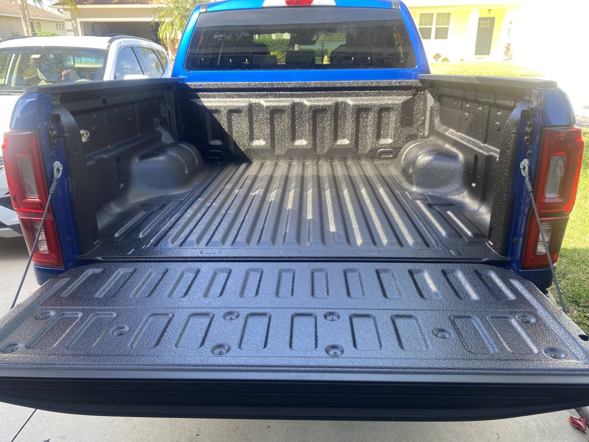

Next upgrade was the line-x shop. Had the bed sprayed with premium and the boards sprayed as well. They removed the GoRhino silver tags on the boards and it looks much better.

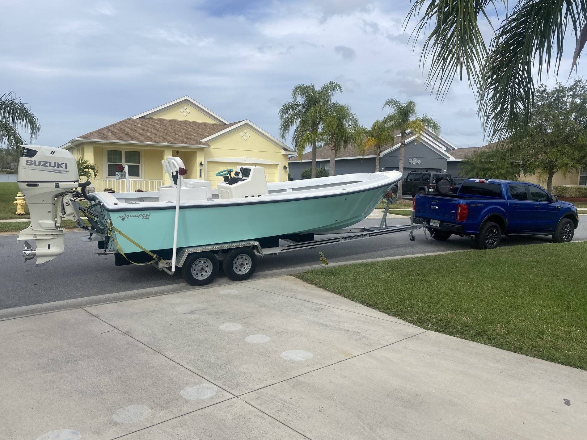

First tow with the truck. Boat weighs about 4000 pounds. Towed great I just need to get a drop hitch to level the trailer out.

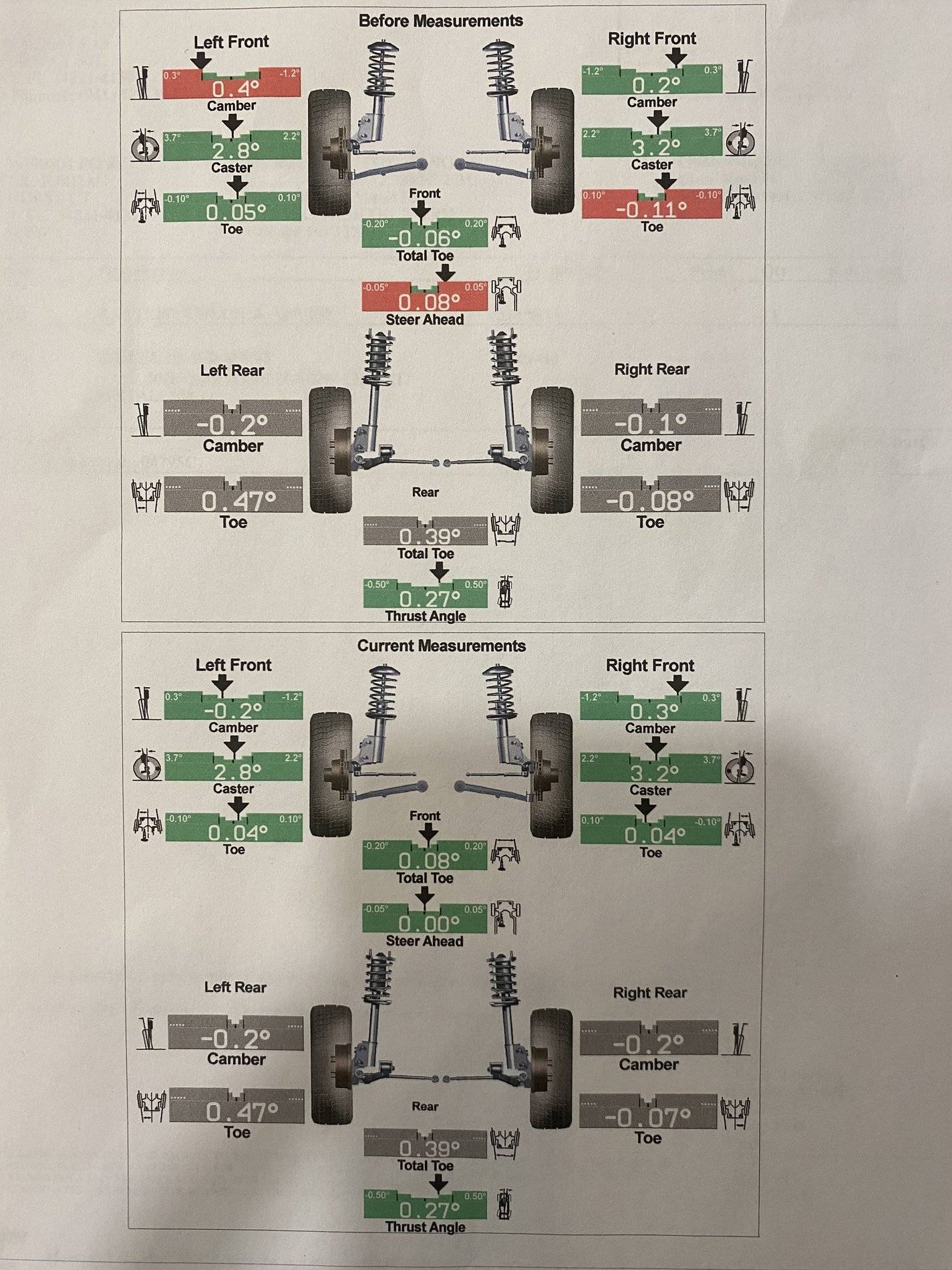

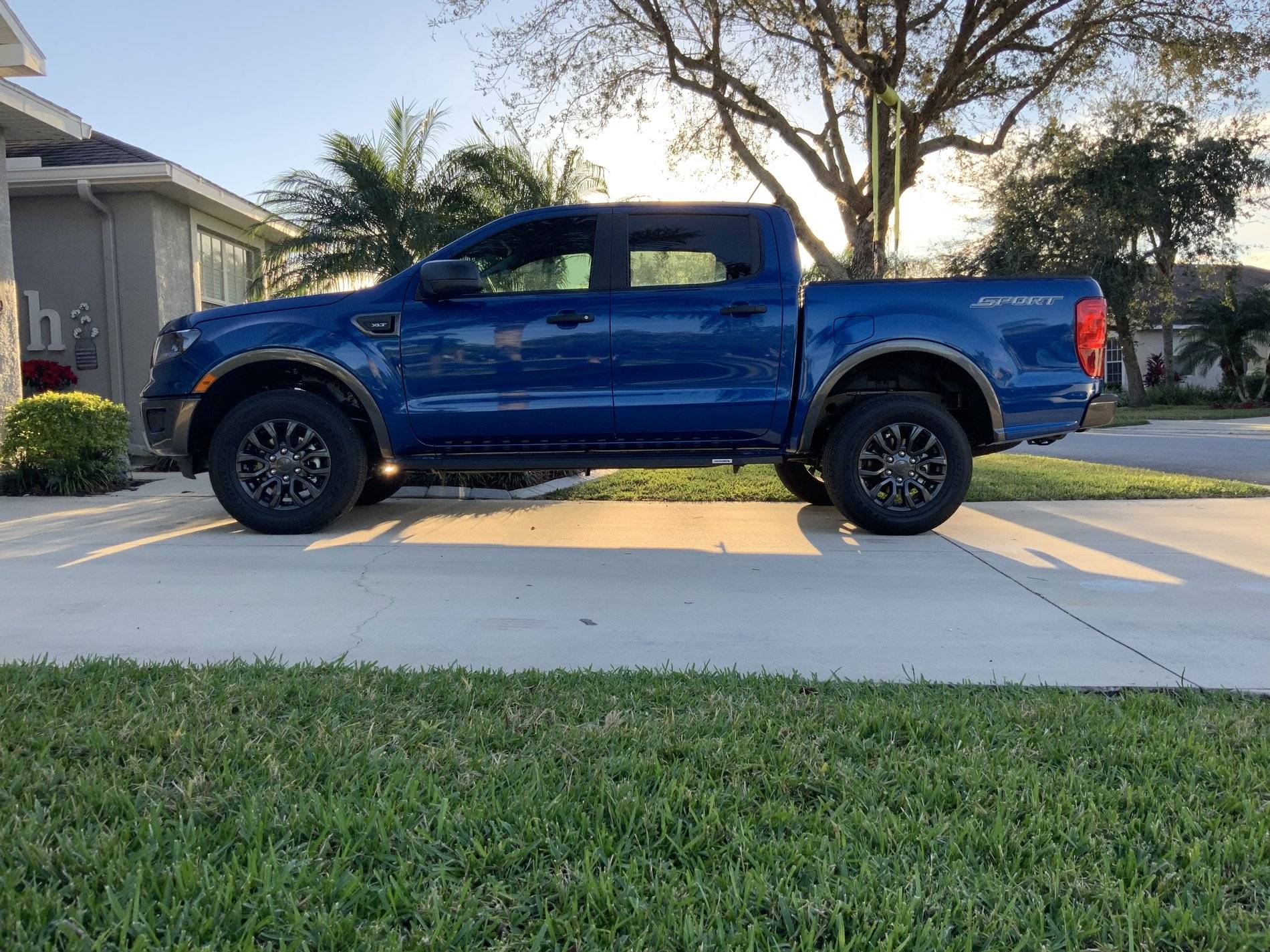

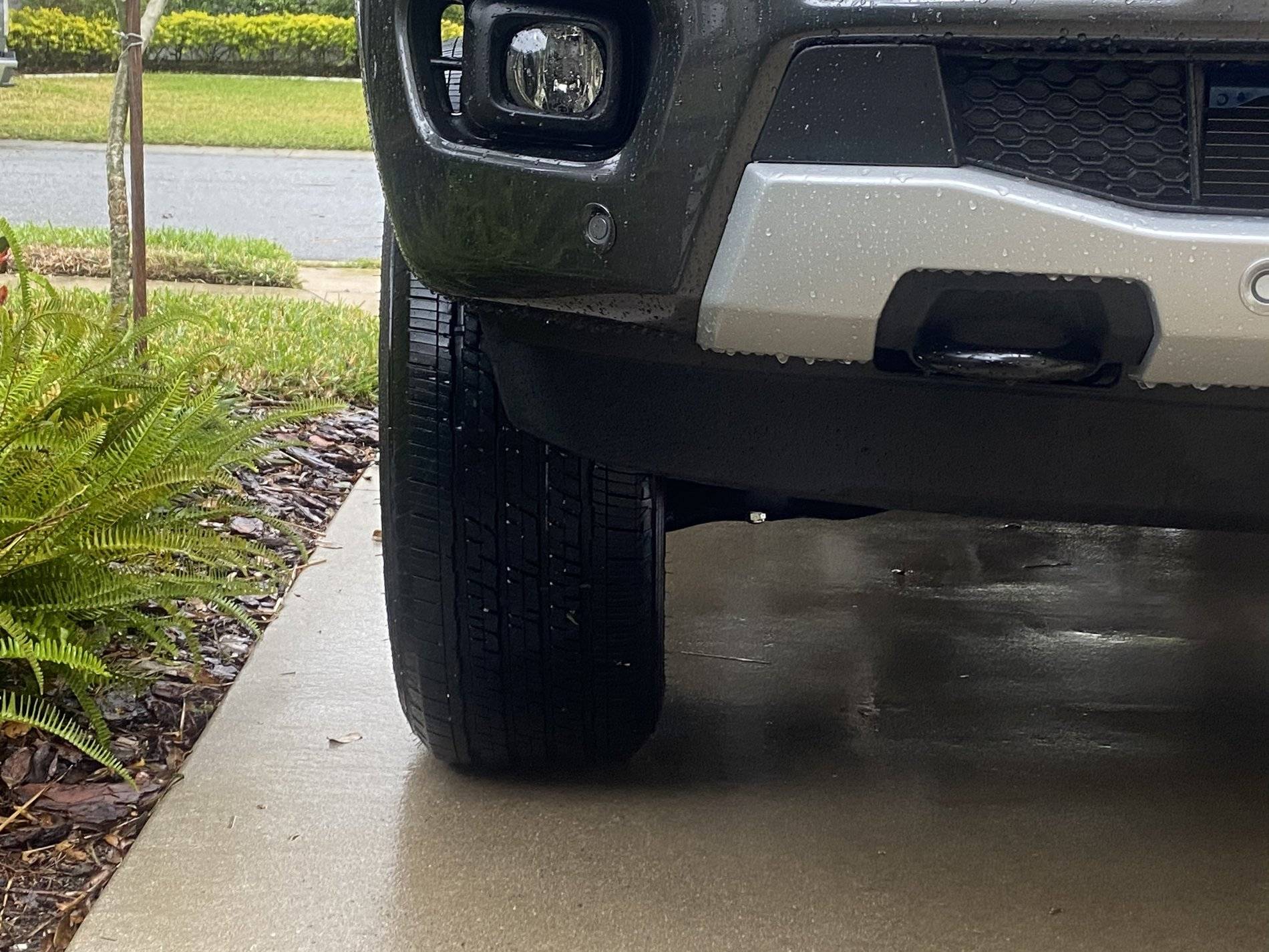

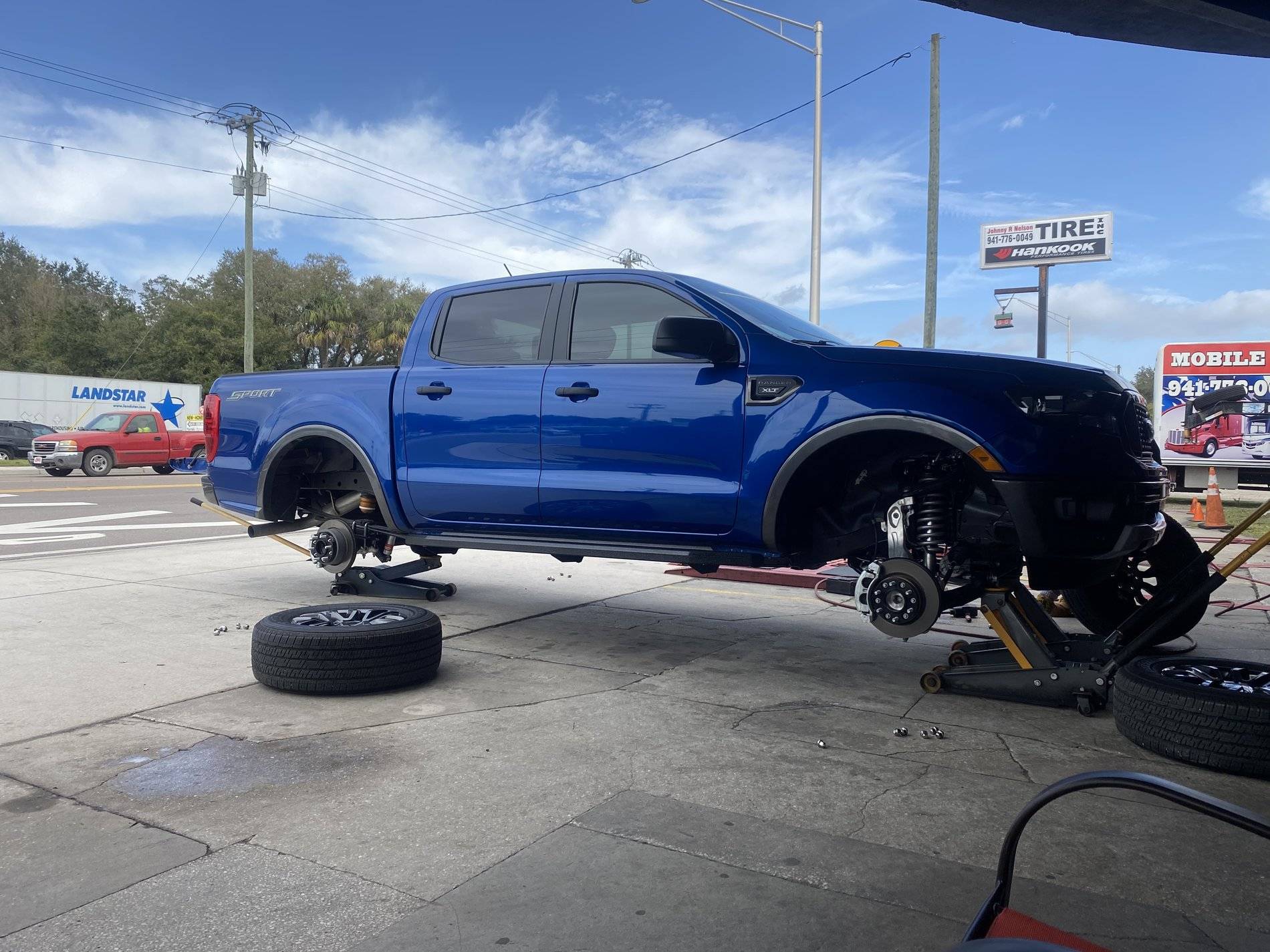

The Eibach Upgrade was next.

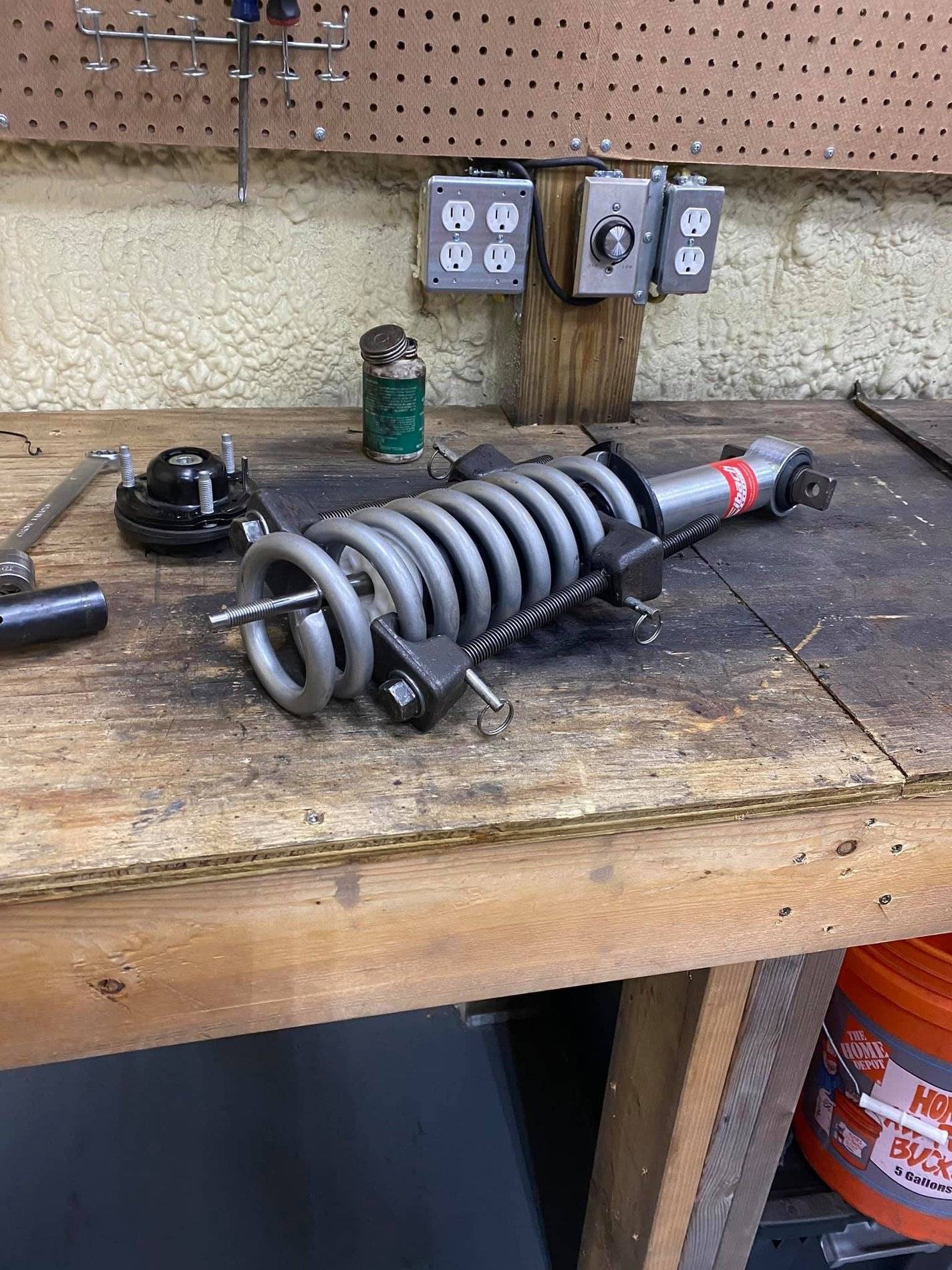

Full 3” in the front and 1” in the back. After we did the fronts we dropped the truck back down to take a look at it. It was nearly perfectly level but I do tow occasionally so we put the 1” in the back.
There was a few sketchy moments with the spring compressor. The new spring is way longer than stock! We also forgot to loosen the sway bar and the control arms popped off and had to be reset. The little spring clips set us back an hour. Otherwise it took about 3 hours including the rear 1” blocks.
The eibach ride is greatly improved. It lost the bounce in the rear end and the truck feels “planted”.

We also installed the 1” bora spacers to get ready for the new tires.

Alignment post eibach came back fine.

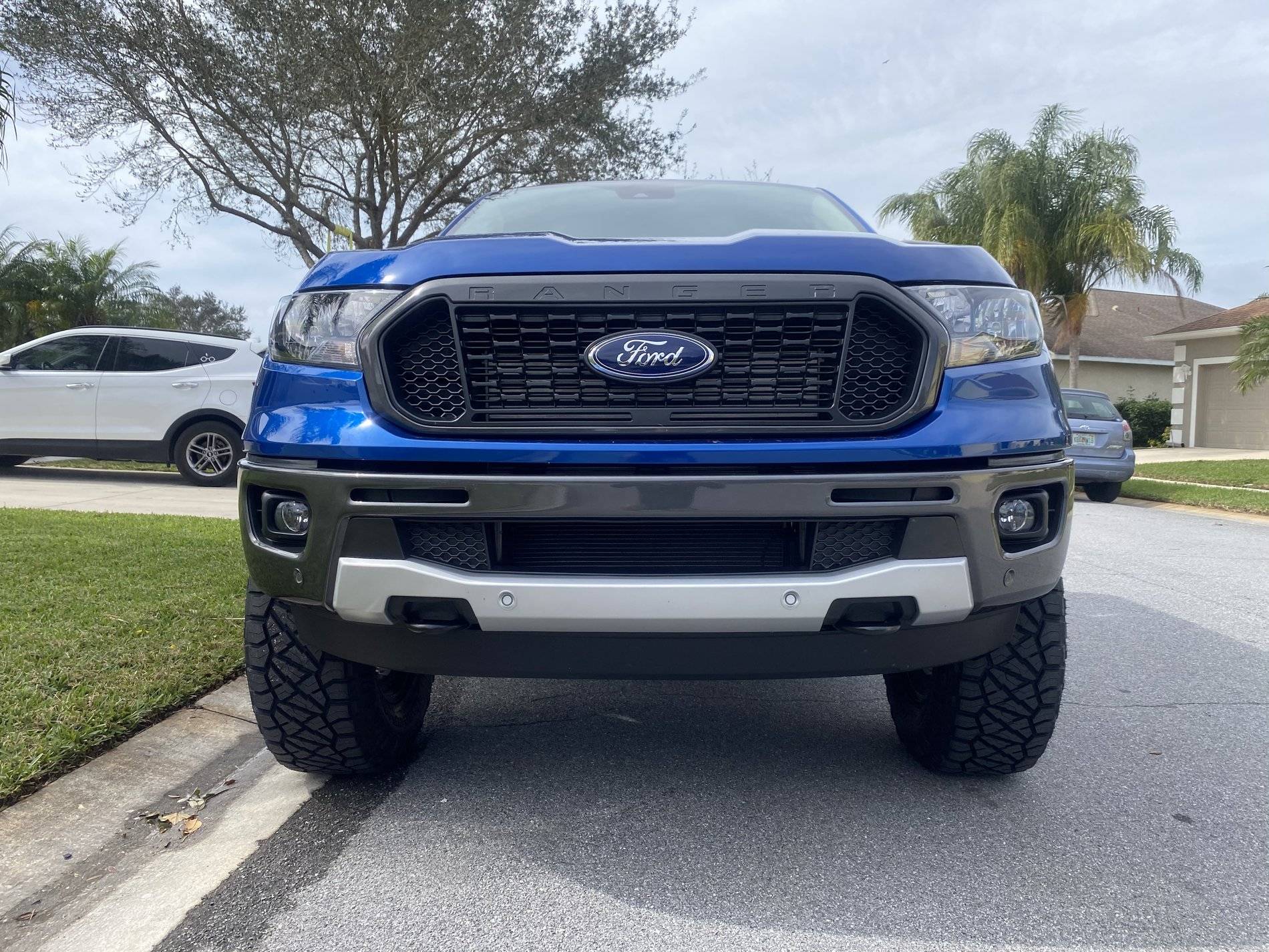

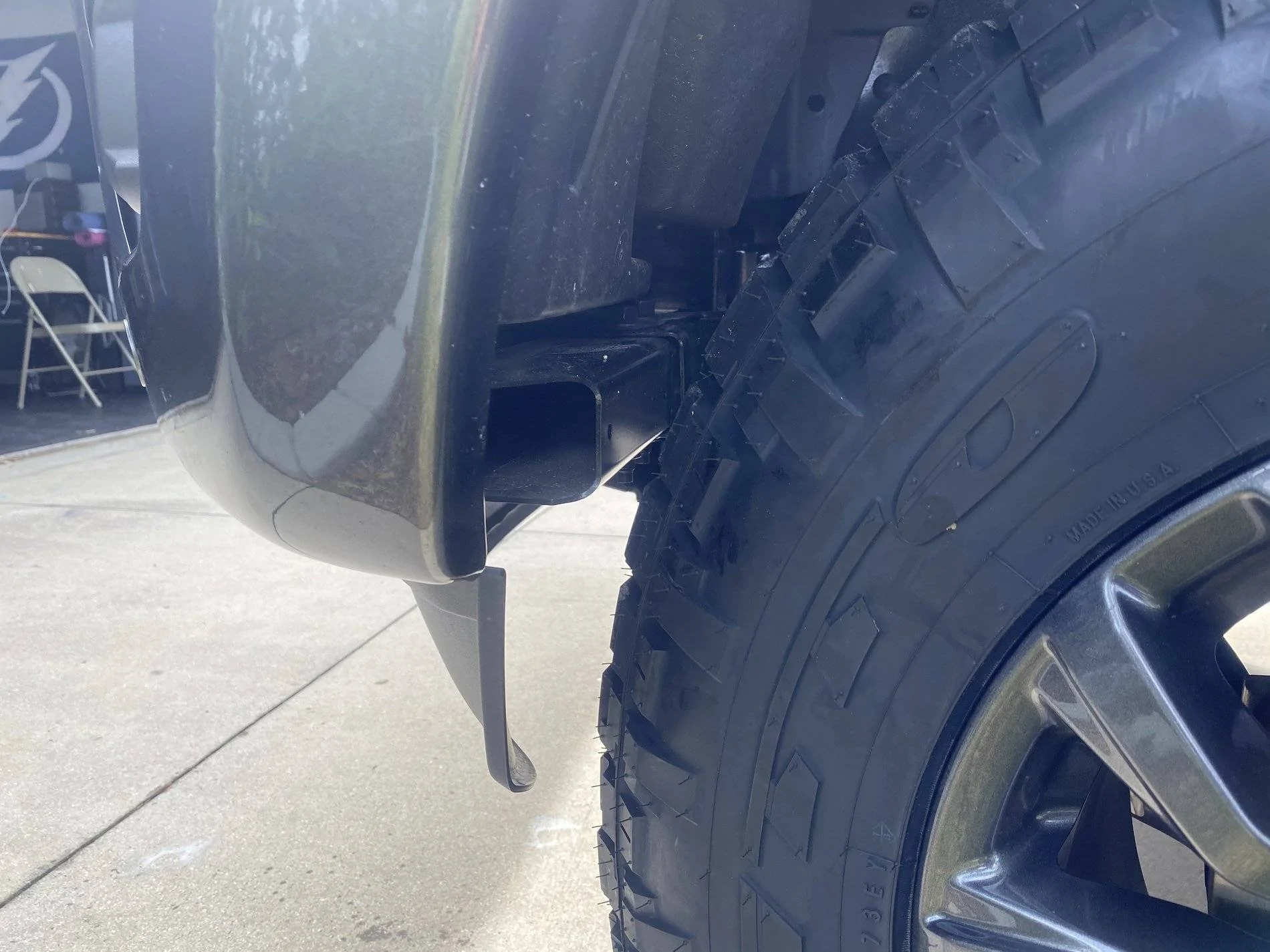

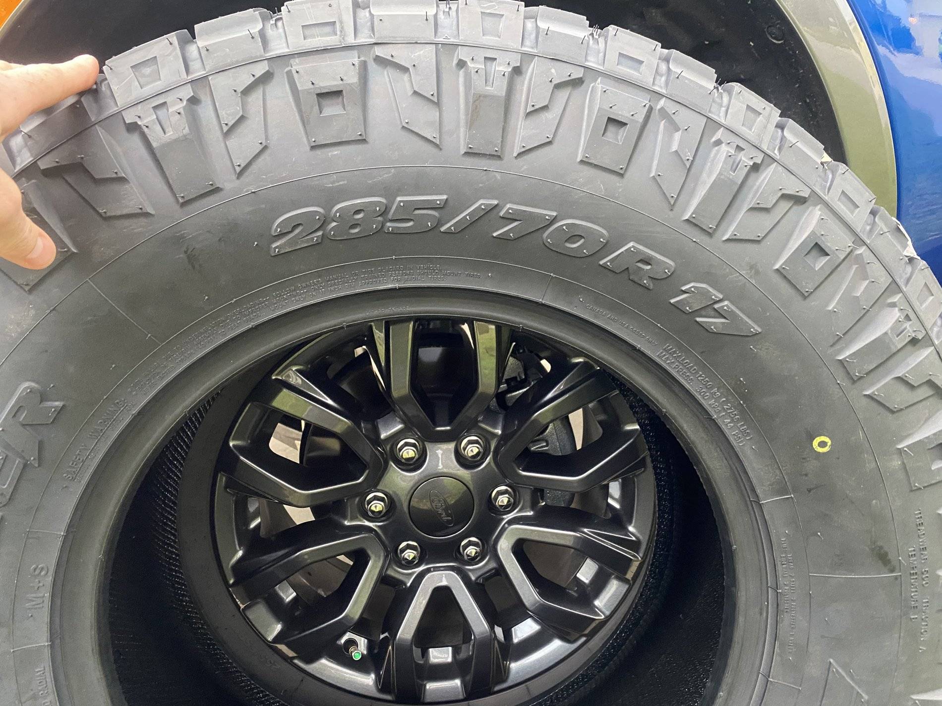

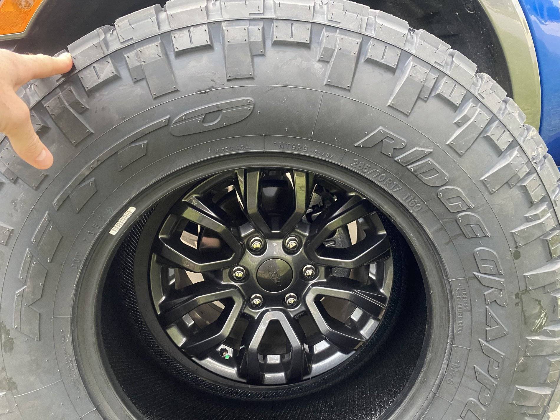

I adjusted the front crash bars full forward to get ready for the tires. There was a good amount of play in them. 15mm socket and push them forward. The backs were already full aft. I also removed the plastic covers on them. Gives another 1/4” or so.

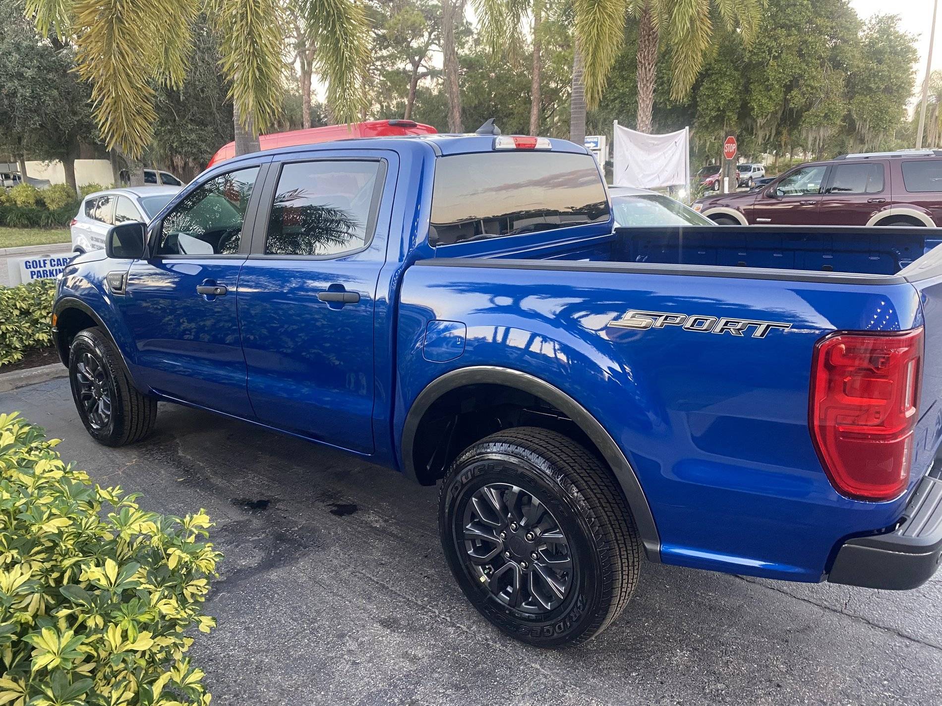

I was having a hard time deciding if I was going to keep the stock sport wheels or get some new ones. Decided to at least keep the 17” size wheel even if I changed later, so I ordered the tires from @Discount Tire . They priced matched(bonus no taxes because of the internet) and they showed up to my door 2 days later. Went with the nitto ridge grappler 285/70R17 116Q. They are way lighter than the LT rates tires and I drive the interstate a lot so I’m hoping that helps with gas mileage over the LT versions.

The nitto have 2 different sidewalls you can choose from and I was trying to decide between them.

Ultimately choose the less dressed up sidewall. I like the look of the distinct blocks this way. Guys at the local tires shop put them on today.
Ford Ranger My blue xlt CCC07CDA-C4E6-4CC6-8C56-23B4B576AB0F
Ford Ranger My blue xlt 692C9CAC-CAD7-44A6-A58F-0FE6235F1A4D
Ford Ranger My blue xlt 5E2718A2-D810-48ED-94E3-D1A8BE8B8352
Ford Ranger My blue xlt B46209BA-8310-4B75-A716-5A1205E02CF6

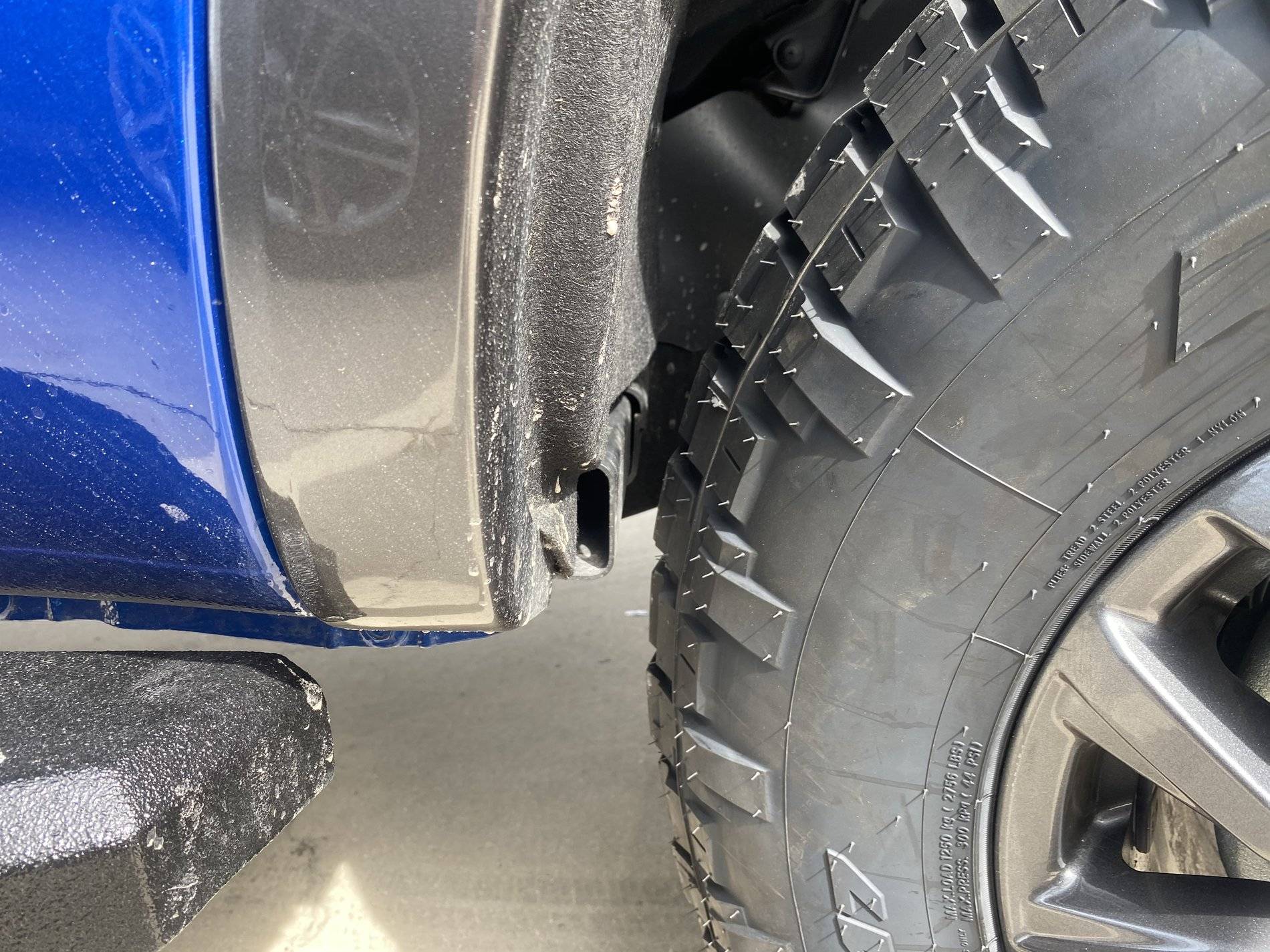

Really happy I chose to stay with the sport wheels for now. They look better in person than all the pictures I have looked at on here. Still may swap them out later but for now it’s fine.
Clearance on the front and back bars. I have a video of moving the wheels full lock in both directions but I can’t post it here. Everything clears on a level surface. I still need to make sure entering and exiting inclines and declines though.
Ford Ranger My blue xlt 6C78BB89-3993-4D7A-985F-DA95CC73AEBD
Ford Ranger My blue xlt AFCC4449-4D20-48B1-ABA8-F1C4EAD3A122
The pictures make it look closer than it really is. There seems to be plenty of room.
