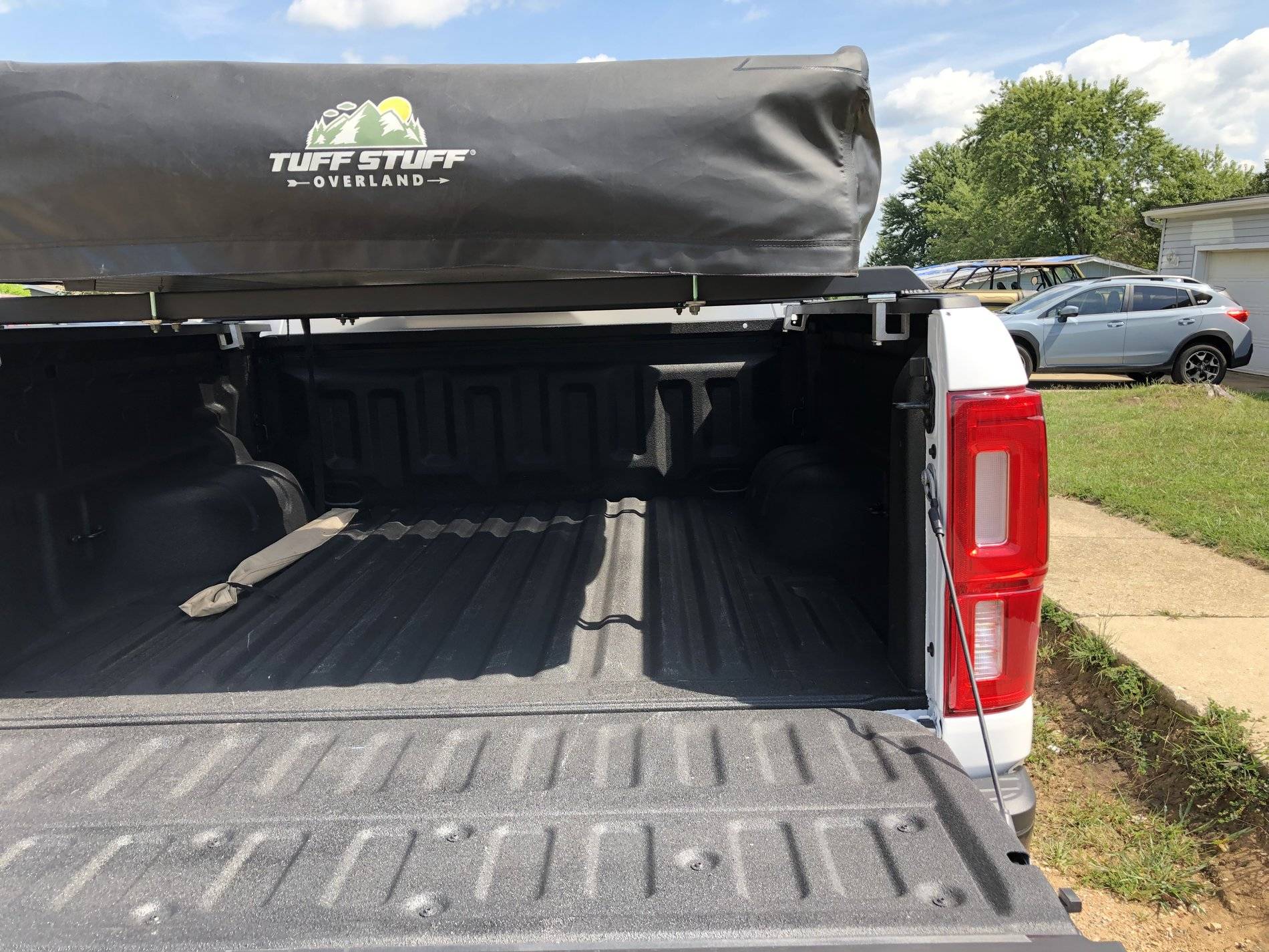

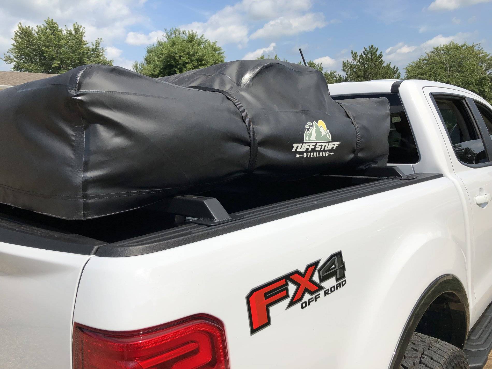

I made a rack with Uni-Strut, some 1/8” plate, and modified topper clamps. I also have another option for a tent base/frame work that I used in my F150. It was also inexpensive and worked great. I think it would be useable with the Bakflip. I will try to find a picture...

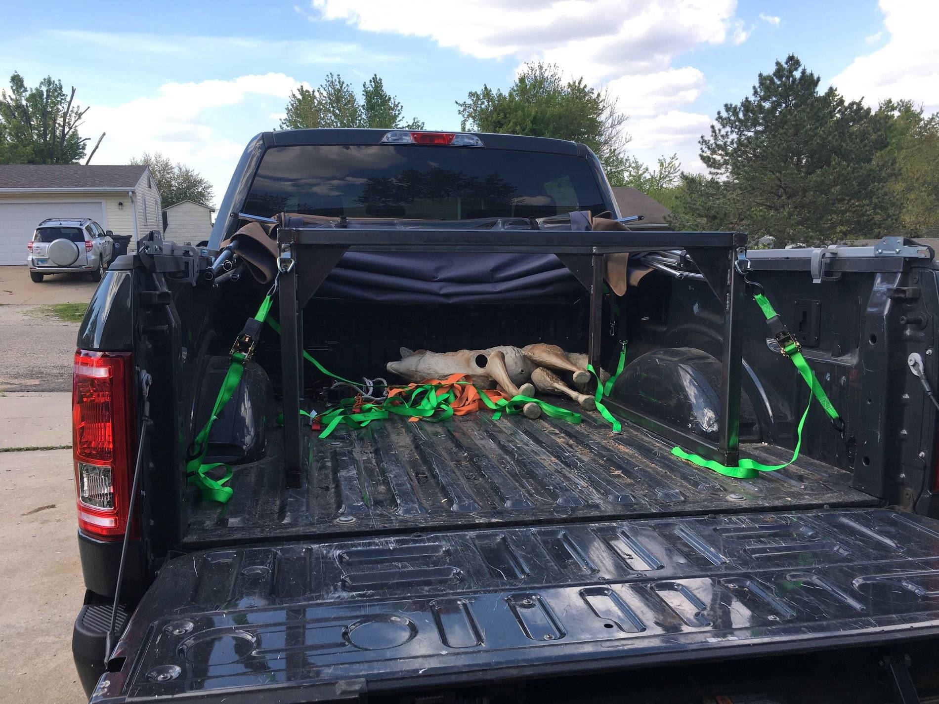

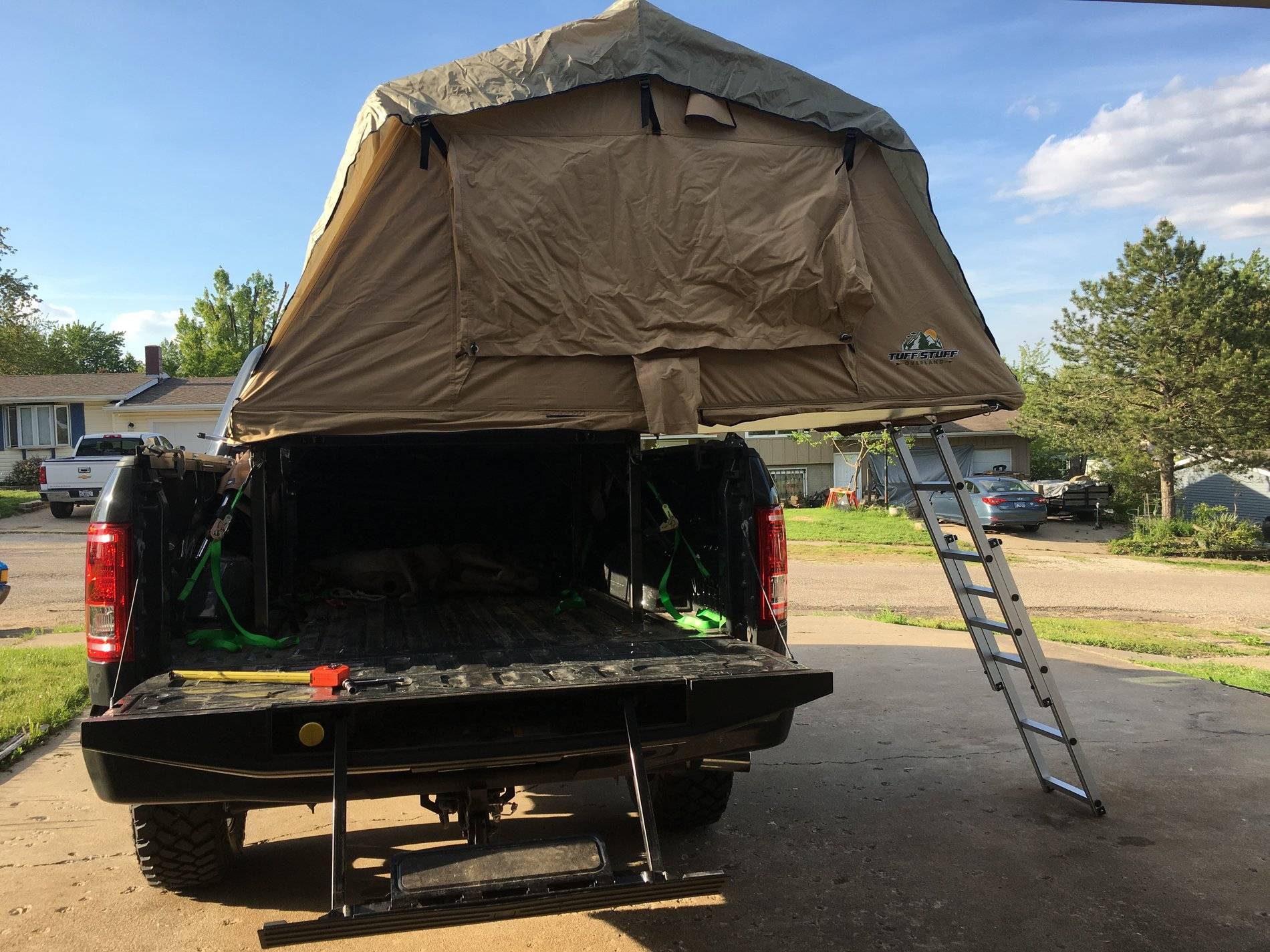

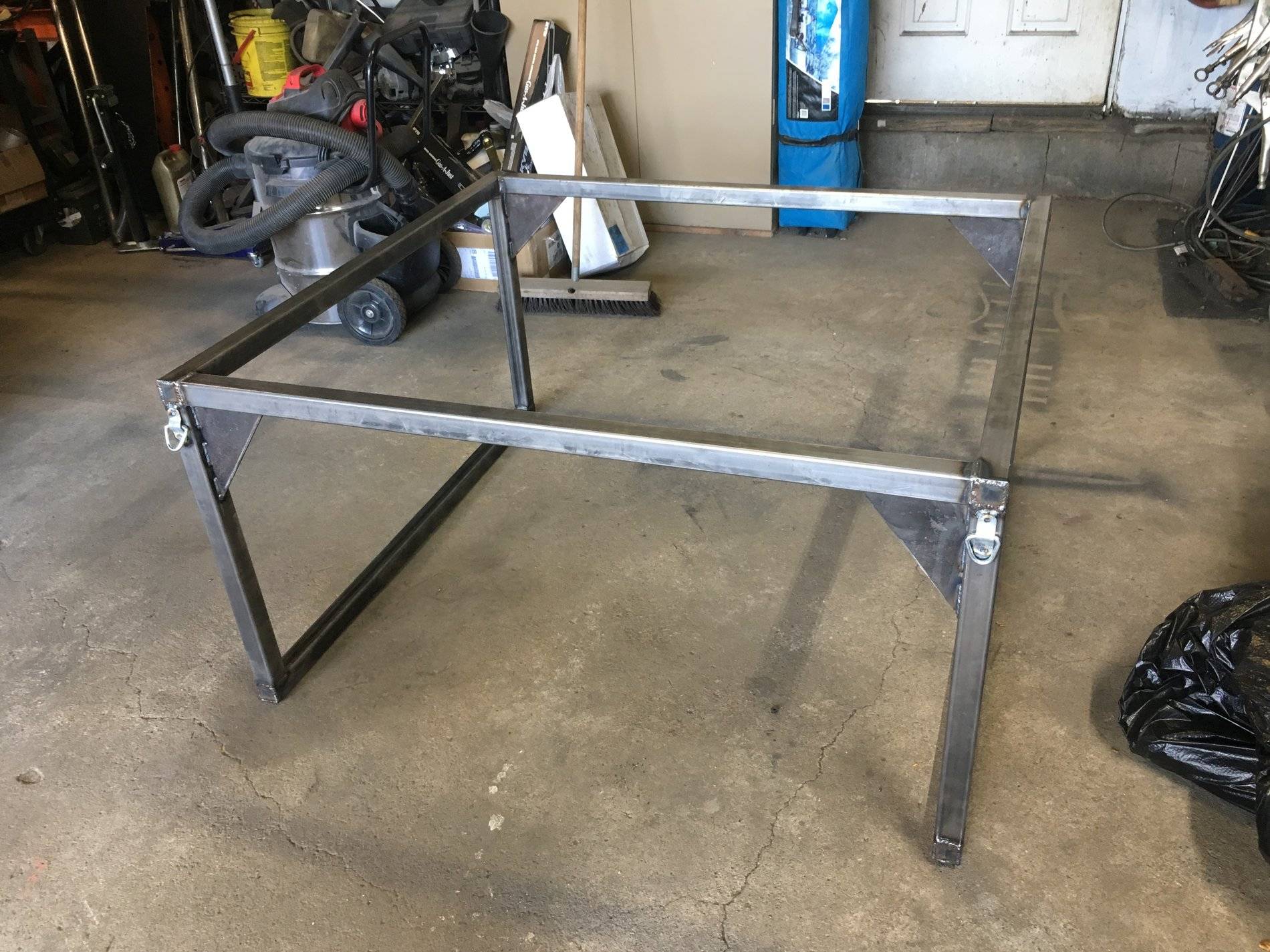

Here is the frame I made when I used the tent in my 2016 F150. It’s just 1 1/2” square tube with some 3/16” gussets. Straps in at 4 corners, fairly lightweight and easy to load in or out with 2 people. With the tent collapsed it would also fit under my Softopper. It is too wide for the Ranger....I would cut it down to fit but I made it to also use on my offroad trailer.
