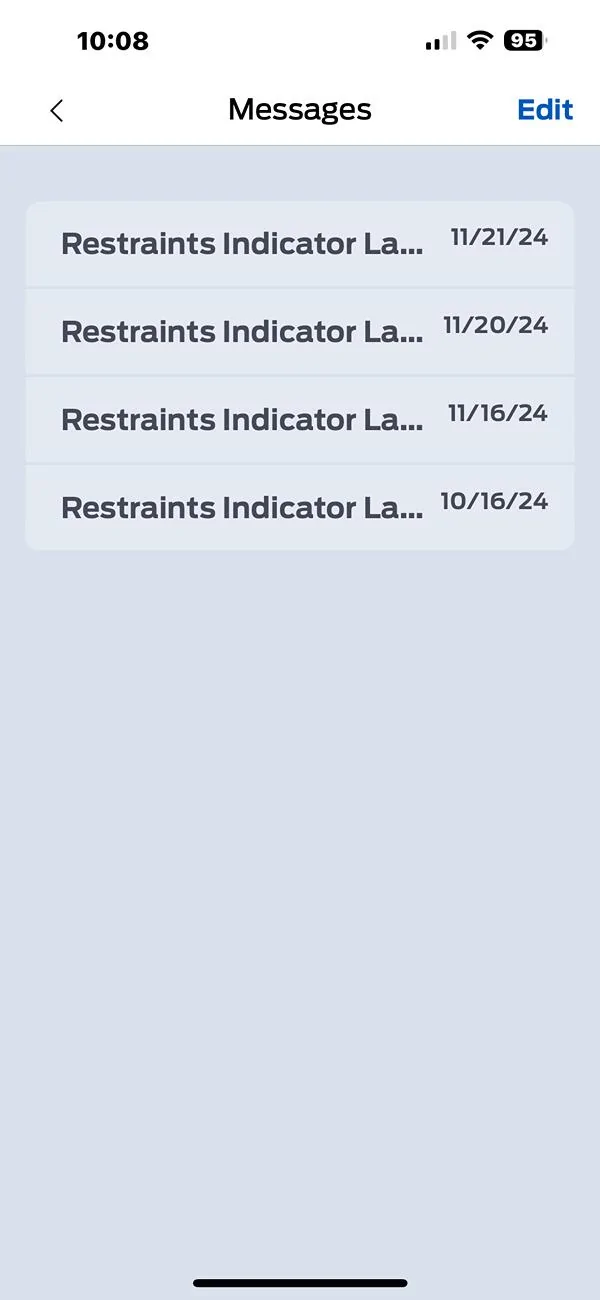

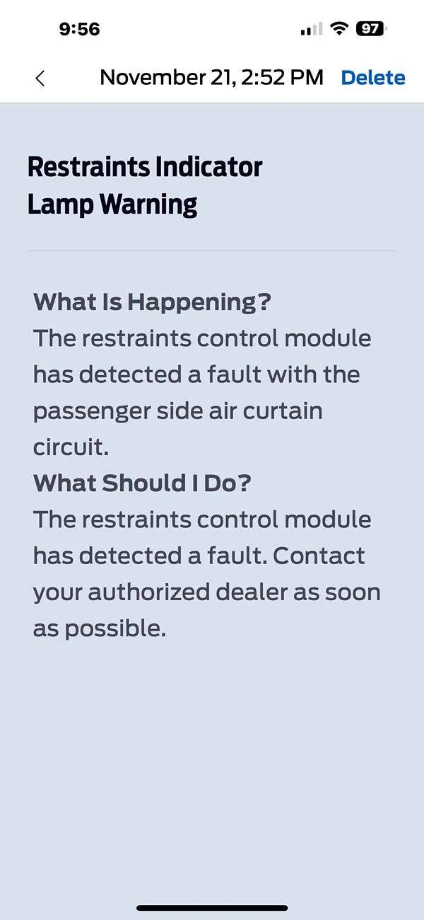

Has anyone else had this error message ? This did not start until it got cold in Wisconsin. First time it was on and went away on the next start up. Now on all the time with an orange air bag light on the dash and ford pass showing the fault.

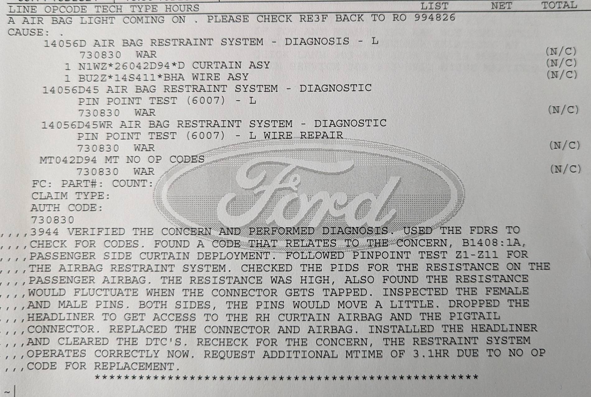

Were you able to get yours fixed up? Just picked mine up from the dealer. Took about half a day once the part(s) finally came in. Tech's notes are below for mine.

Sort of makes sense. The notes my tech left on that invoice said they could see the resistance changing as the wiggled the connector/pins which is why the replaced the pigtail connector too.
