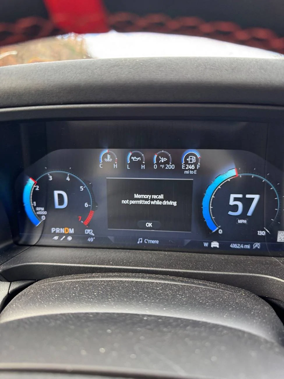

My power seat stopped working on the drivers side this morning. I stopped and started the truck a couple of times and it worked. Then, after my first stop, it stopped working and I started getting this message intermittently (see pic).
At the next stop light the seat started moving forward on its own.
The auto positioning, manual controls, and memory all don’t work.
Has anybody else experienced this?

In the posted photo the truck is moving. Memory function won’t work unless completely stopped - at least thats how mine works. Seems like manual controls should still work, unless there is an algorithm that shuts them off above a certain speed. I’ve had my truck for almost 6 months & it there are still odd things that happen transiently.

I didn’t try the memory controls. That’s whole point - it was trying something on its own. When I stopped at a light the seat moved on its own. And the manual controls do not work. Neither does the auto adjustment when you get in/out.
