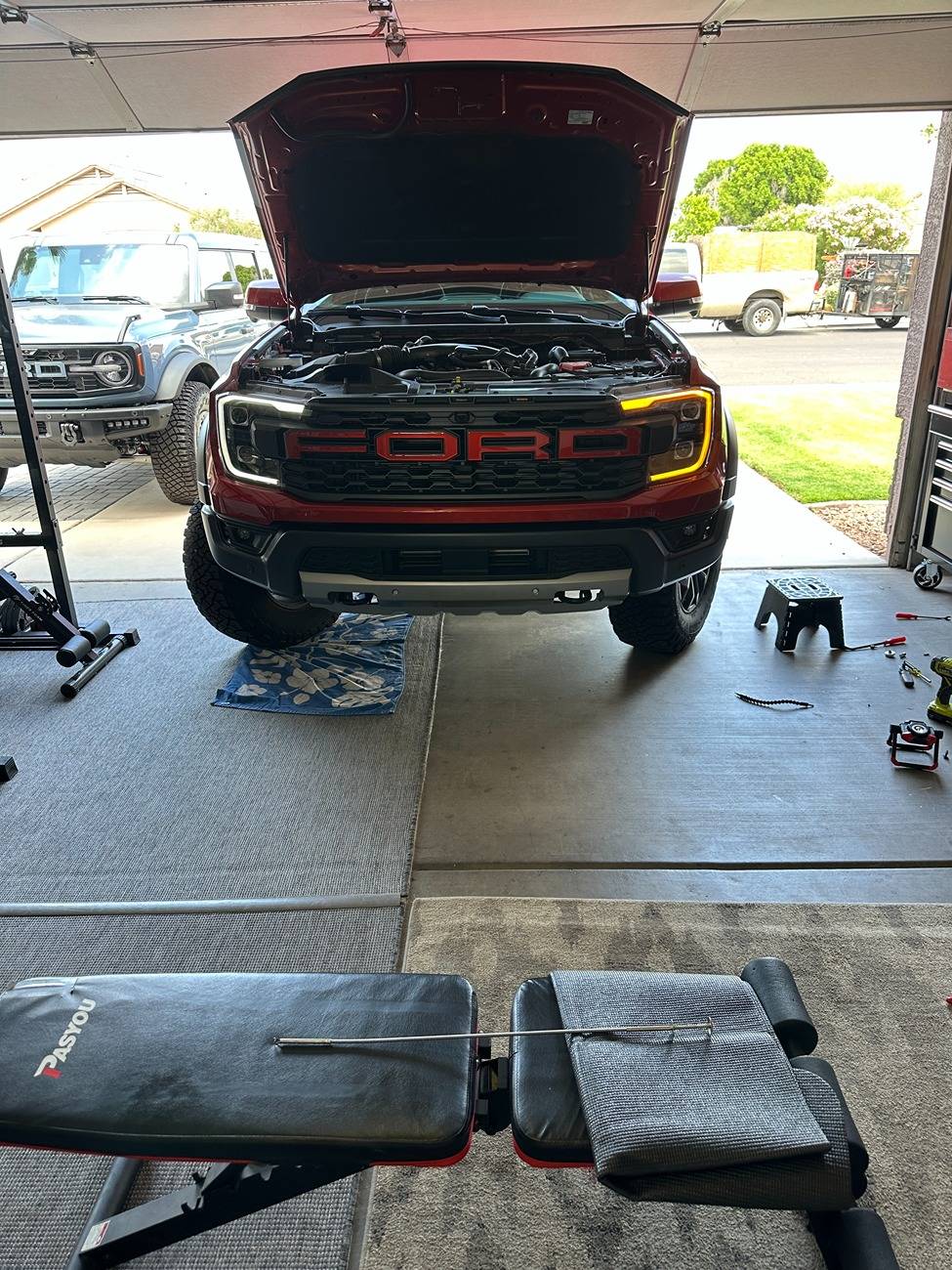

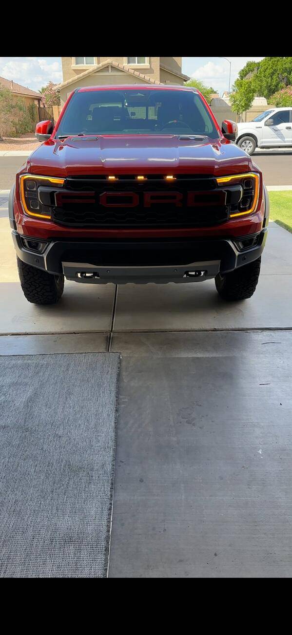

Installed mine yesterday. Took about 2.5 hours. The flexible bit extension and thumb ratchet the install instructions were crucial. There's no way I could've done it without them. Still ended up losing one of the module screws, but I have a replacement on order.
Ford Ranger SIGNATURE LUX Lava" Amber DRL Conversion Headlights IMG_9026.JPG
Ford Ranger SIGNATURE LUX Lava" Amber DRL Conversion Headlights IMG_9029
Looks great!
