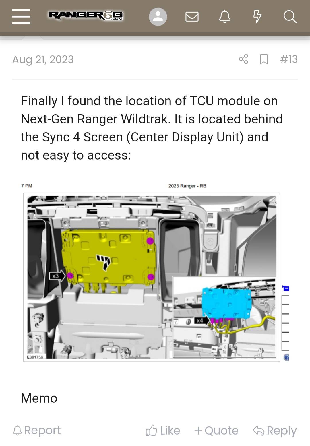

Does anyone have information on the location of the Telematics Control Unit in the 6th gen Ranger?

You plan on removing it?
Unplugging the power source, if possible.
I just saw on another thread that it is located directly behind the main display.

I would have to agree with you. The only issue will be how to access them without damaging the display screen.

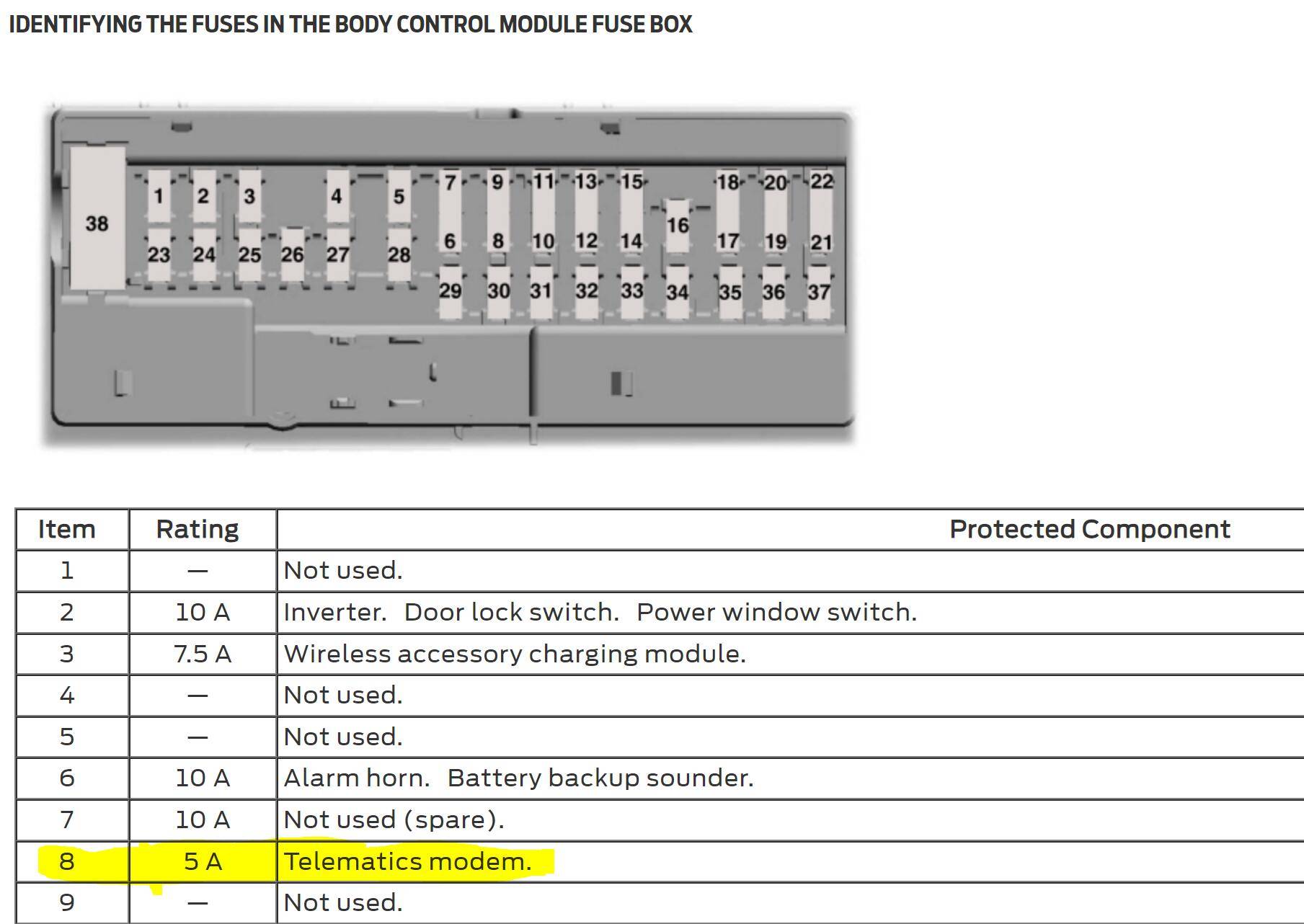

Ford Ranger Telematics Control Unit Screenshot_20231115_094829_Samsung Internet
gForceDude
Dude
Jun 2, 2023
Kitsap Peninsula, Washington State
'24 Ranger Lariat FX4 (coming soon!)
The Telematics Control Unit probably has it's own fuse. One should be able to disable it by simply pulling the fuse. And if there are any unintended consequences, then it would also be easy to reverse the procedure.
Edited to add:
I have no idea where the fuse might be.
