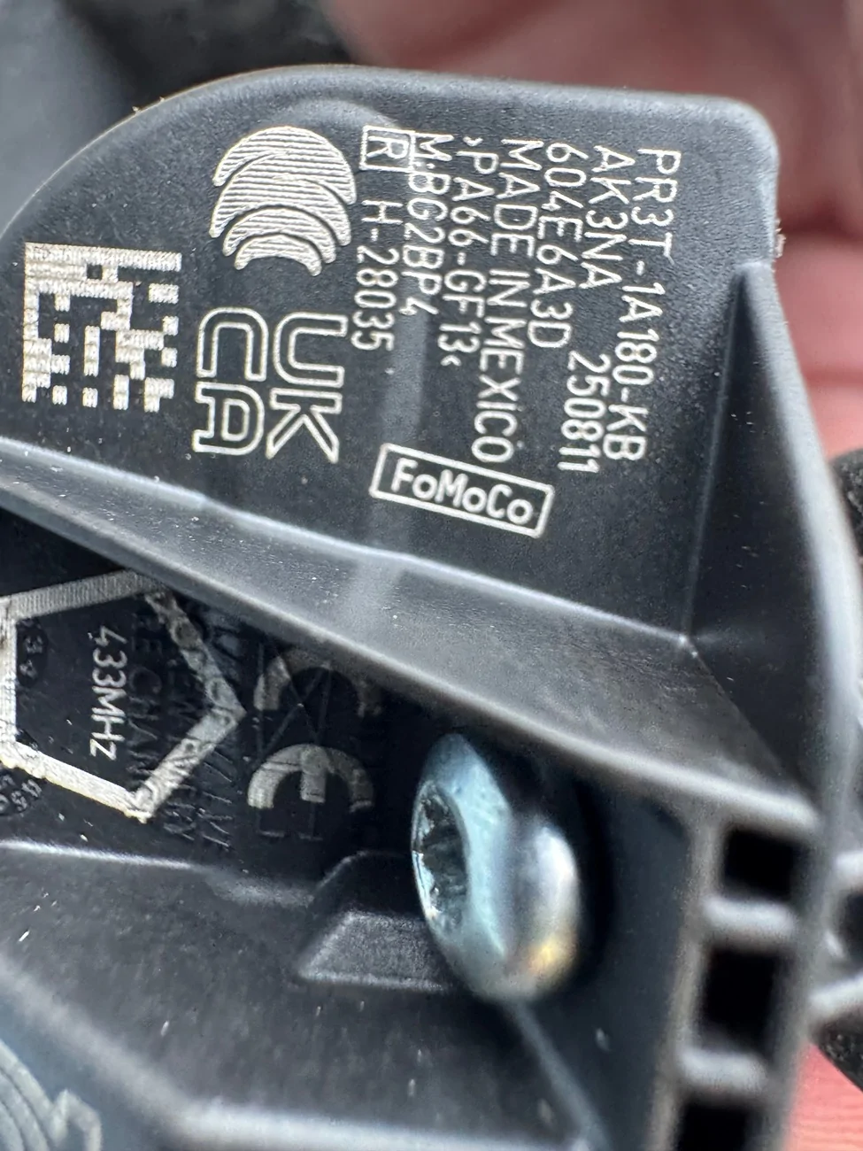

yup my are identical. mine started build 04/20/25 and was received by me 06/05

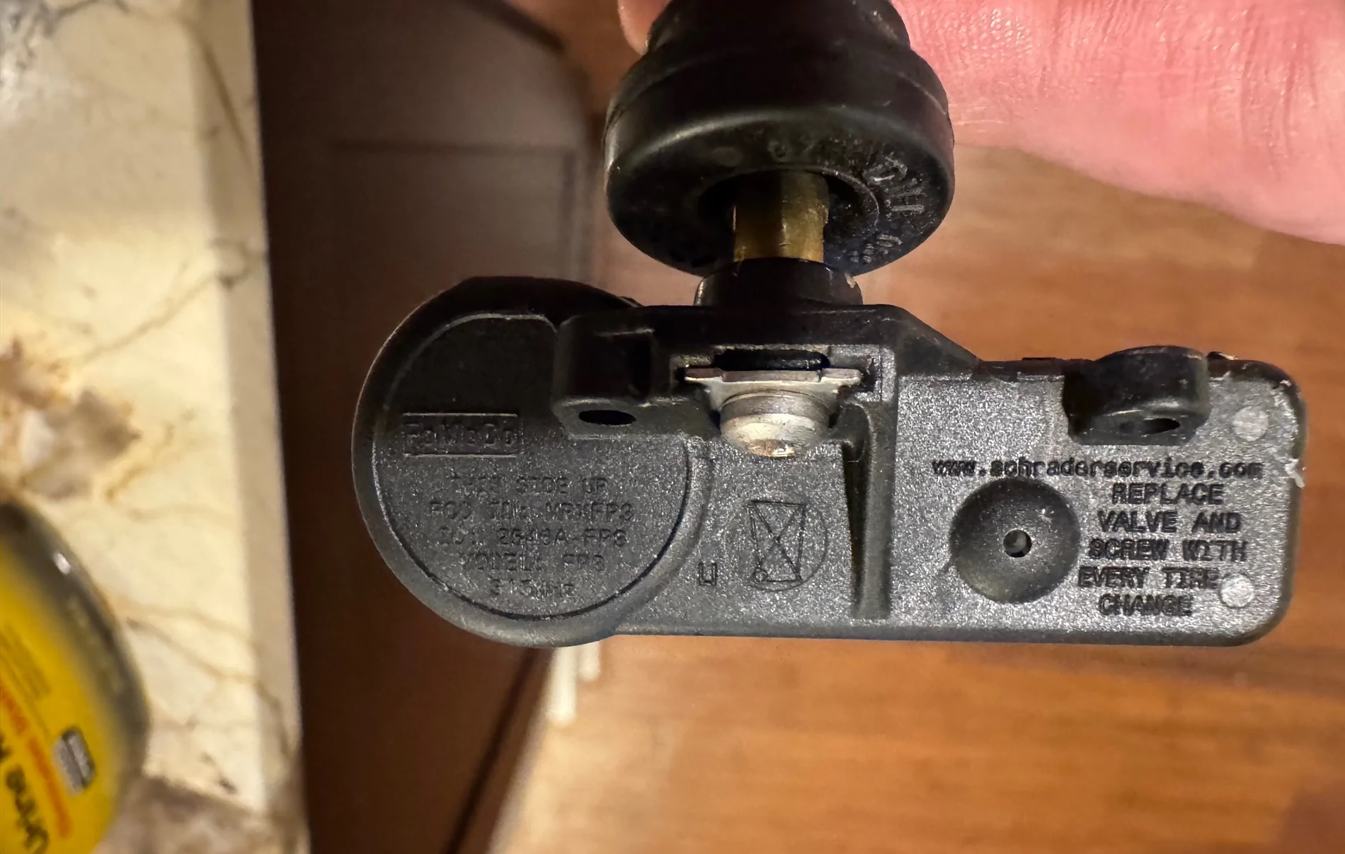

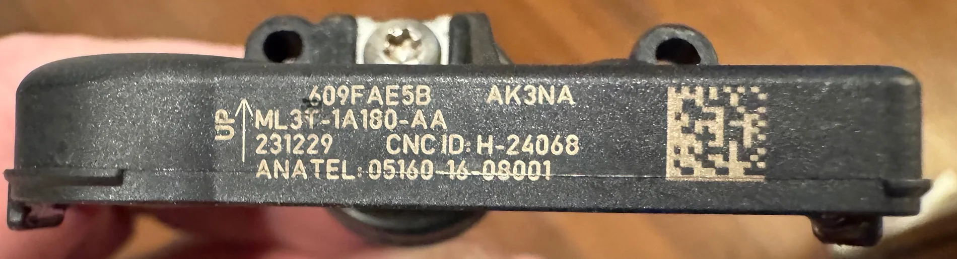

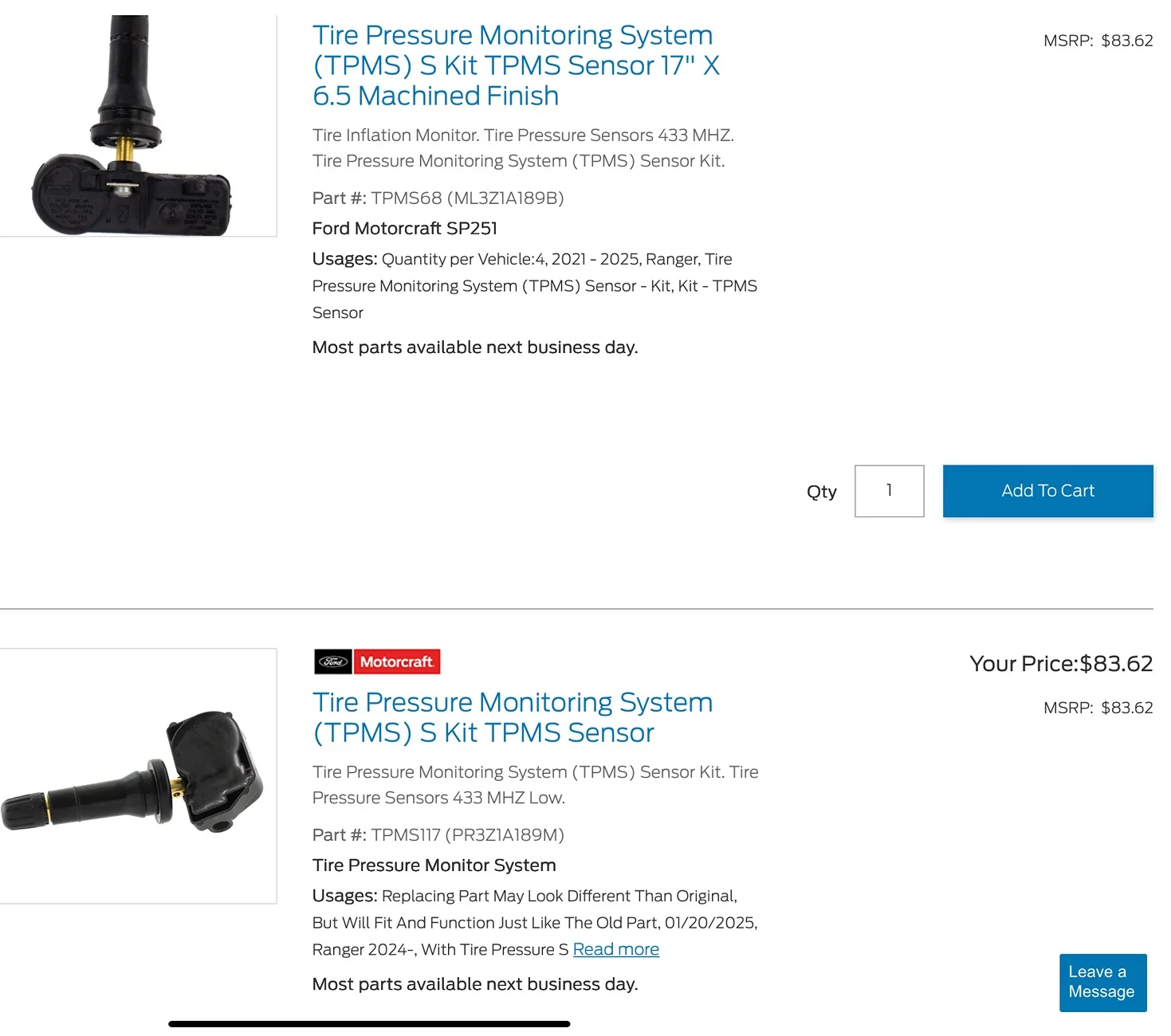

Just to show proof, these were the 68s that came out of the wheels I briefly had on my 25 model that would not read them. Yet the Vin number entered into fords parts lookup showed it was correct for both 24 and 25 models. Which those are the OEM sensors that came in my 2$ model and the 25 would not program to them.
Ford Ranger TPMS changed in 2025 models, possibly only the later build dates. IMG_4363
Ford Ranger TPMS changed in 2025 models, possibly only the later build dates. IMG_4364

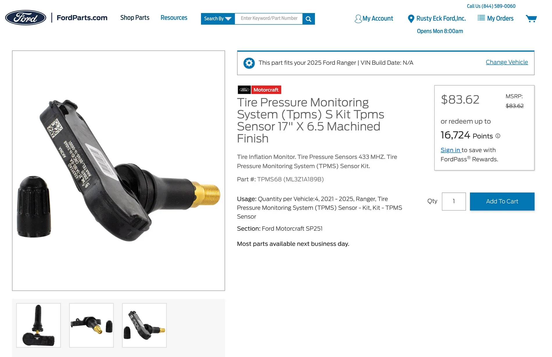

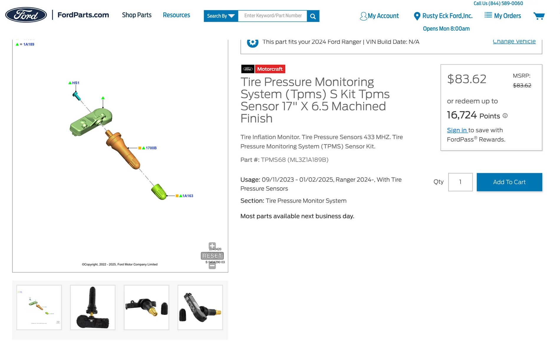

This is the screen shot from the ford website showing the same sensor fitting my 25 model Ranger verified by Vin. Which turns out the Ford website was wrong. That is clearly not the sensor that came in my 2025 model.
Ford Ranger TPMS changed in 2025 models, possibly only the later build dates. IMG_5806
Thats why I found this so very irritating, when I spent so much time and the tire shops time trying to get them to program. At the very least Ford needs to update and fix their parts into.
‘I really wish they would stop doing crap like this changing sensors for no reason. It just makes for a big waste of time, money and energy. :headbang::mad:

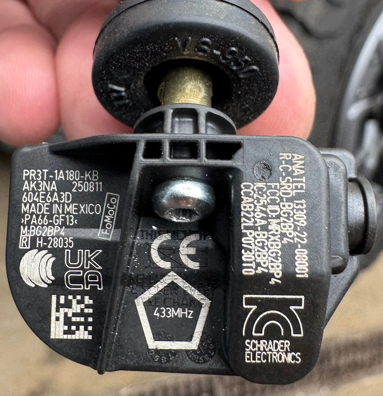

Again this is the correct sensor for my vin. Simply totally different sensor all together.

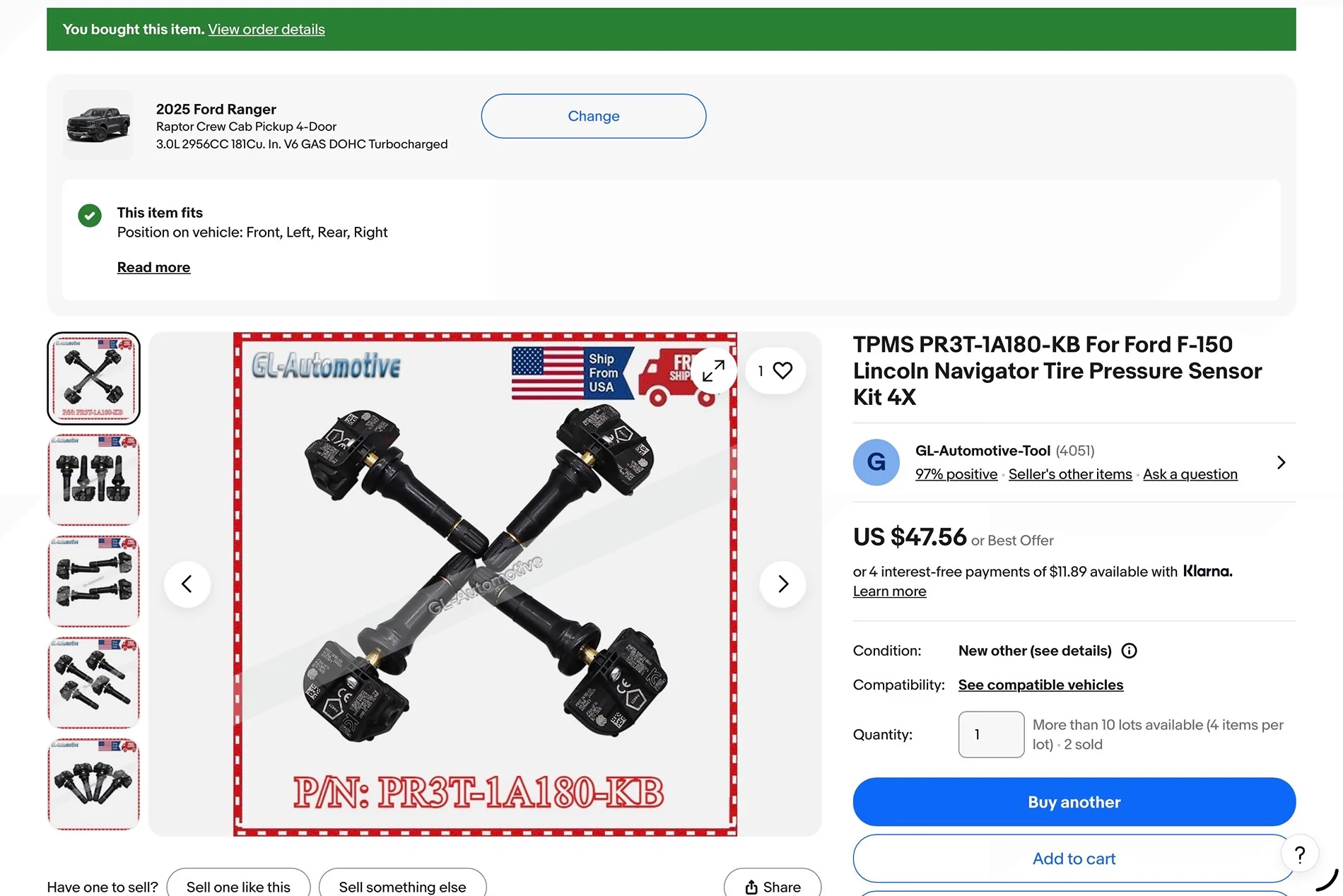

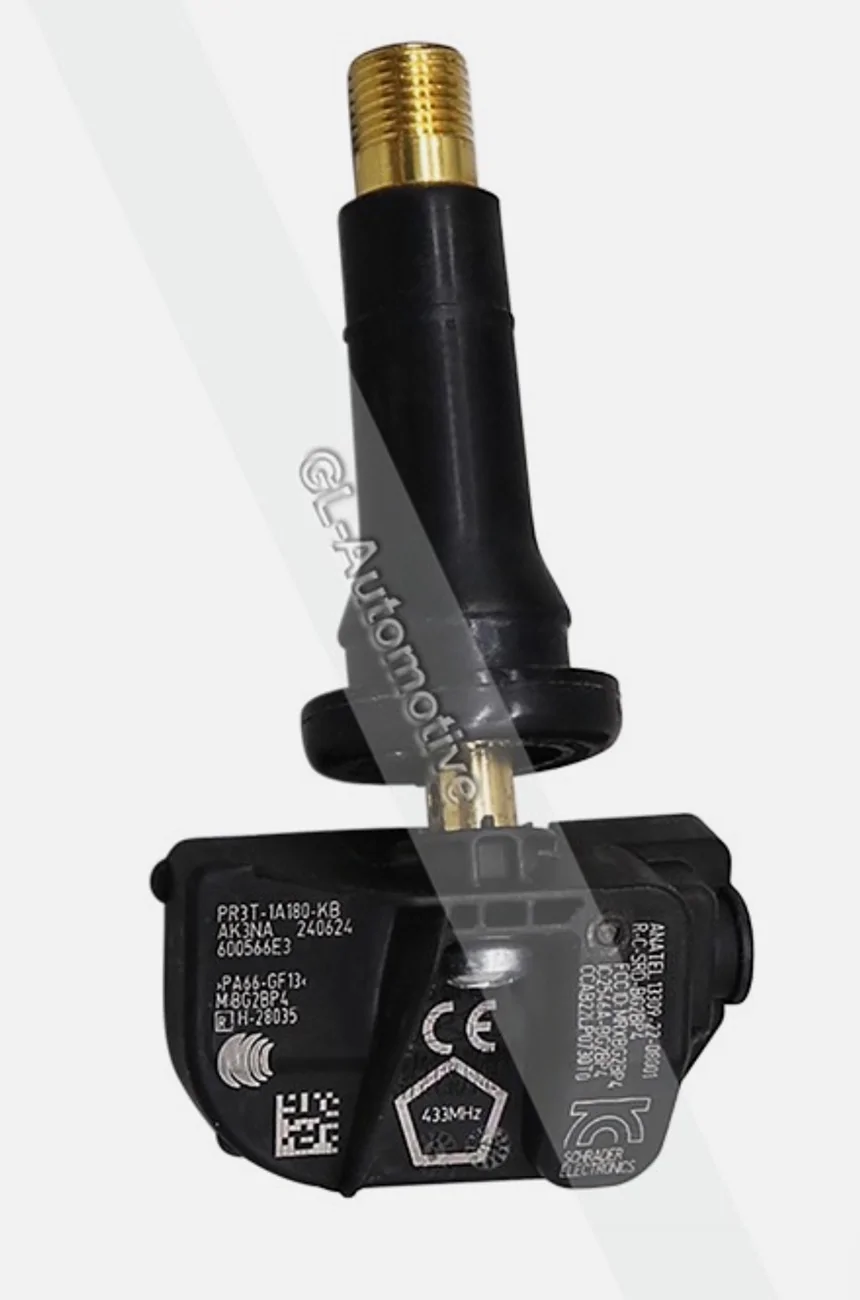

I did find a decent deal on some these sensors today,
Ford Ranger TPMS changed in 2025 models, possibly only the later build dates. IMG_6665
Ford Ranger TPMS changed in 2025 models, possibly only the later build dates. IMG_6664
Ford Ranger TPMS changed in 2025 models, possibly only the later build dates. IMG_6663
