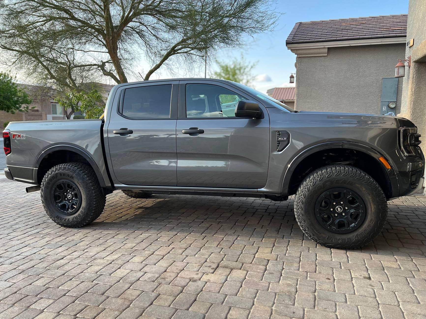

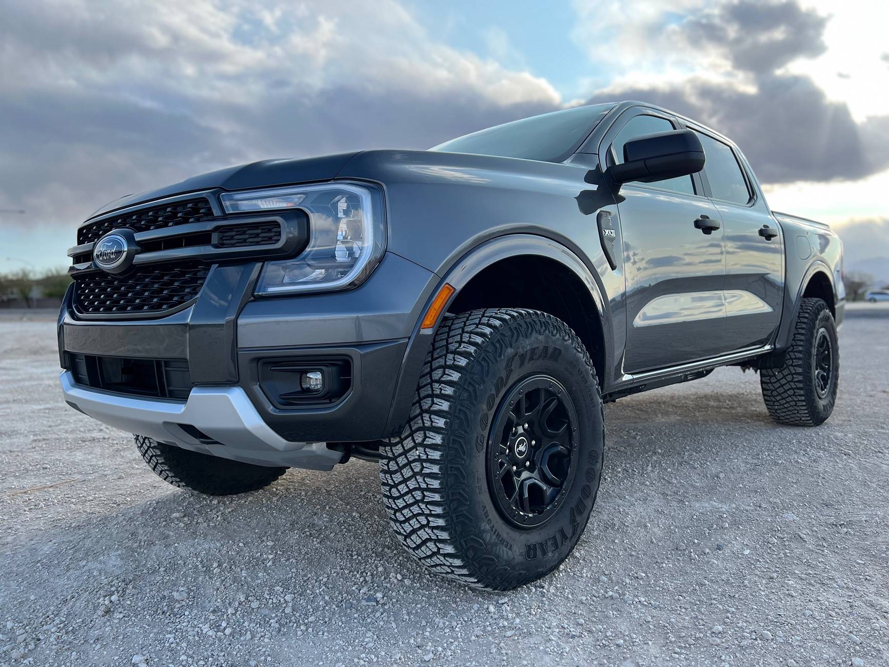

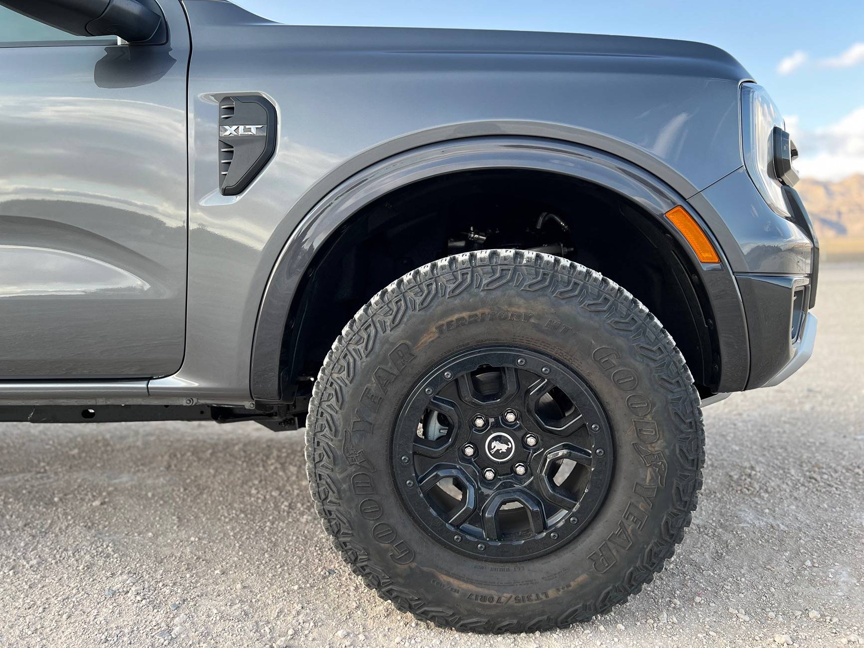

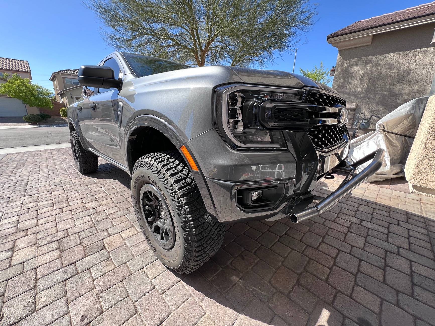

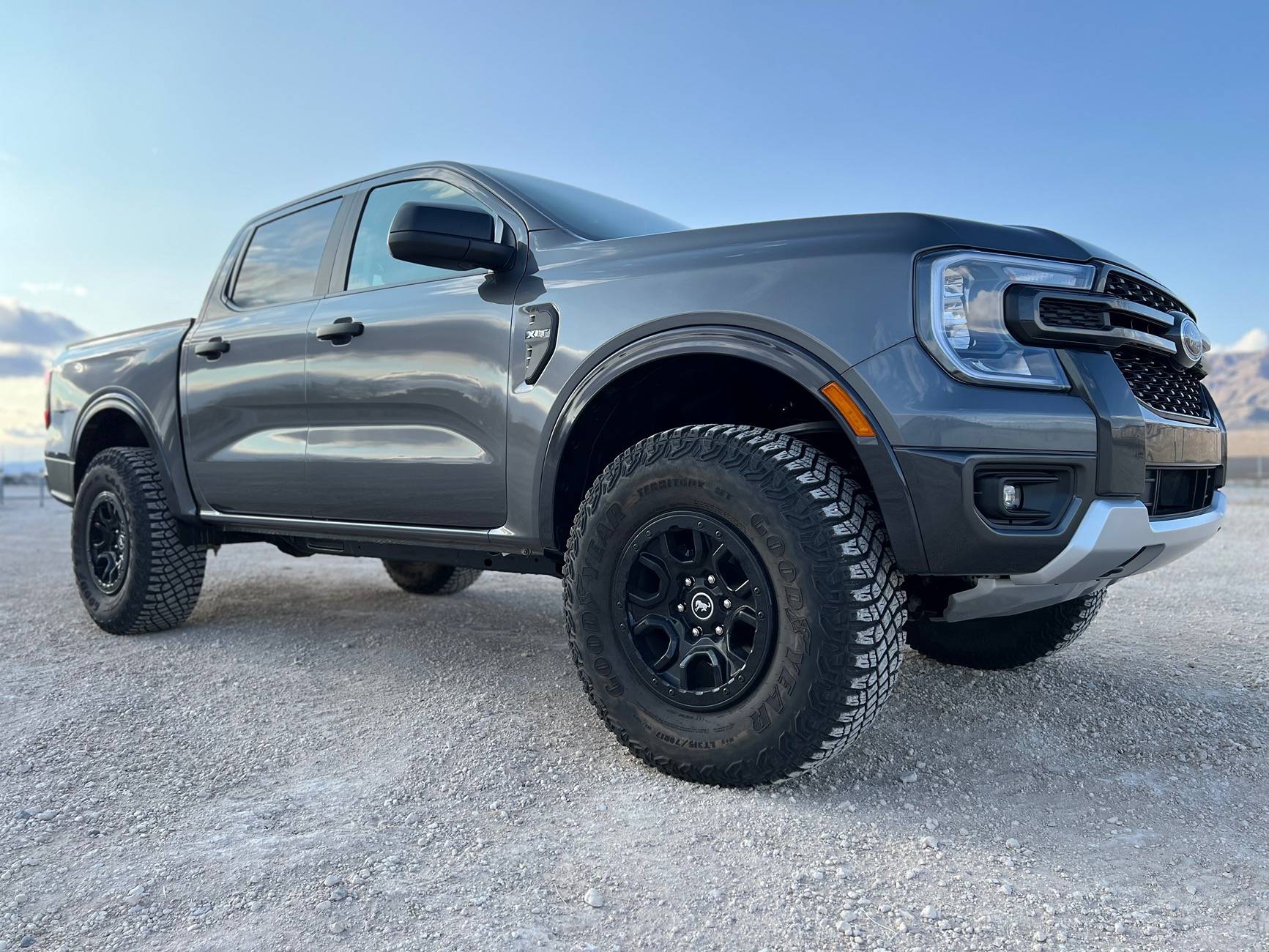

Just picked up last week. Put a 3” front level lift from www.Fordrangerlifts.com and added 315/70/17 Big Bronco Badlands factory beadlock capable wheels. Working on designing and building a prototype front bumper that will be winch ready and plenty strong. Will post pictures once fabricated.

So 3in front leveled it out? I was looking at the 2 in front 1 in rear, but this looks great.

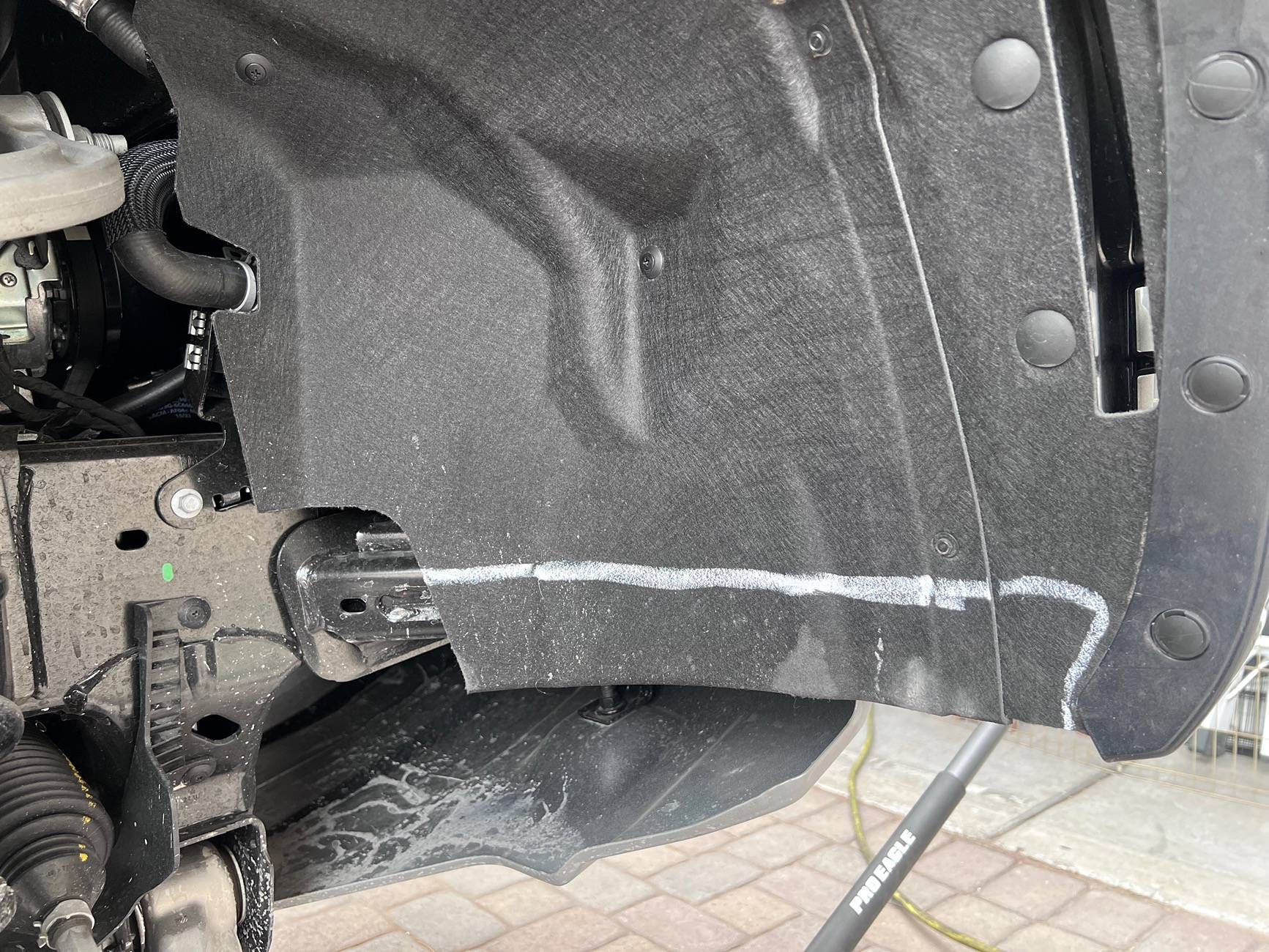

Looks great! How is the power with the 34.5? 2.3 or 2.7? Im considering someday 33s, but I can be convinced to go to 35s! Does it rub any?
yes the 3” makes it almost level. Still has about 1/2” front rake.

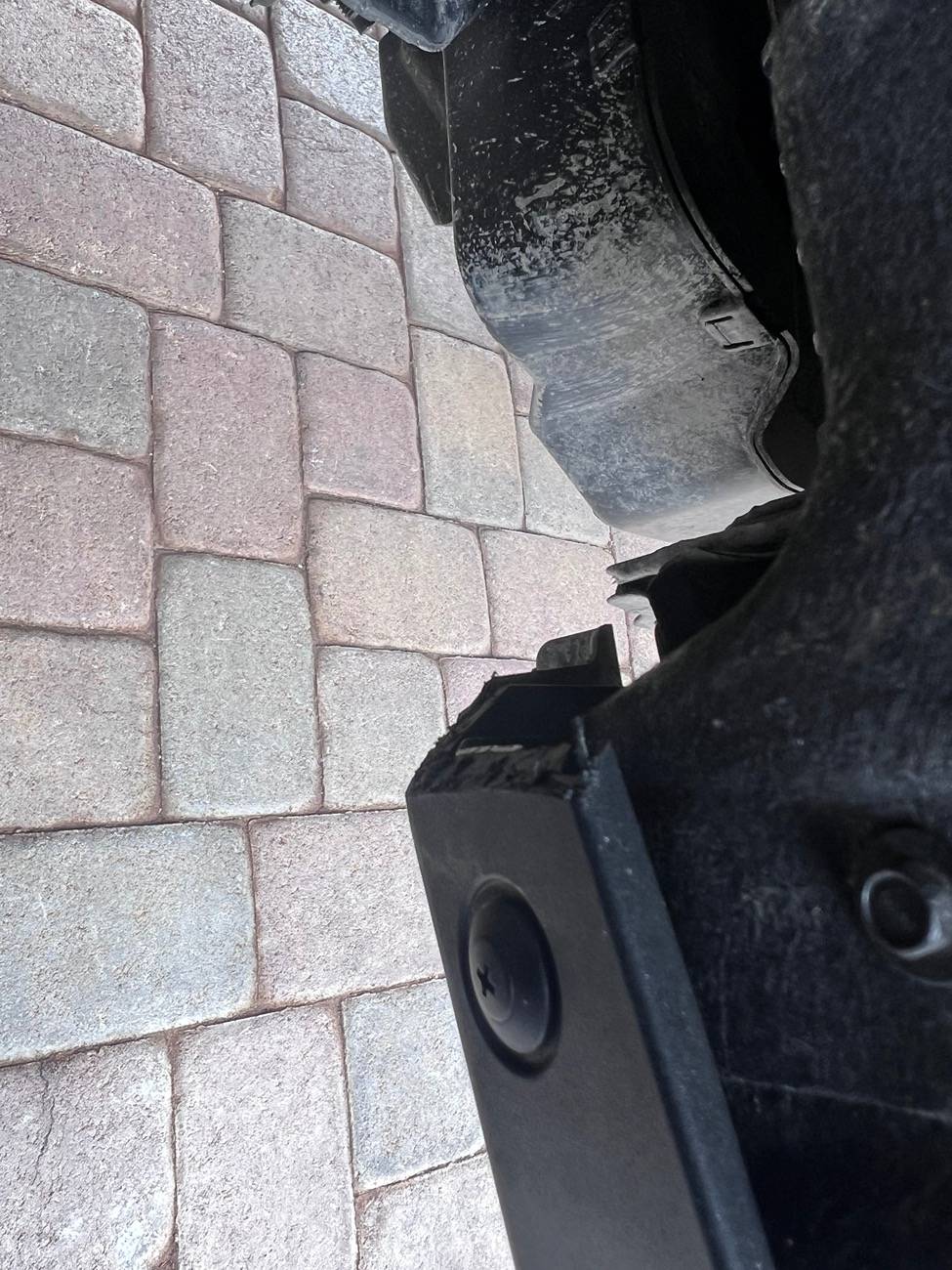

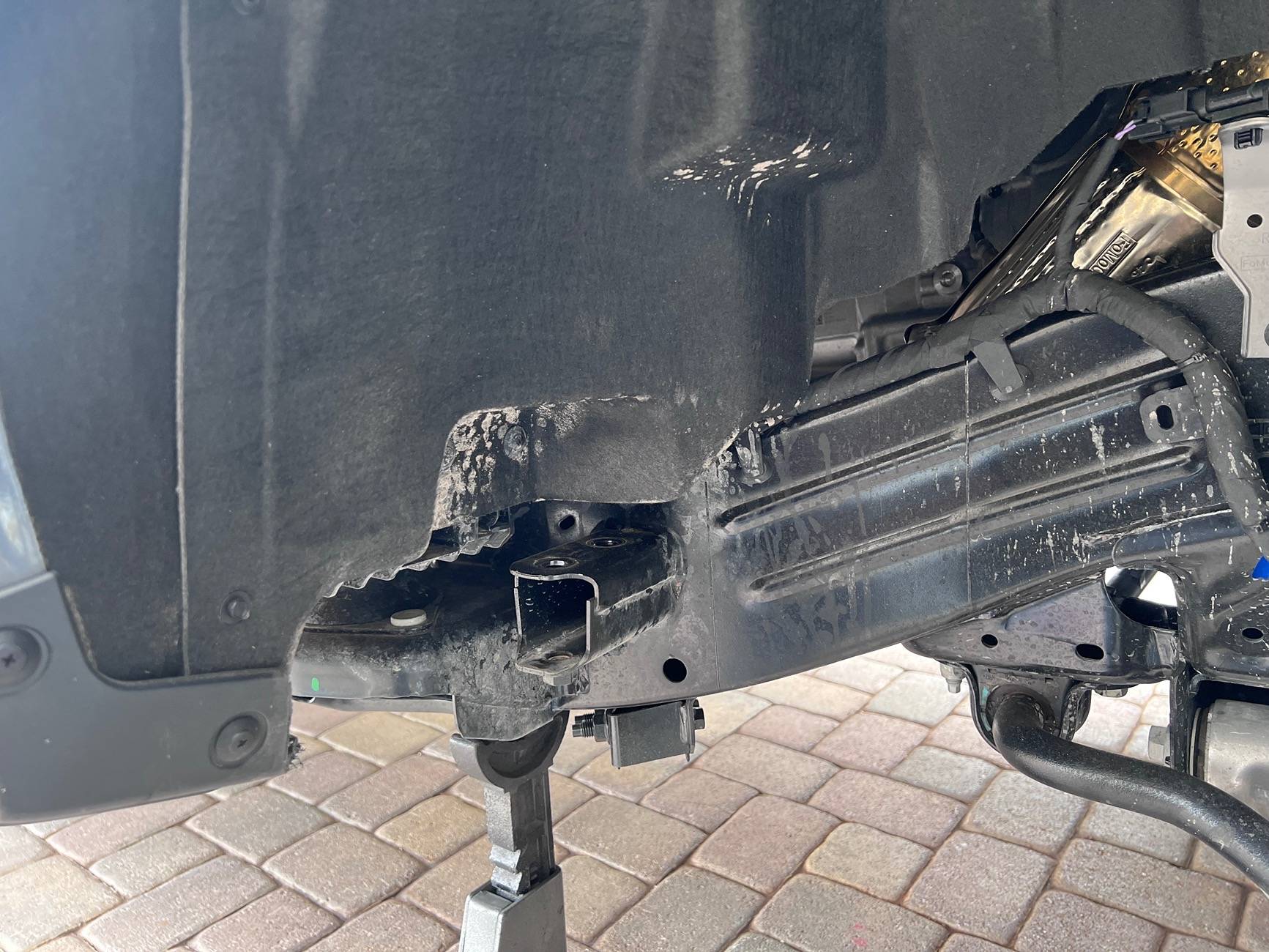

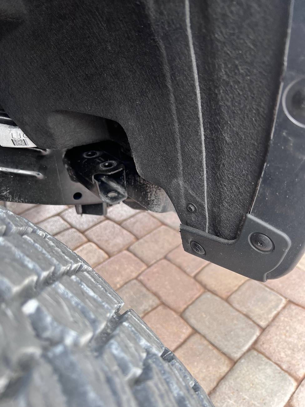

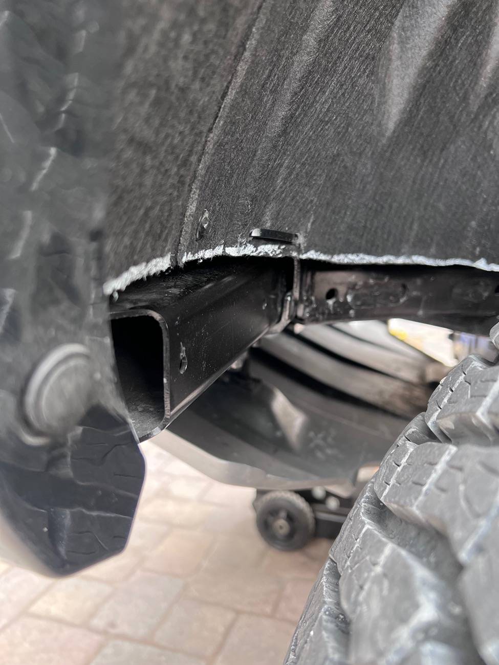

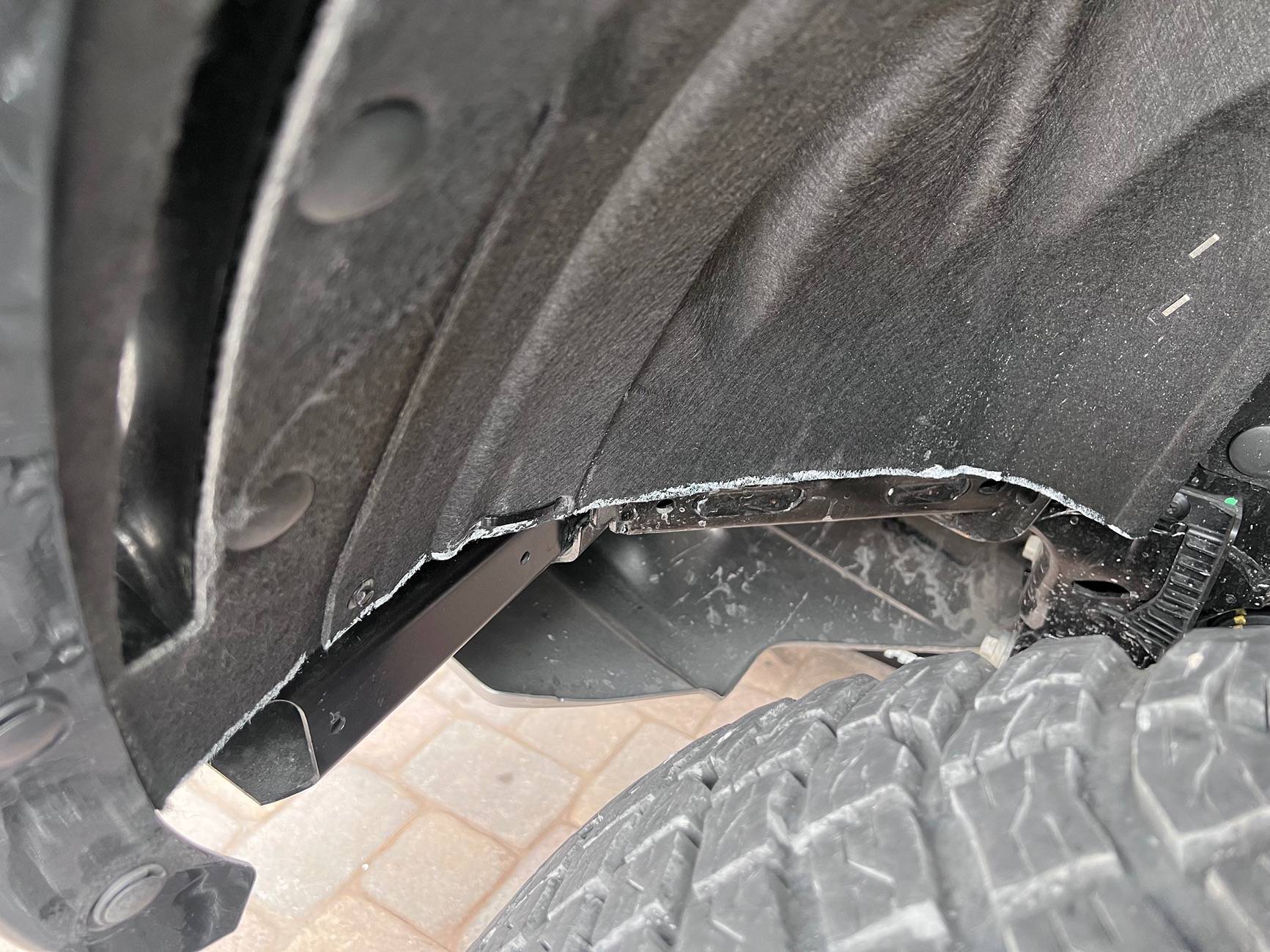

Power is great with the 2.3. No rubbing. I removed the rear crash bar piece. I left the front crash bar in and just trimmed the carpet felt up just flush with the top of the crash bar. Used a couple zip ties to pull the carpet felt back and tight.

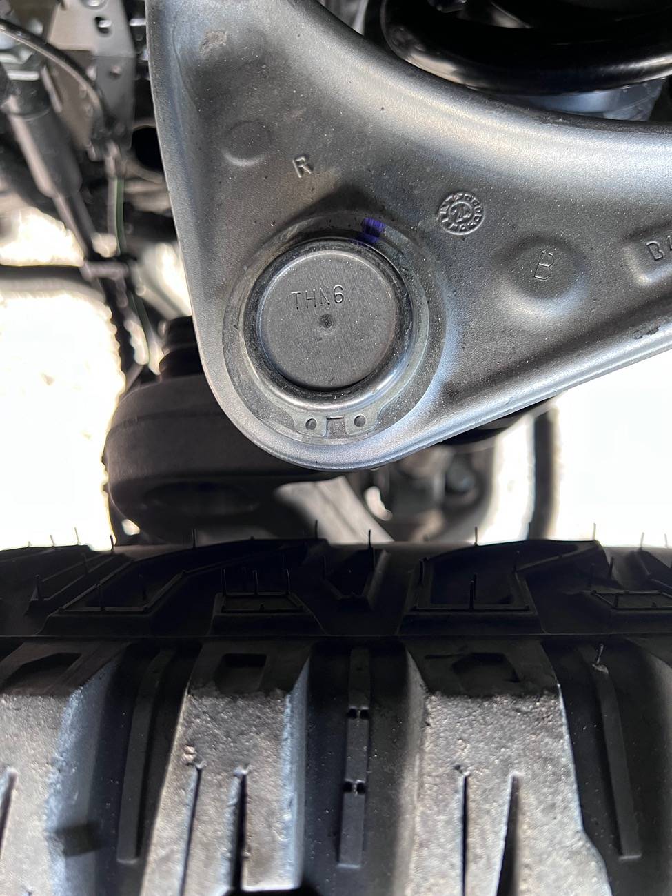

Did you add a wheel spacer to clear the UCA?. If you did how many inches. I’m considering going from 33s to 35s. And do you have the 2.3L?
