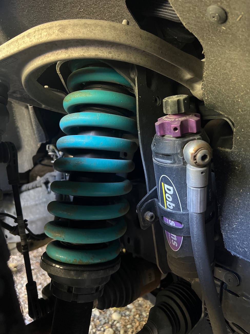

If he has the remote resis, shoudl be the MRR. Im running IMS though! I love it so far, Shock SUrplus should have a video coming out soon on it.

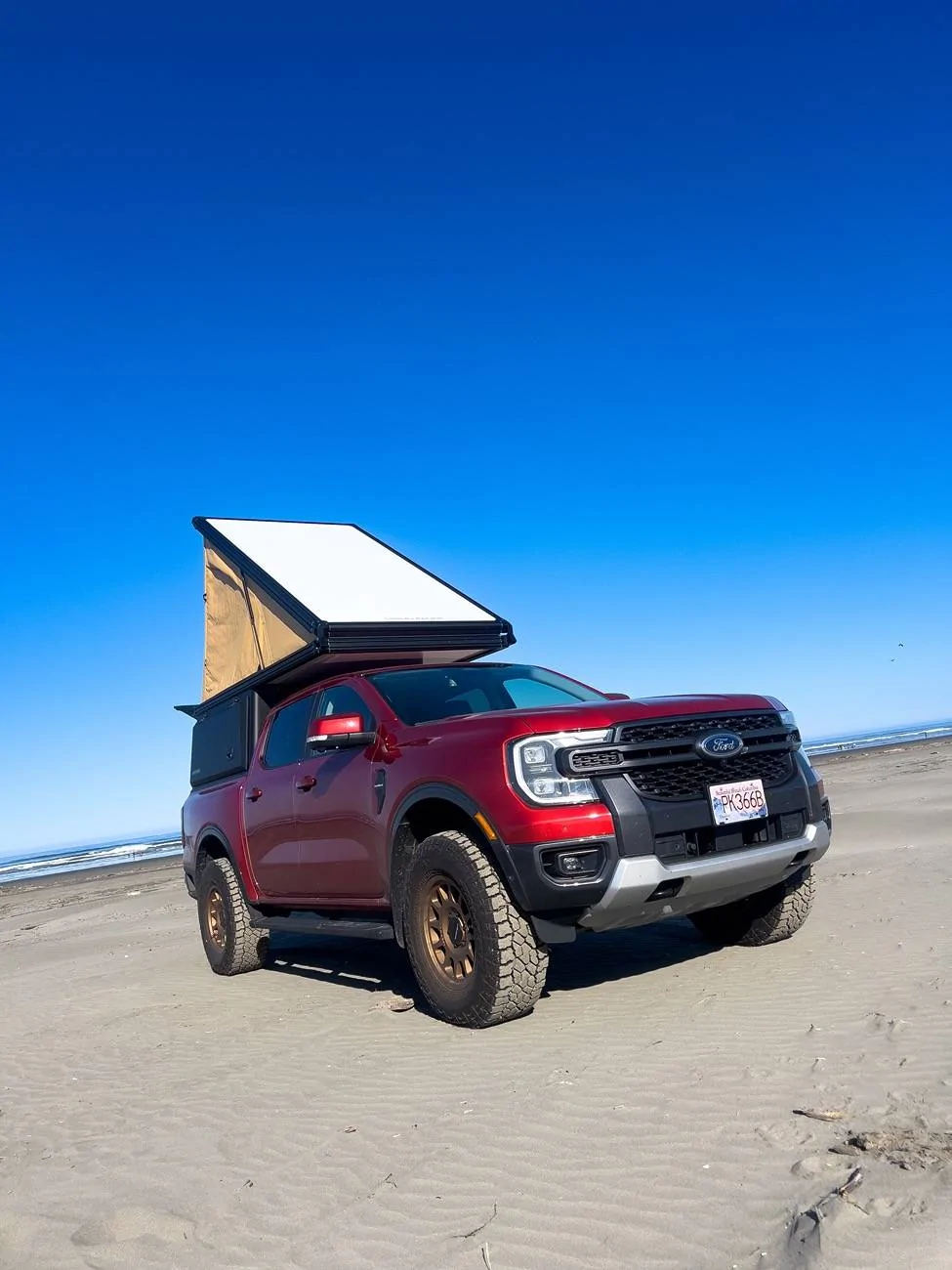

Build is coming together.
Dobinsons full lift kit with remote res shocks.
Method wheels with 275/70/17 Wildpeak AT4W
Super Pacific X1 Camper Black with Tan
Did you get the Dobs leaves too? I just did shocks in the back.

Correct yes, MRR.
currently running stock leafs with block, but have the Dobinsons leafs at home ready to go on. Was just waiting for the camper to be installed. Rear leafs are same as previous gen I believe.

Rear leafs are now on. They are the 600lb option, the Super Pacific alone weighs around 320lbs. I will say this... the truck now rides better than stock. You do not notice the weight of the camper in ride or handling whatsoever, the only difference is in the fuel economy.
The full Dobinsons MRR setup is well worth the money, we can still do some further dialling in of the shocks to get it even better I am sure.

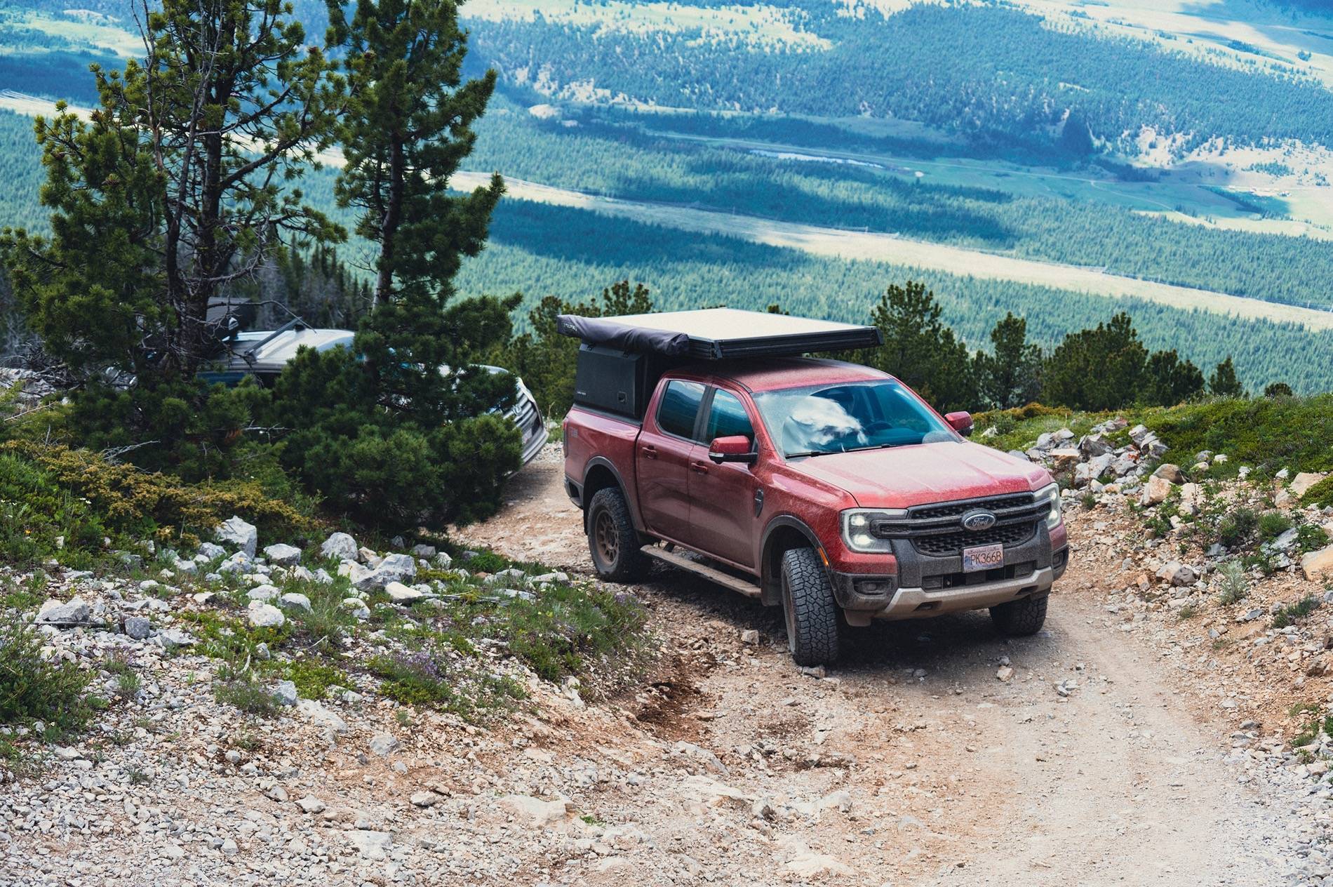

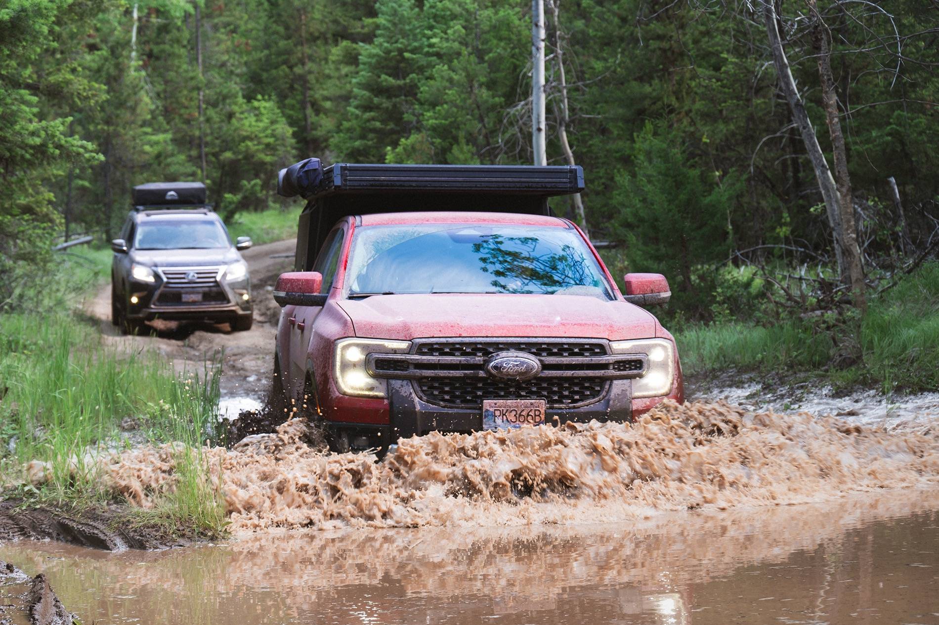

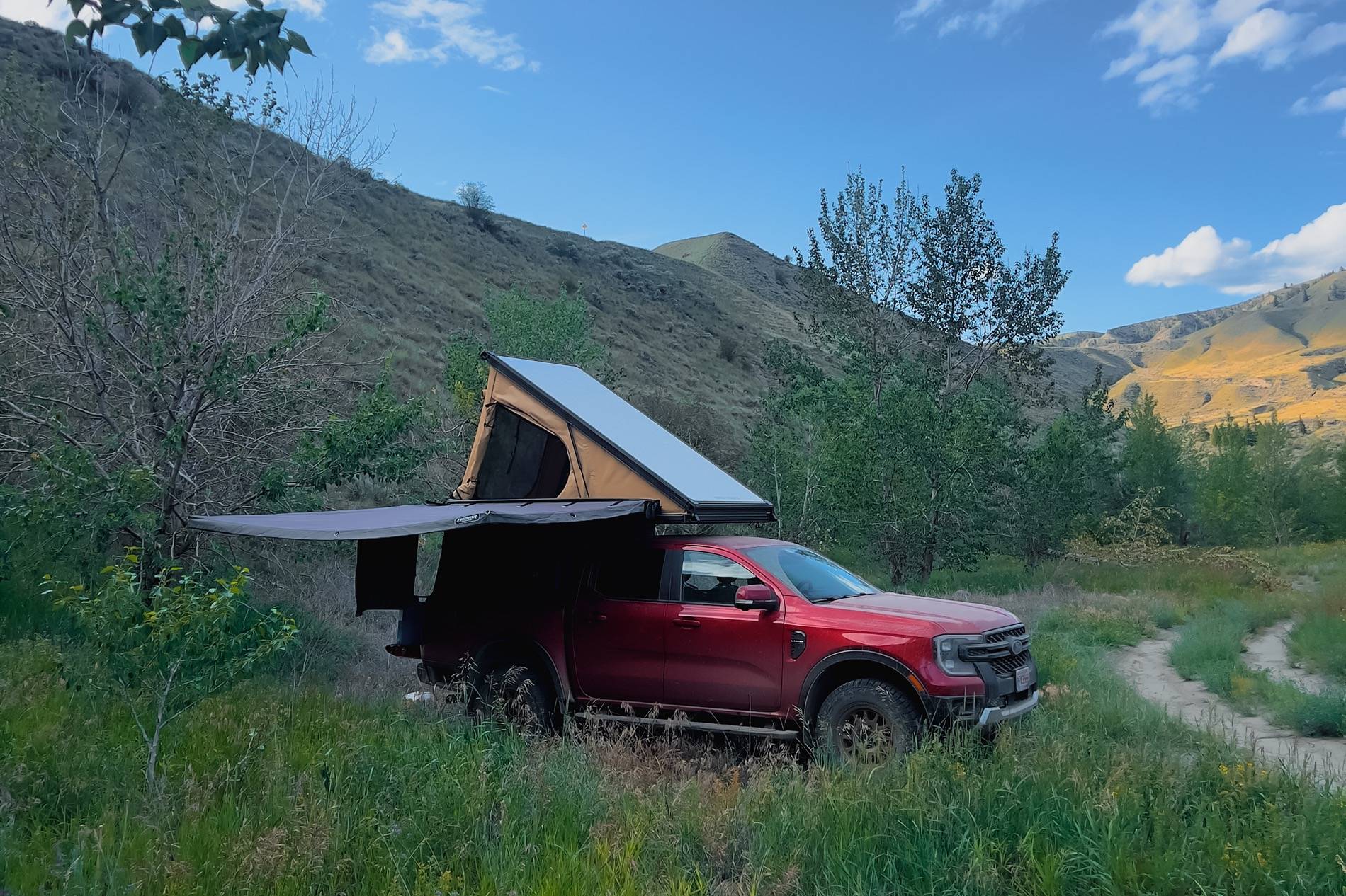

Took it for its first real off road outing after dialling in the suspension.
Mod List:
Camper: Super Pacific X1
Wheels: Method 703 Bronze +35mm
Tires: Falken Wildpeak AT4W 275/70/17
Suspension: Dobinsons 2-3" MRR 3-Way Adjustable Lift Kit
Awning Freespirit 270 degree
