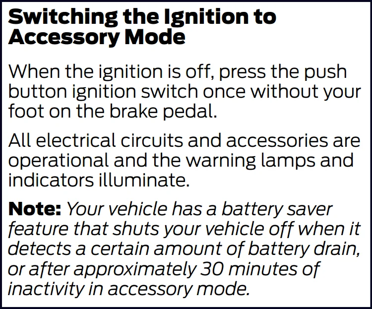

So while waiting for baseball practice to end, I was reading through the abbreviated owner's manual and now I am confused. On page 57, it states that the truck will automatically shutoff after 30 minutes. Does that mean if the engine running it will shut off, or would that also cover my scenario where I turned on auxiliary but not the engine? If the latter, then I am confused why my battery died.

Yes, most modern vehicles will automatically shut everything off after a pre-determined time if the engine is off. I wonder if it was just a case of your battery sitting for a long time prior to purchase and the drive home wasn't enough to get it charged enough. The parasitic loads on these is fairly high, as it is with most modern vehicles, and many of us who don't drive ours daily keep them on a maintenance charger.
Also, I don't remember if the key fob has a motion sensor. If not, and you leave it in the vehicle, there will be additional electrical draw as it will keep the security module in "ready" mode so I've read.
