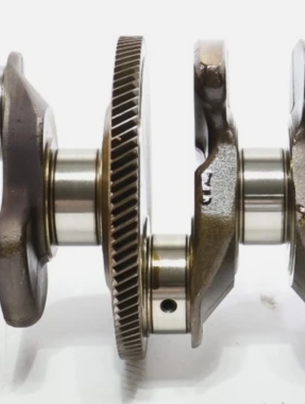

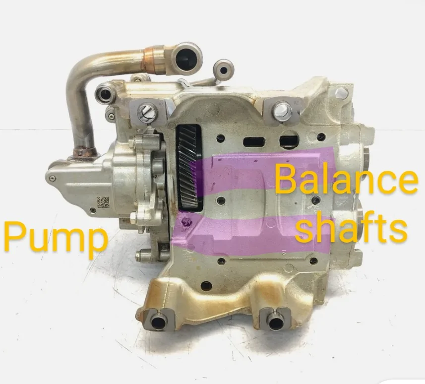

I've seen this information wrong all over the web even stupid AI, so thought I'd give pictures of the drive type for all to see.
The 2.3l oil pump is Not chain driven. It is gear driven directly off crankshaft. This changed in 2020 in explorer 2.3l and 2024 and engine was even given a longer stroke than previous versions.
Ford Ranger 2.3L Oil Pump Drive Clarification OilPum
Ford Ranger 2.3L Oil Pump Drive Clarification PumpLayout
Ford Ranger 2.3L Oil Pump Drive Clarification CrankGearOilPum

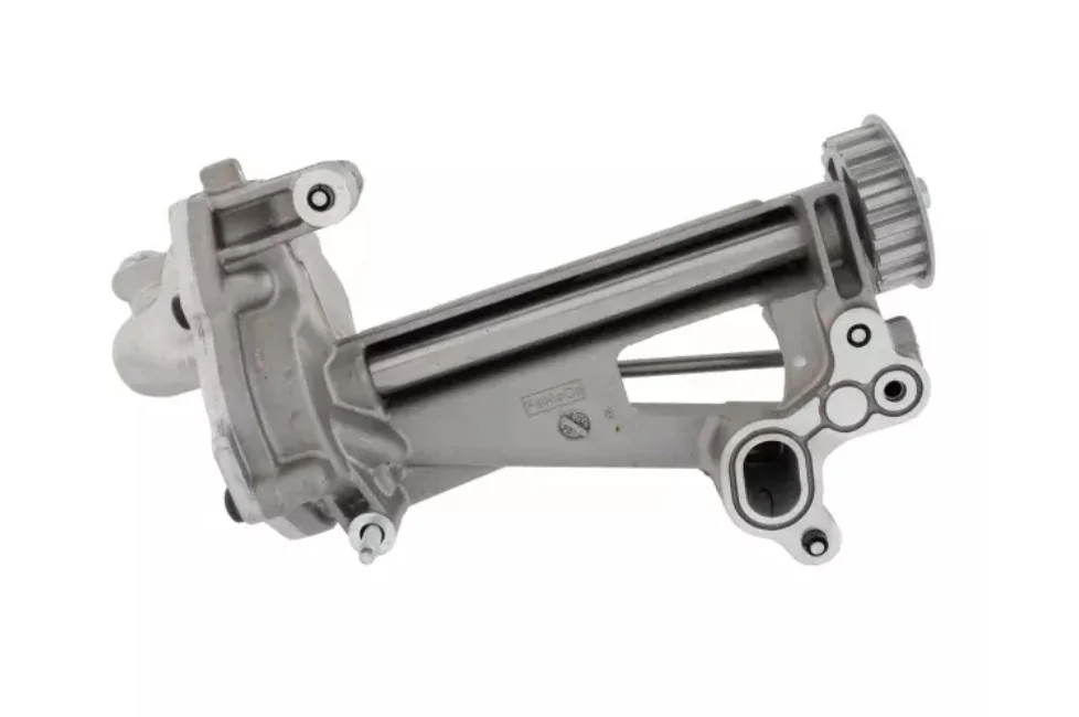

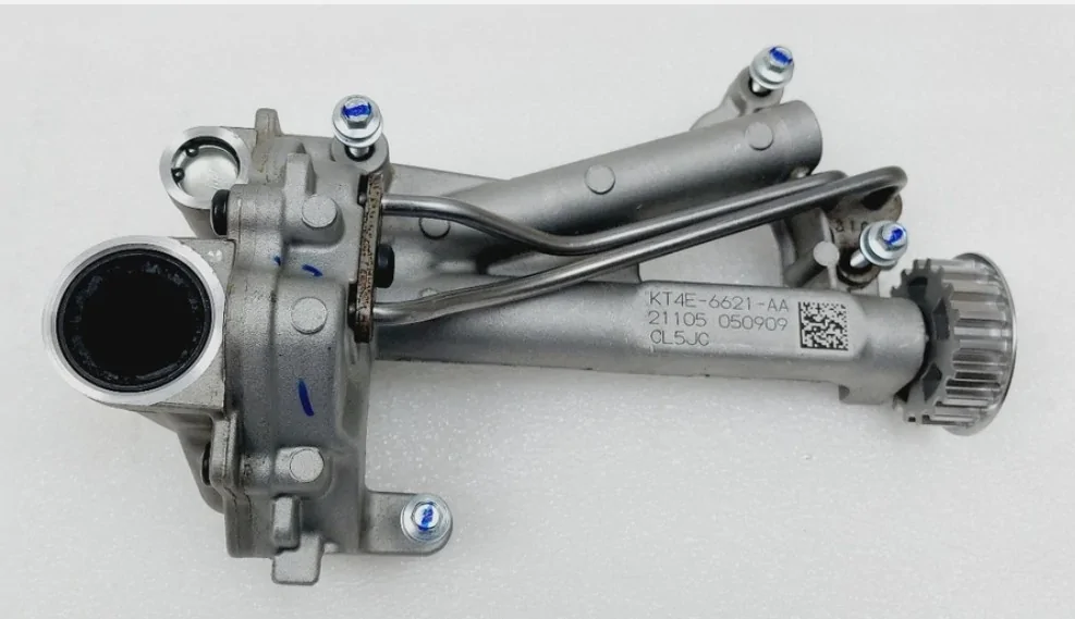

We've seen that the Rangers 2.7l and 3.0l is belt driven off gear cog drive on end of crankshaft. :like:
Ford Ranger 2.3L Oil Pump Drive Clarification oilpumpbelt
Ford Ranger 2.3L Oil Pump Drive Clarification 2.7]3.0pump1
Ford Ranger 2.3L Oil Pump Drive Clarification 2.7]3.0pump2

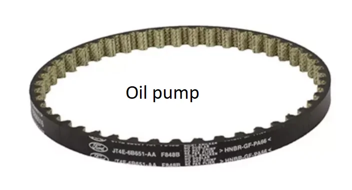

Did Ford engineers upgrade the oil pump belt at any time? I wonder if Kevlar would work in a prolonged oil bath without degrading? If it did, some company like Agrobelt could manufacture those belts to Ford spec.
4,075
3,958
in the other thread about that belt, someone already found it is kevlar and that is why there have been almost 0 failures in the millions of miles the f150s have put on those engines and belts
Normally if the part number changes it is a design change of some kind. I don't see the number change from 2018 to 2025 in parts search.
