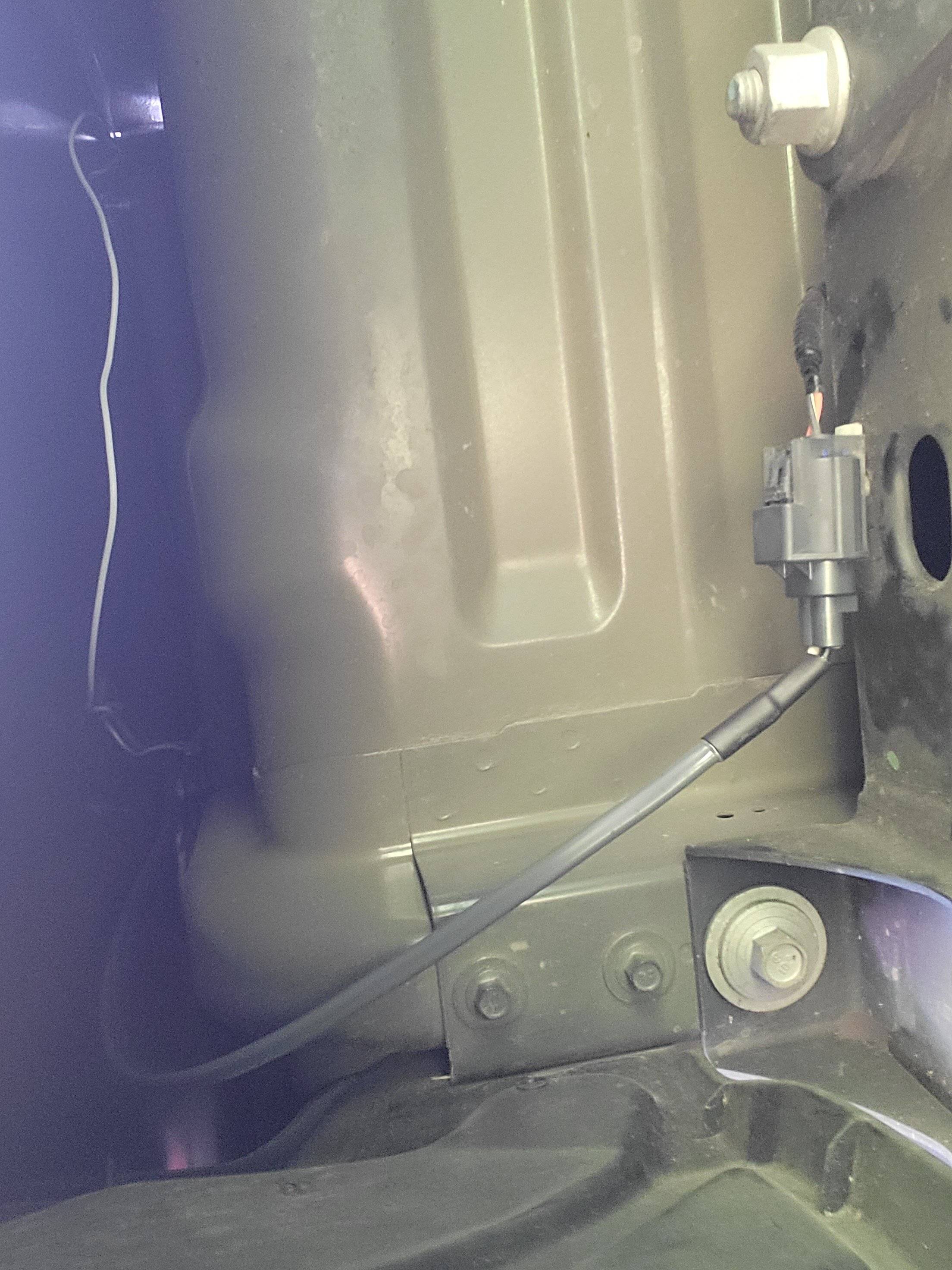

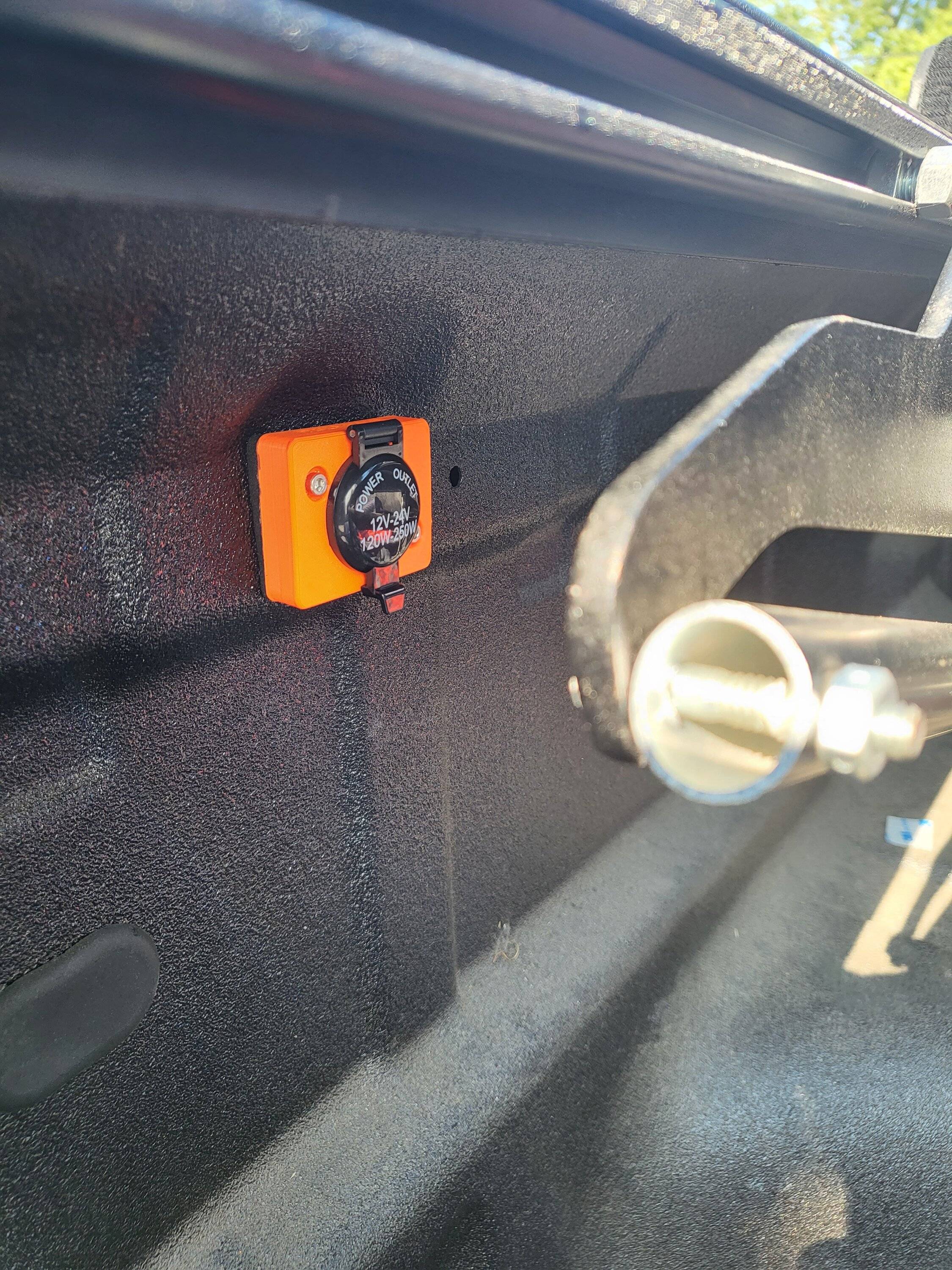

Not the biggest mod in the world but so crazy that a Ranger owner saw a need and created his own company to fill that for the rest of us. I had no idea how easy it was to add power to the bed with the connector that Ford had already built in right behind the LR tire. Literally less than a 5-minute job!
We have lots of charging needs for our bikes, from helmets to lights, and our back seat was always a mess. Ordered the standard 12V cig lighter option ($60) and moved everything to a small bin that sits right in front of my bed extender. No more cluttered back seat.

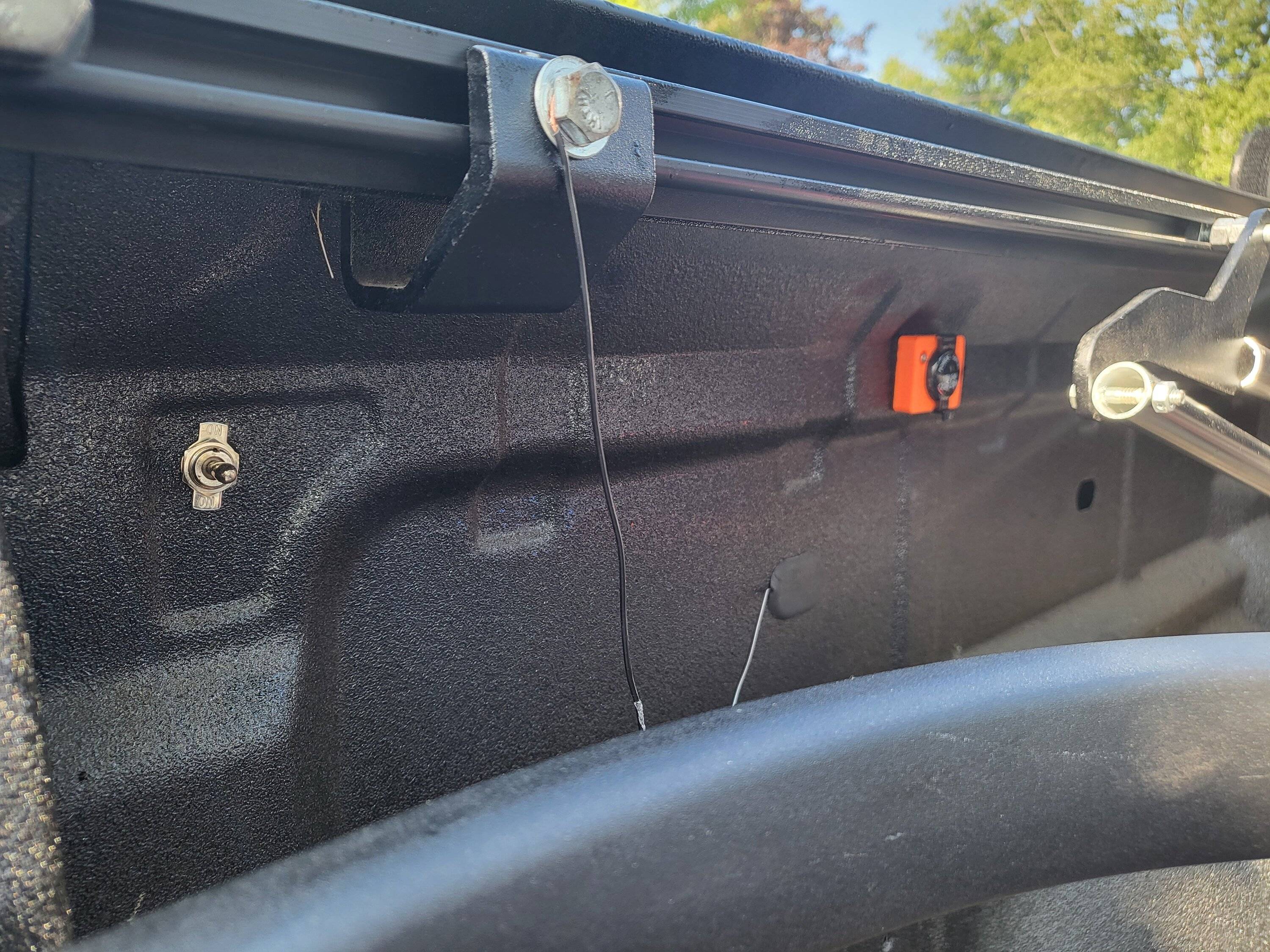

I also wanted bed lighting so I tapped into the hot wire on the Wolf Haus unit and added a decent enough set from WM for about $25. They looked great. For an hour. Unfortunately, the sticky pads don't stick to the spray-on bed liner too well so I'll be putting some wire supports in tomorrow.

12V outlet, mounted to driver's side of bed.
Ford Ranger Added the Wolf Haus power (and lighting) to the bed 20230828_103231
Connector located behind left rear tire. Wire coming into it is from 12V adapter and simply drops through hole in bed.
Ford Ranger Added the Wolf Haus power (and lighting) to the bed 20230828_103454
On-off switch for under-bed lights.
Ford Ranger Added the Wolf Haus power (and lighting) to the bed 20230828_103255

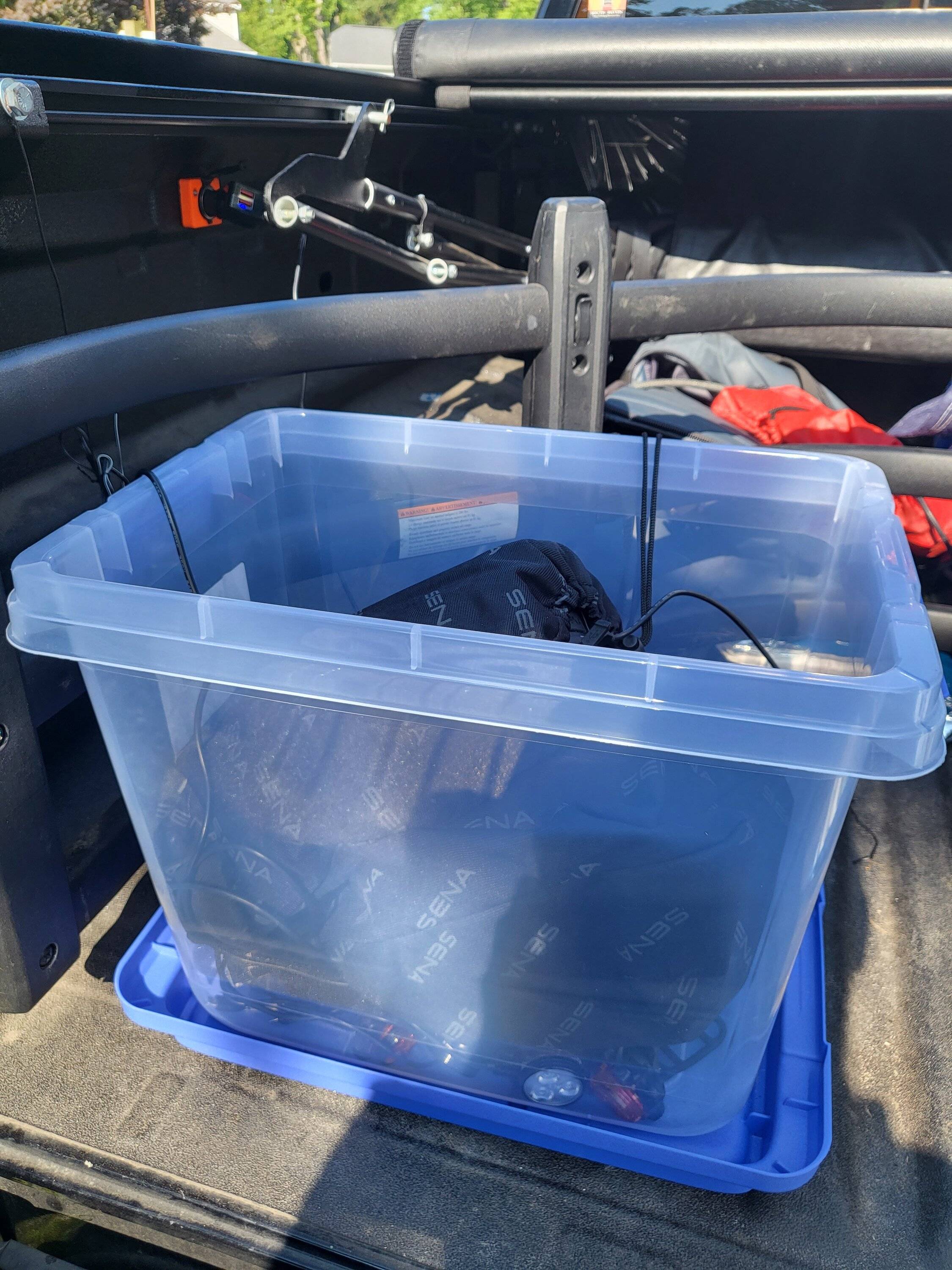

Bucket with helmets and lights, charged and ready for next ride.
Ford Ranger Added the Wolf Haus power (and lighting) to the bed 20230828_103557
