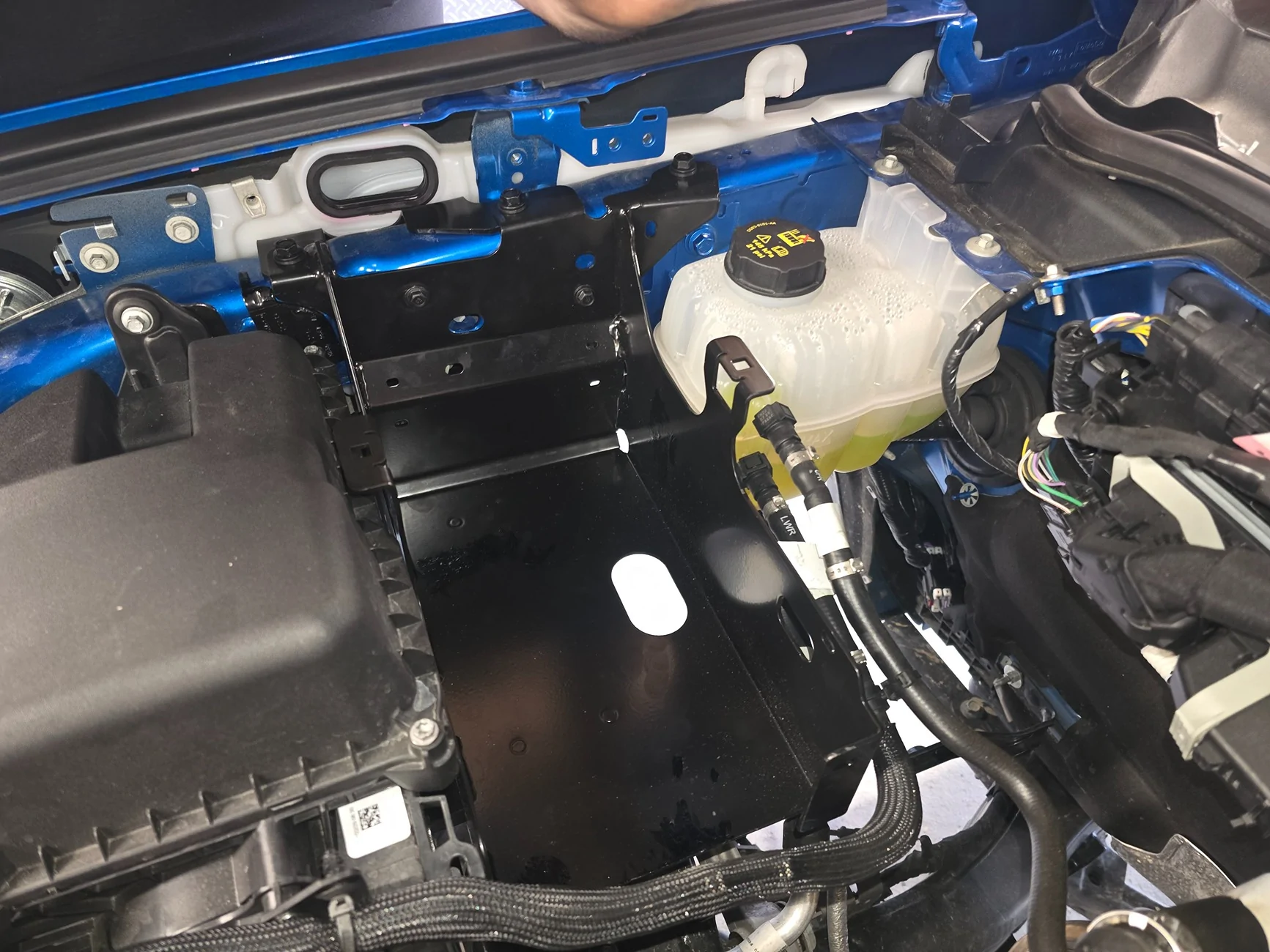

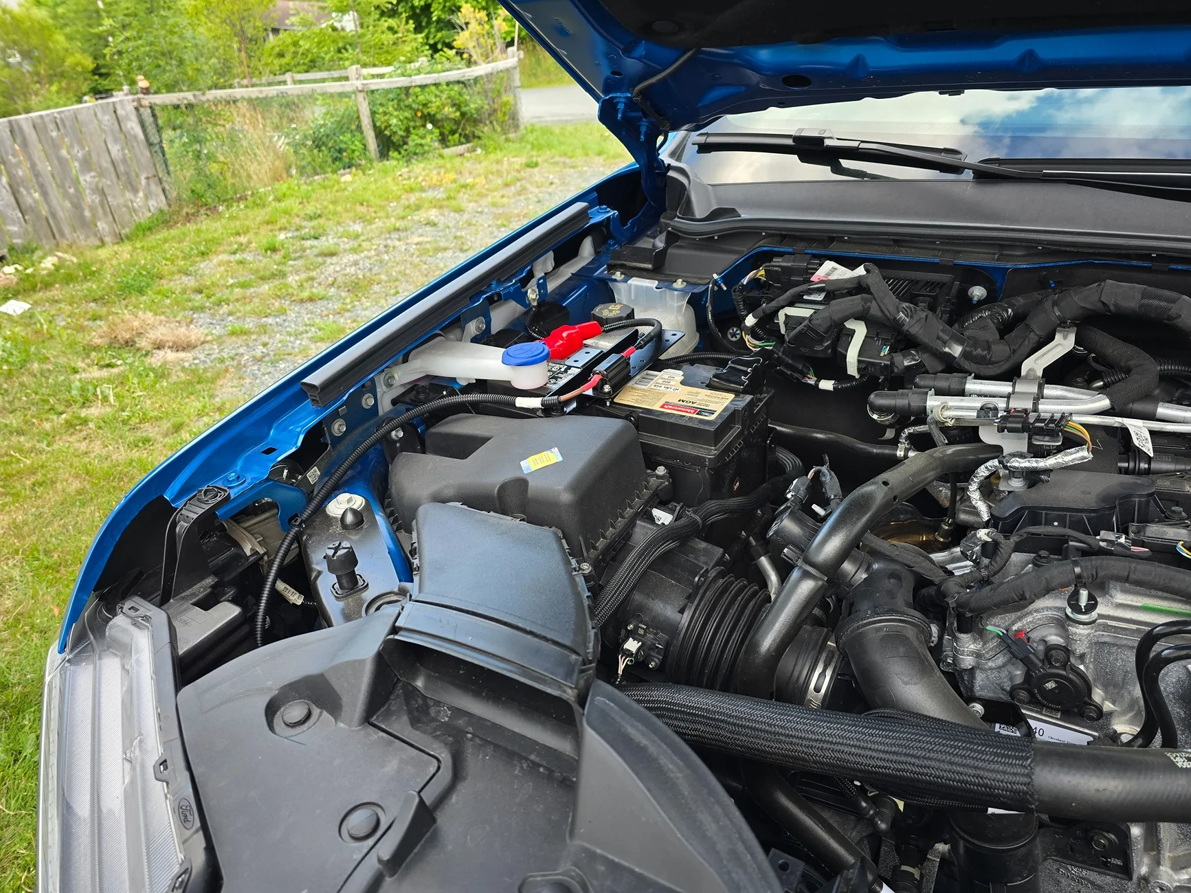

I ordered the ARB dual battery kit from Australia to canada for my 25 xlt. its ford and arb designed. and ford approved. it includes I believe a 25 am dc-dc charger for the battery. I installed another battery same as truck has, for now it was the more economical option for me. but the dc-dc does have LiFePO4 profile to charge on it aswell. was a nice kit. Im sure you could buy just the redarc dc-dc charger and run your own wires to the trailer.

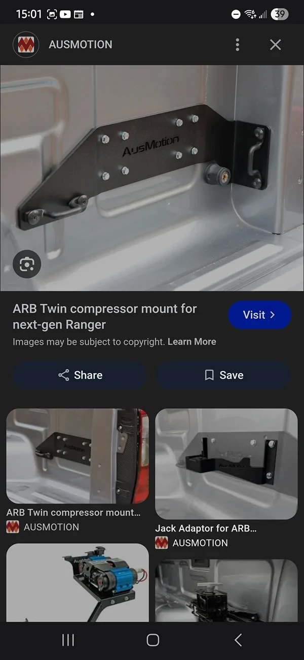

Why thank you. next on the list besides diode dynamics new stage light bars when they come out, and the arb bed miunted compressor, is a set of clearview tow mirrors(I did just find a set of f150 style tow mirrors, available for preorder from the UK) the clearview's are like ARB stuff down in aussie land. ford partnered with them to design oem add ons, and you can order your truck from factory with this stuff on...

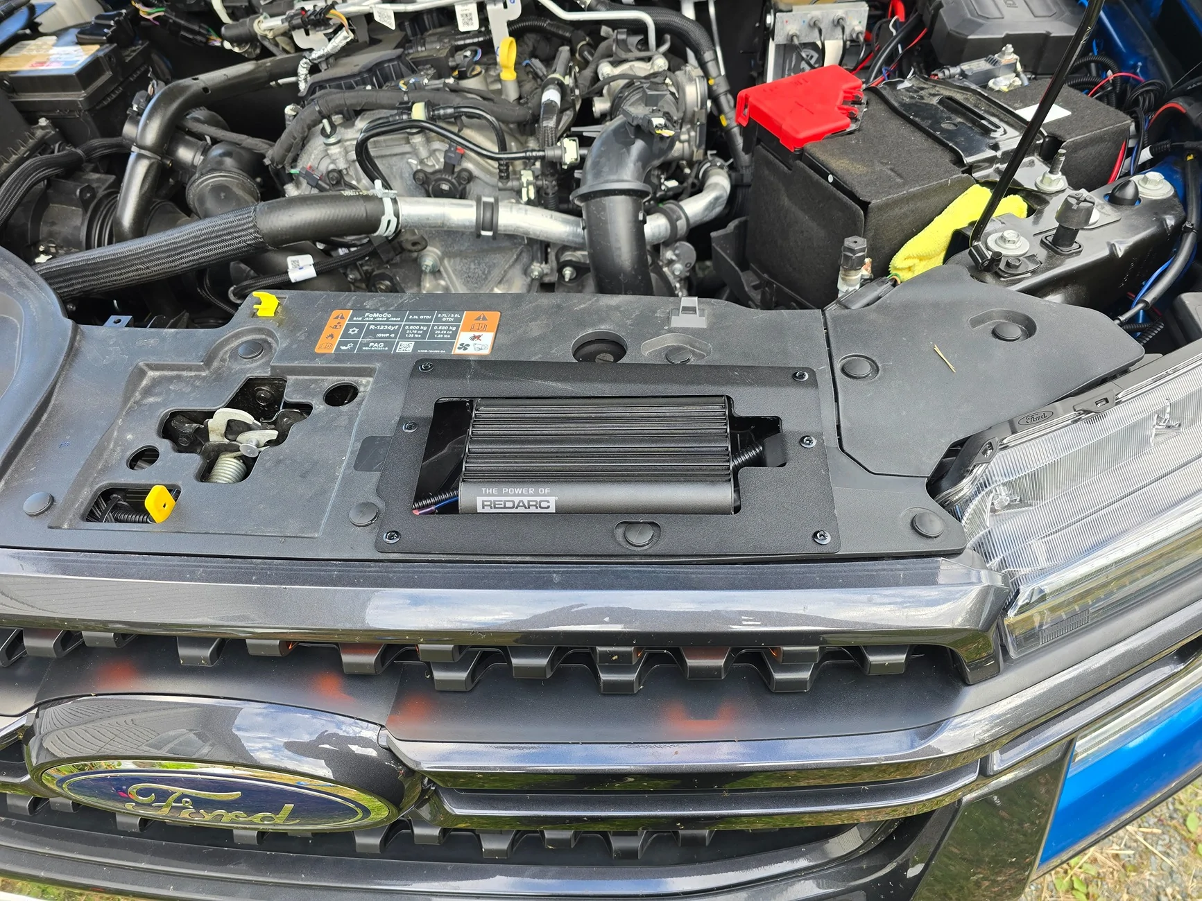

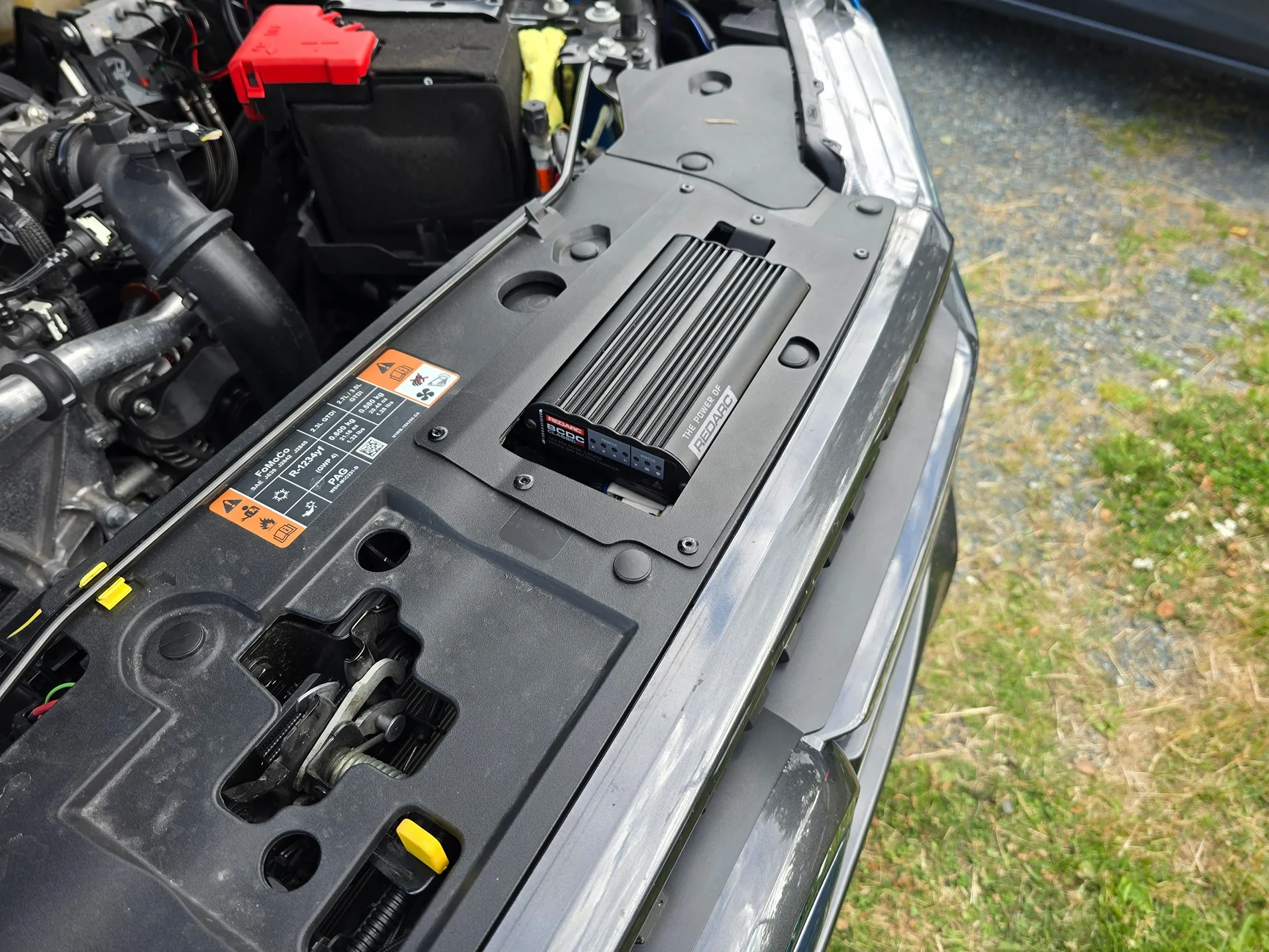

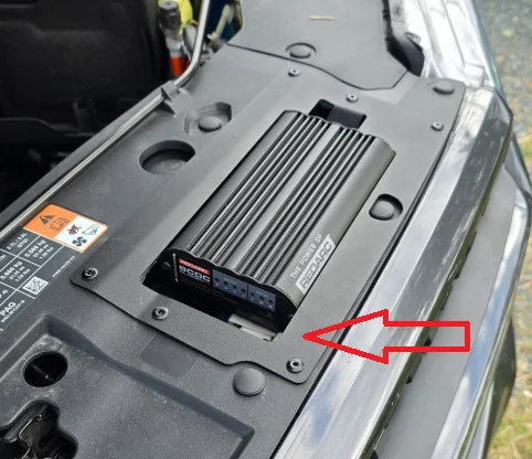

Tyler, more I study this 2cd battery setup more I want! Curious about this part (red arrow pointing to it). That didn't come with the ARB Dual Battery kit did it? Looks like a great place for the DC-DC charger. You ordered from Australia...think my local dealer could order that here in Tennessee? Reason I just asked, I recently tried to order something from Australia and the guy (ETSY purchase) wrote back and said he couldn't ship to the U.S. right now....tariffs

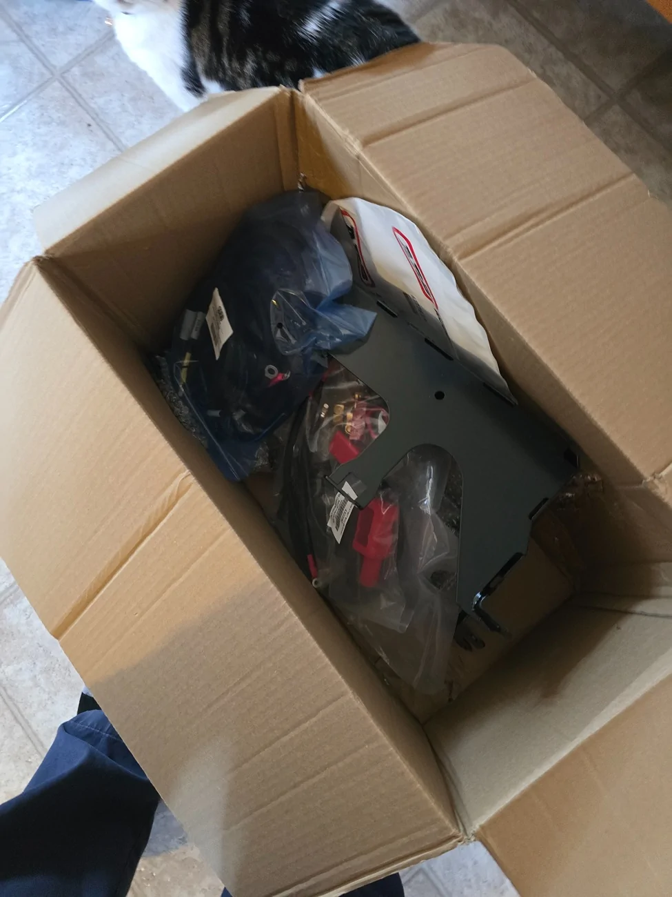

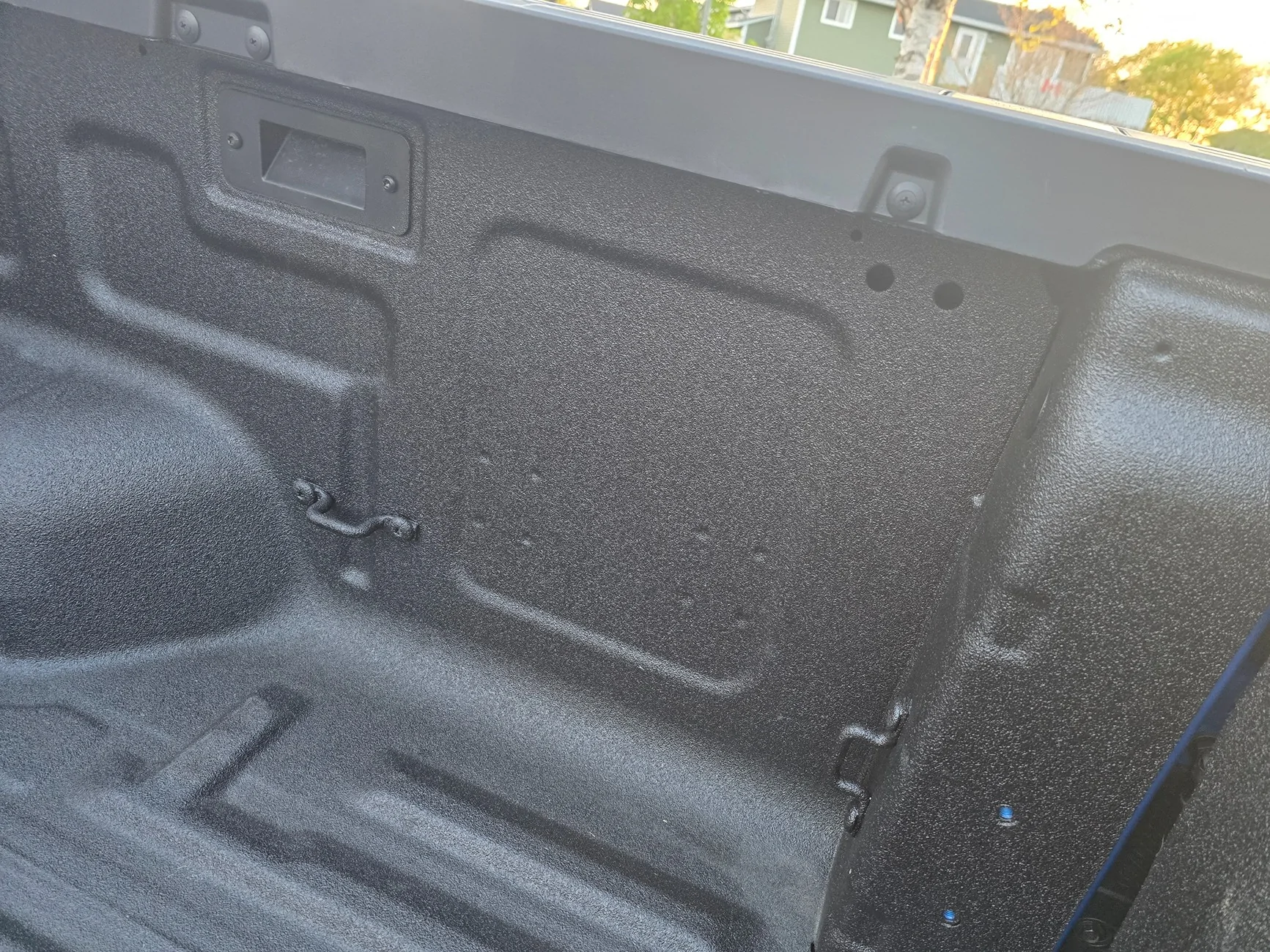

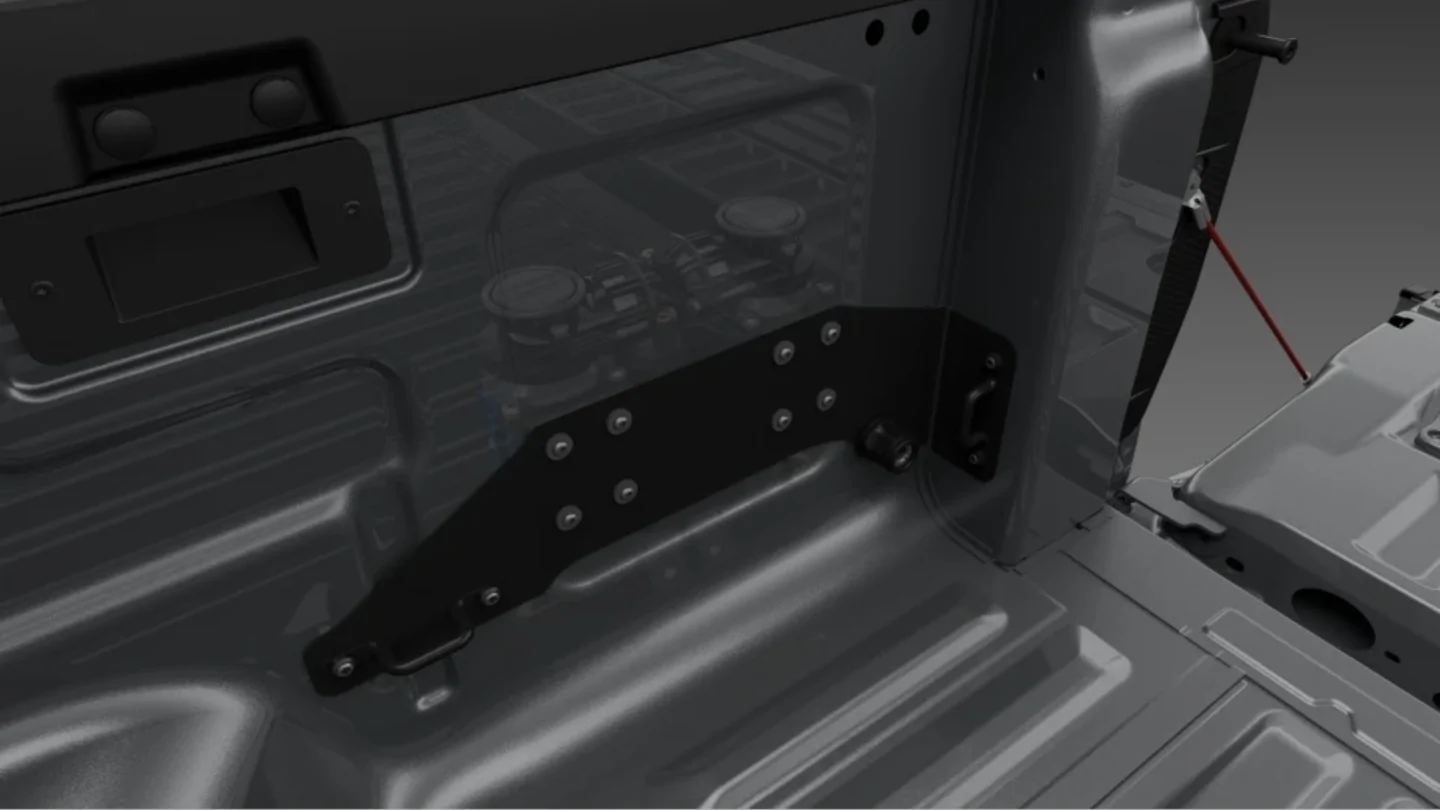

ARB does not sell the next gen ranger dual battery kit in North America. You will not be able to order it. I also ordered from a busniess BPT Motorsport, not soneone on etsy, but you maybe able to order from the UK? cheeper tarrifs for you I think. Everything you need is in the kit besides the 2nd battery and the tools required. all hardware, wiring, charger, brackets, template to cut, instructions. etc are all there. also the picture of the open box, I took out the bubble packets
ARB-4340130 is the kit part #.

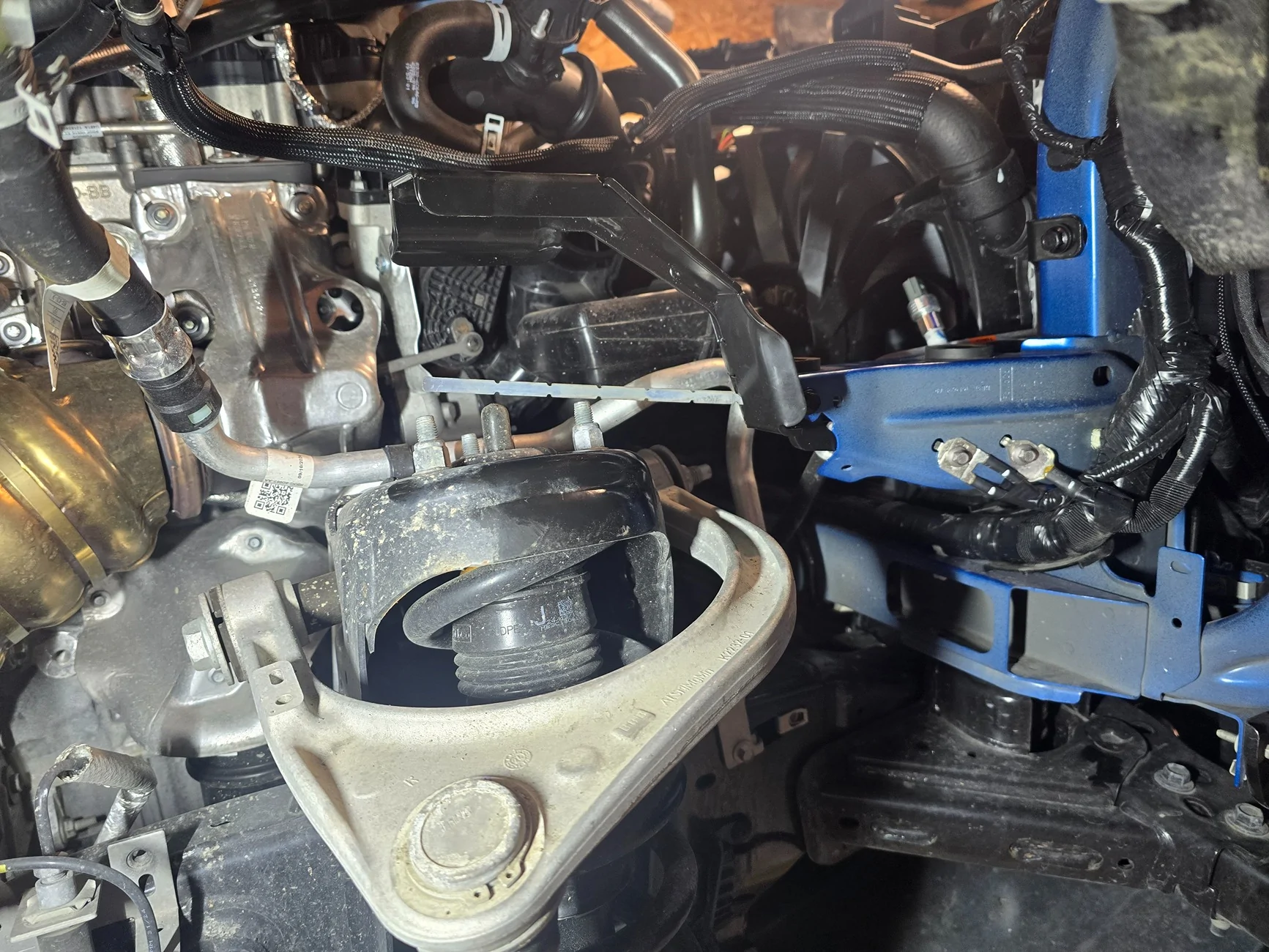

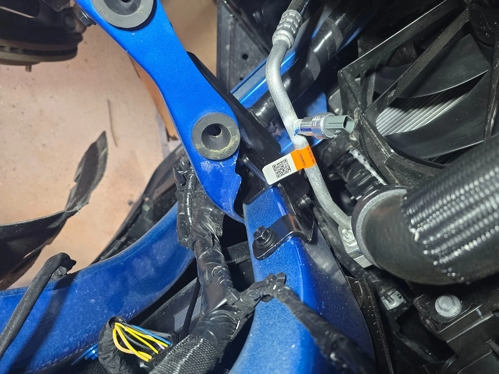

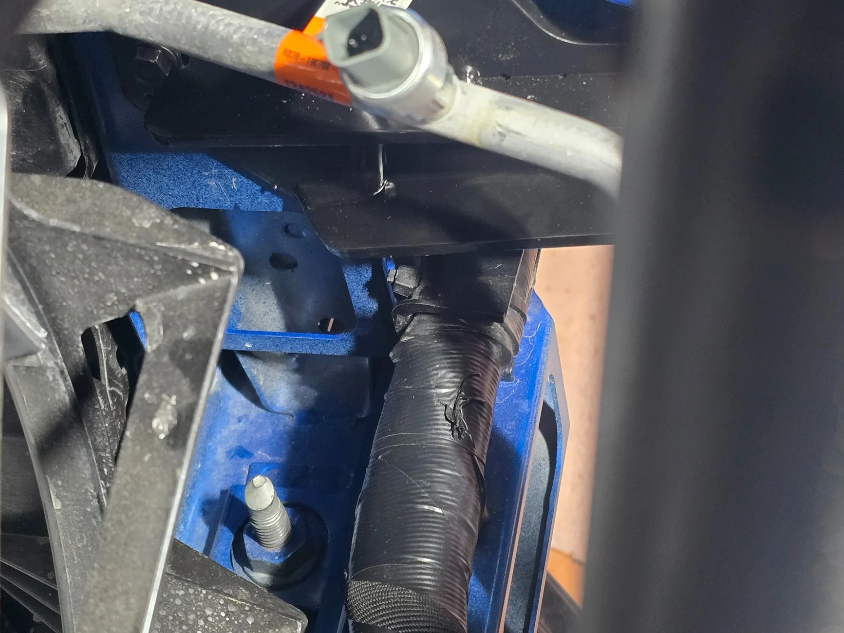

Ford Ranger Alternator size/amps ?? 20250707_191020
Ford Ranger Alternator size/amps ?? 20250707_185511
Ford Ranger Alternator size/amps ?? 20250713_143152
Ford Ranger Alternator size/amps ?? 20250713_143142
Ford Ranger Alternator size/amps ?? 20250713_143204
Ford Ranger Alternator size/amps ?? 20250713_164625
Ford Ranger Alternator size/amps ?? 20250713_164636
Ford Ranger Alternator size/amps ?? 20250724_130711
