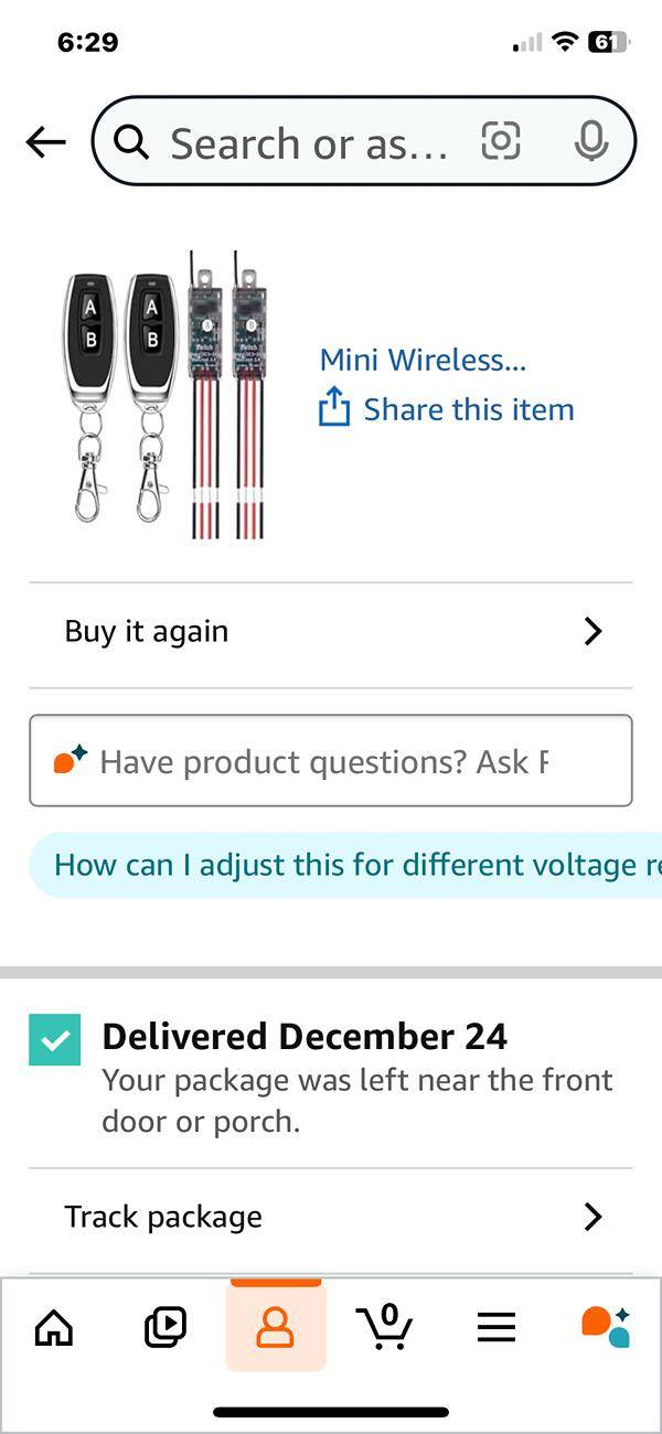

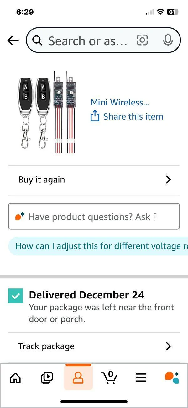

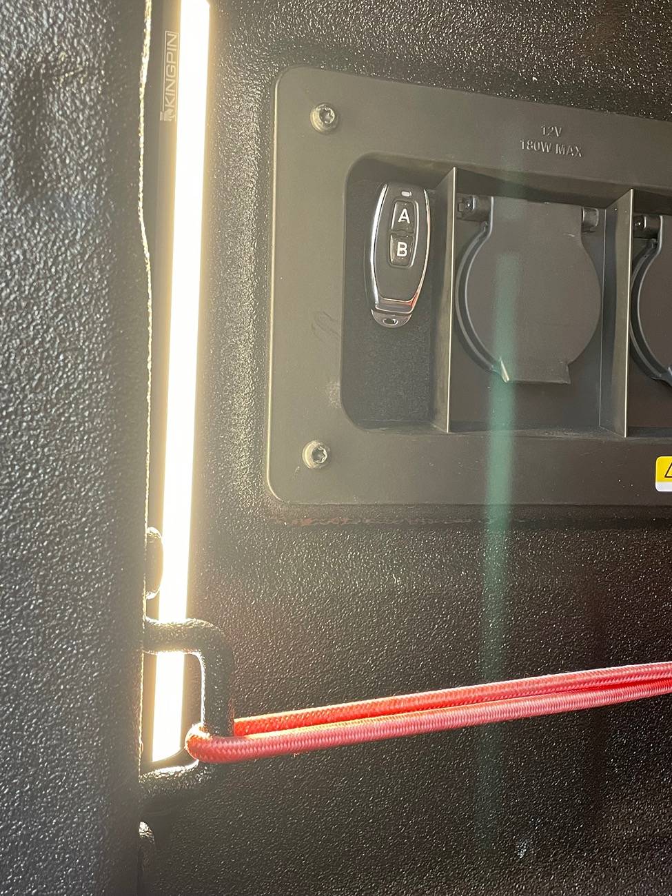

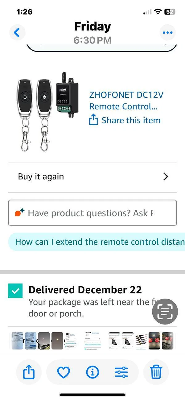

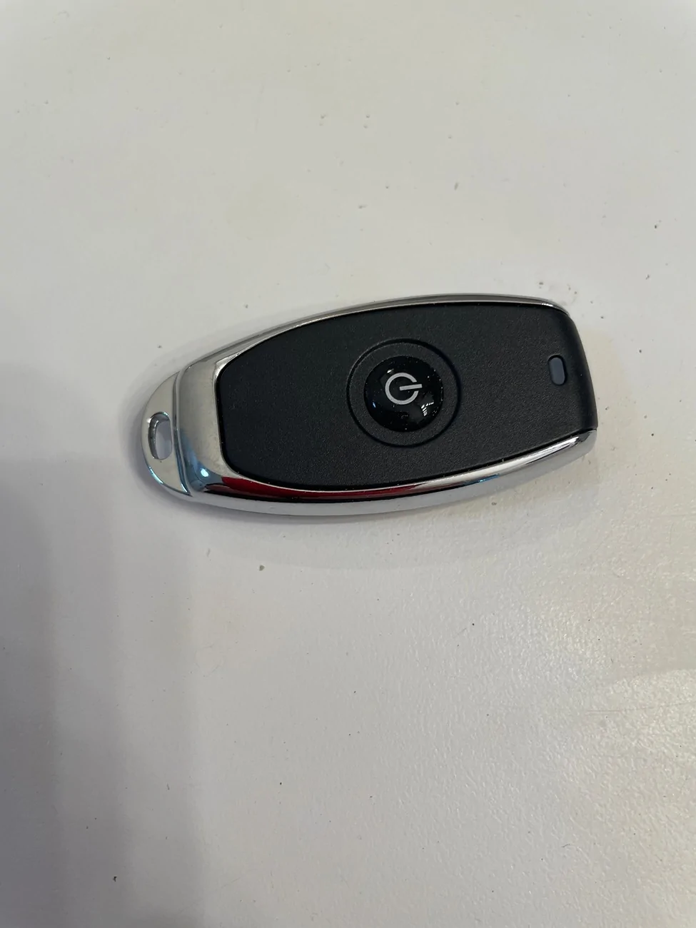

I gave up trying to get it to work with the factory wiring, I built harnesses and wired my bed lights, puddle lights and bedside step lights together. They all connect to the battery and have a remote switch. The buttons are pretty small, I have one on my keychain, one mounted next to the power outlets in the bed and another in the little cubby next to the steering wheel.
