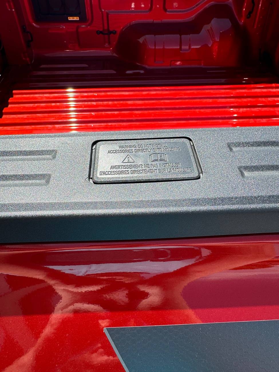

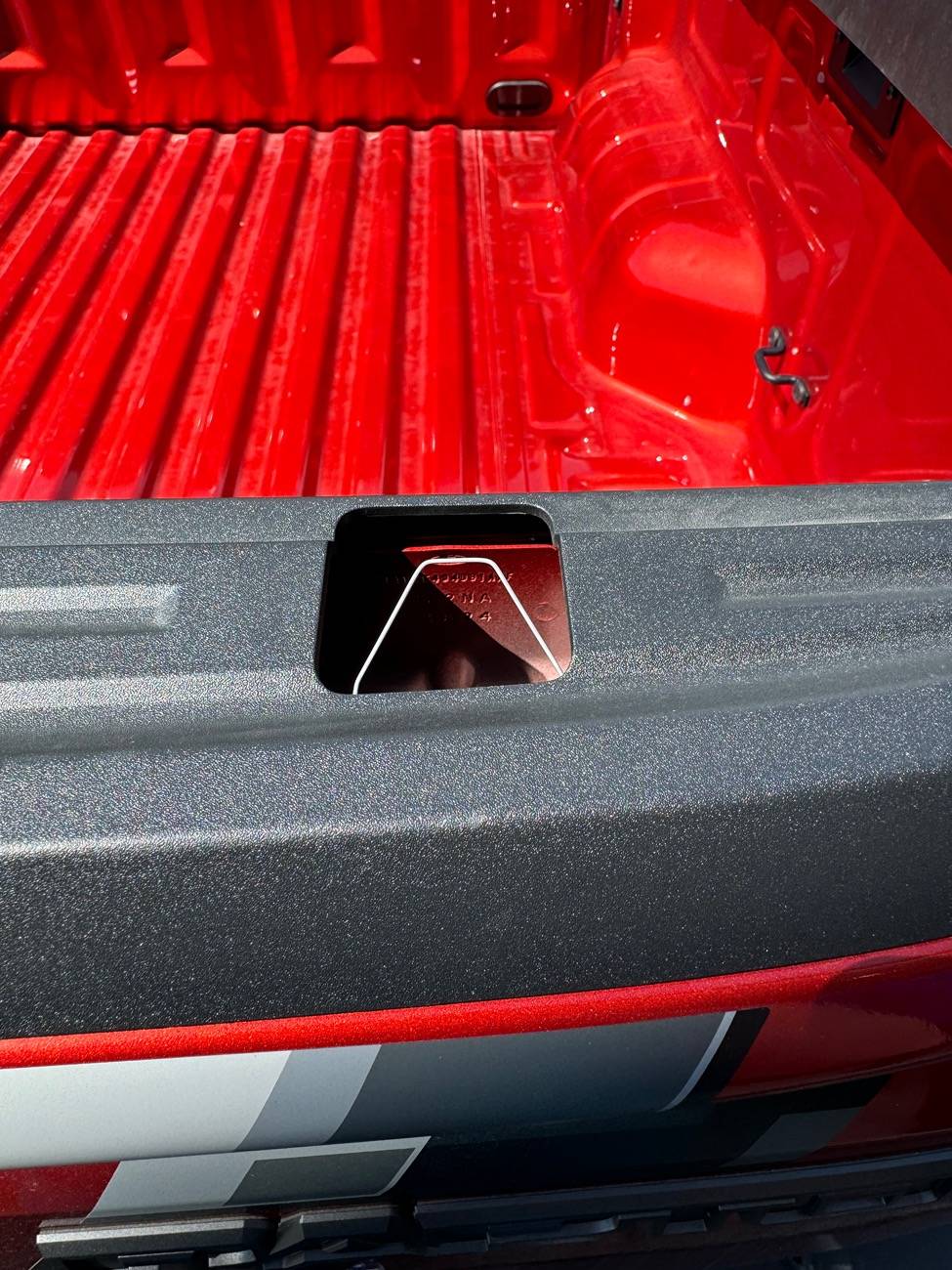

I bought a 2024 ranger raptor and it’s missing one of the little plastic bed rail caps. Would anyone have any extras they’d be willing to sell or part with? I’m also missing the plastic that goes over the clamps in the tailgate too. I went to a ford dealership and they couldn’t figure out if it was possible to order them.
Thanks

This came new like this? Make the dealer order them. Most likely tog et replacements they have to order the entire trim pieces.
Looking online, the reference number for the bed rail molding looks to be 29038A. They probably have to order the entire piece to get the covers.
N1WZ6029039AQ -left side
N1WZ6029038AP - right side
For the tailgate, 41018 - N1WZ6041018H (not confident that the covers for the clamp come with this.
