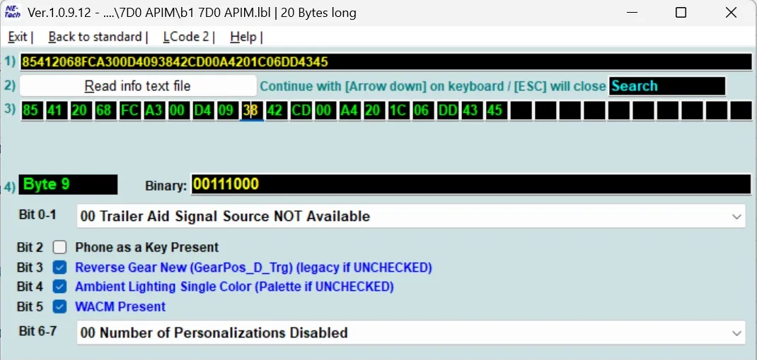

The vehicle would need to have an RFA module for PAAK (phone as a key) to be work. I believe the 2025 Rangers have an RFA, but not 100% sure.
Even if the hardware is there, it may not work if the firmware does not contain the events for PAAK in it. In the case of the Mach E and Lightnings, they were not able to enable PAAK until the certain OTA or FDRS updates were applied. It won't to try it. PAAK needs to be enabled here in the APIM to add the button to the touchscreen:
Ford Ranger Digital Key in Forscan 1770329028952-s0

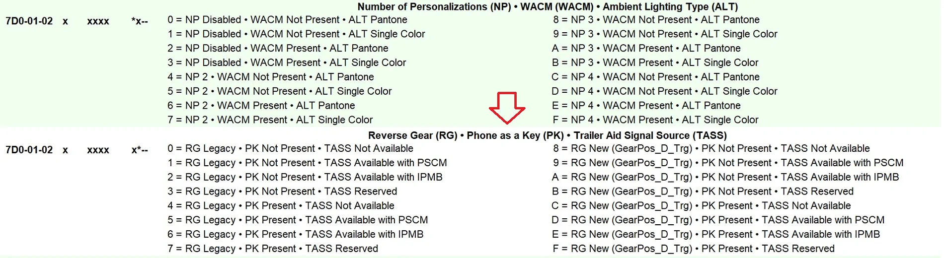

And here in the BCM to enable the feature itself.
Ford Ranger Digital Key in Forscan 1770329070053-1o
