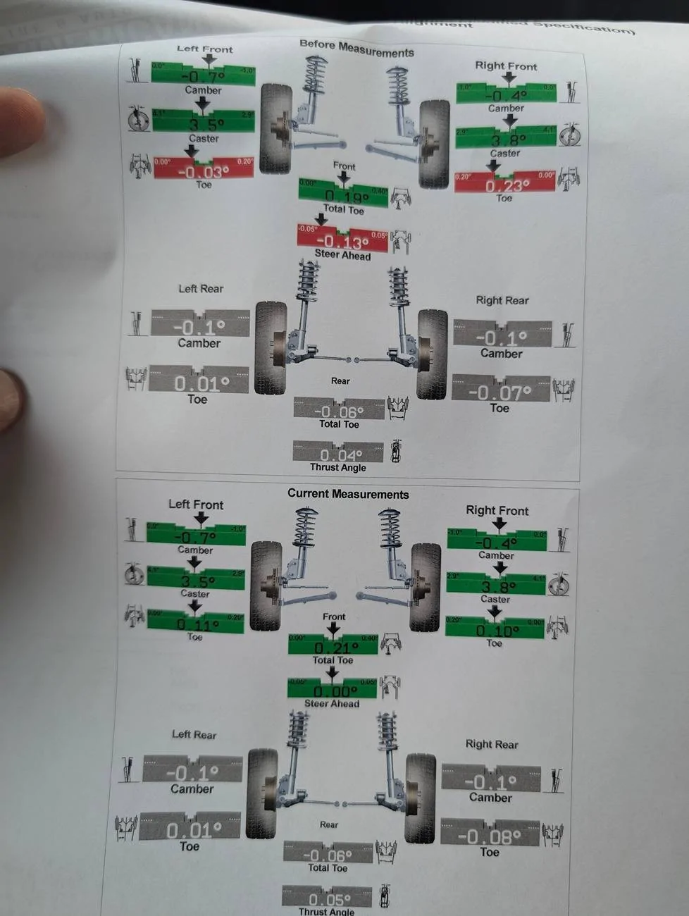

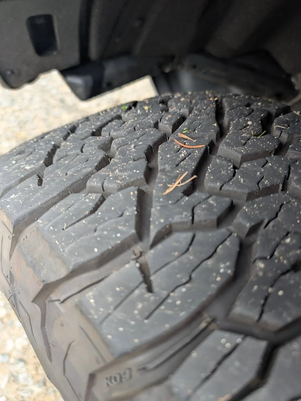

I finally got an alignment check after I started noticing feathering on my left front tire(see picture). I also decided I was tired of my steering wheel being off by like 5°.
Attached is the paperwork showing how off my toe was. Not only is the steering wheel straight now, but there is zero vibration at 70+mph. It's definitely a lot smoother from a steering feel.
I should have done this sooner.
