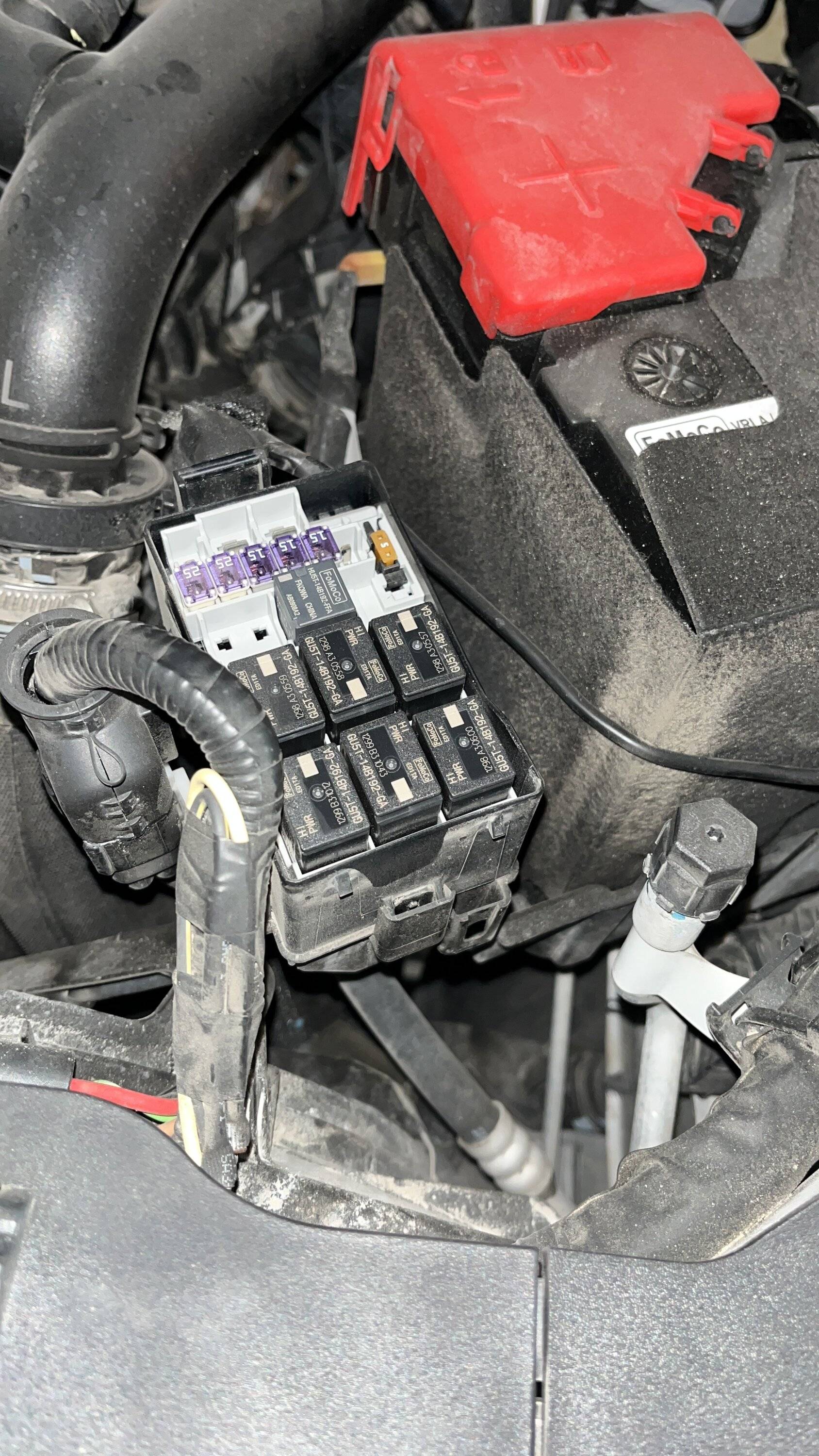

Looked in the engine bay today and found out the lid for my relay box was missing
Contacted my local dealer and they say there’s no part number for it and I should change the whole box. 320$ for the part only, no labour costs… seems rather excessive and would like to find and order the right part myself. Anyone knows where I can find that information !?
Chatted with Ford parts and they’re looking for the part number at the moment, but maybe you guys will be faster ?
pic attached for reference.
Thanks ??

I'd bet Ford probably used that relay box on other Rangers and other Fords. Ford sold enough late model Rangers that there are probably a few wrecks that ended up in salvage yards already. Your parts guy might also be able to cross reference that part to see what else uses that part.

@Ikevgriff has it Look at his post

Thanks for the replies guys !
managed to get a part from Ford (5L3Z-14A003-DA) that looks to be a perfect fit, hopefully.
I’m sorry @TurboRanger, I looked for the name you mentioned but didn’t find anything, would you mind sharing a link perhaps ? Could be useful should the replacement I ordered doesn’t fit.
