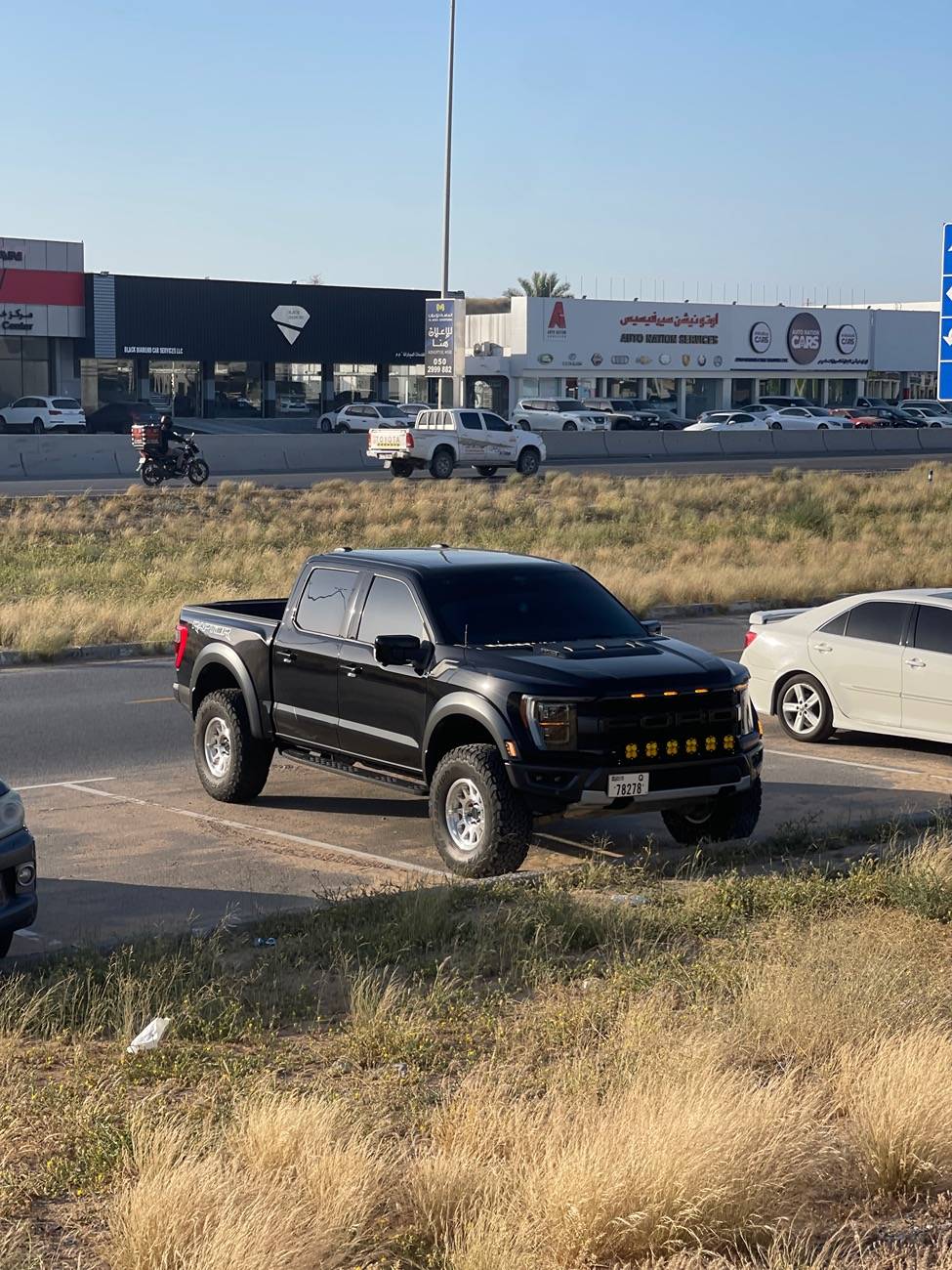

If Fox is coming out with a race spec 2.0 live valve it would come as a complete kit front and rear. But to answer your question, I run Fox Gen 2 race spec live valves coil over’s on my Gen 3 raptor and Eibach springs in the rear and it runs amazing.
