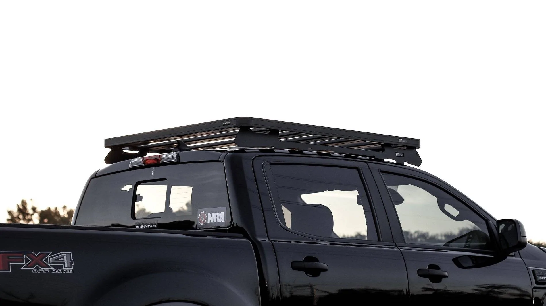

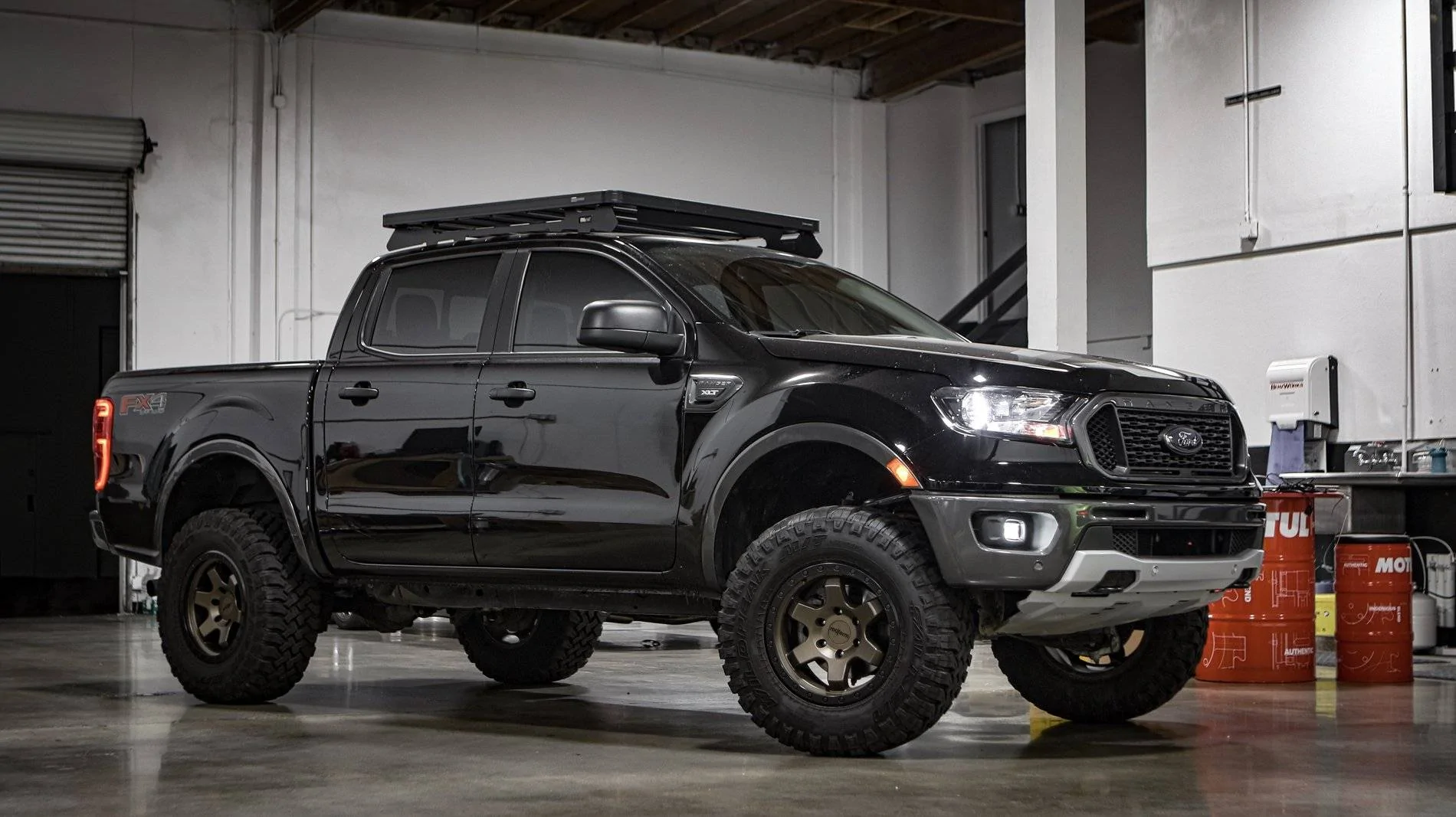

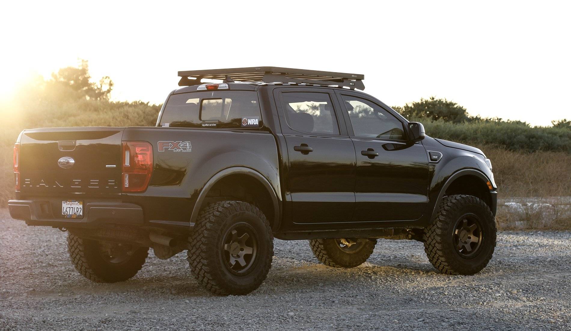

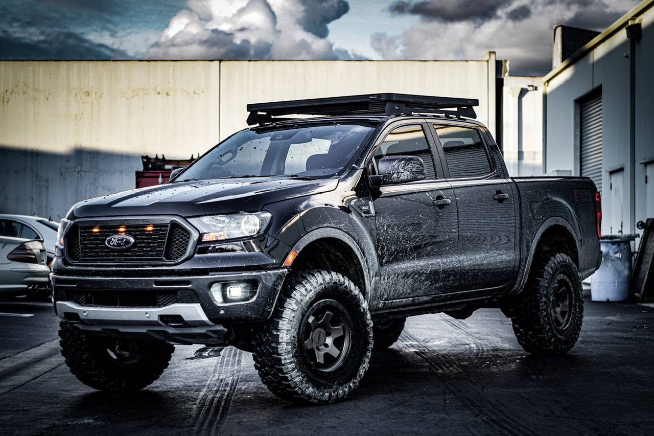

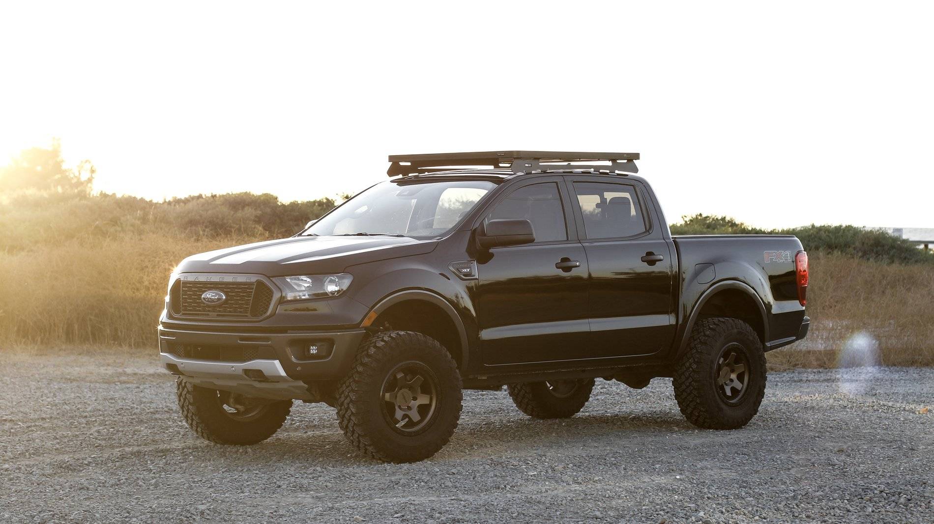

Alright I’m super pumped to share with you the naked rack ‍♂ Haha.
Ford Ranger His name is Steve McQueen 686F9BEB-6352-4F85-BAEC-9F20CF3ECF1D
Ford Ranger His name is Steve McQueen 01C0931A-0D36-43B8-9A03-CA29C7516212
Ford Ranger His name is Steve McQueen 62EF02D5-75F9-4C60-8D04-85C3A807D535
Frontrunner outfitters has started receiving their US version racks for all of us (cuz we all need storage space) and I’m really happy with the product.
Lights and some other off-road type accessories are coming soon, along with some big beefy 35” tires.

How is that mounted to the roof?

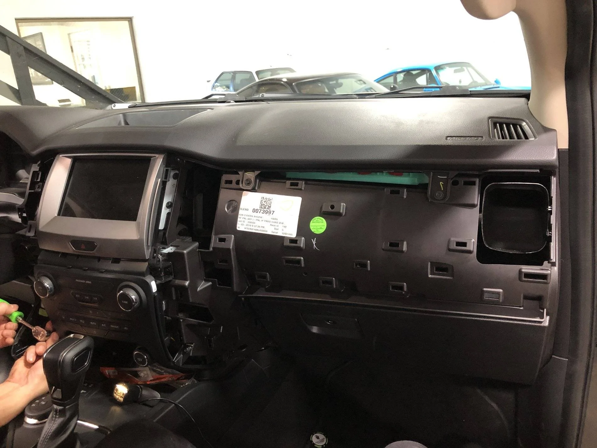

Installed a subwoofer in the truck this week. Thank goodness I have some ok quality sound now.

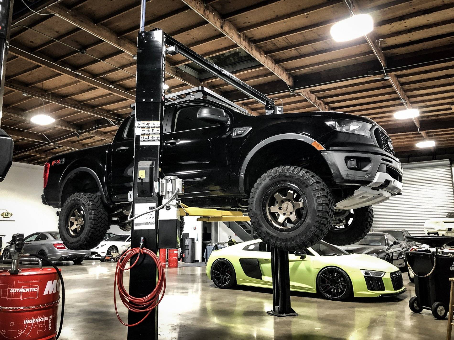

Its that time, 10,000 Mile service.
First things first I put this big boy up on the lift and inspected everything for damage/wear and tear. I didnt find anything alarming so I got started with the service.
Ford Ranger His name is Steve McQueen 6E8B0348-8406-4C56-A37E-65919475196F

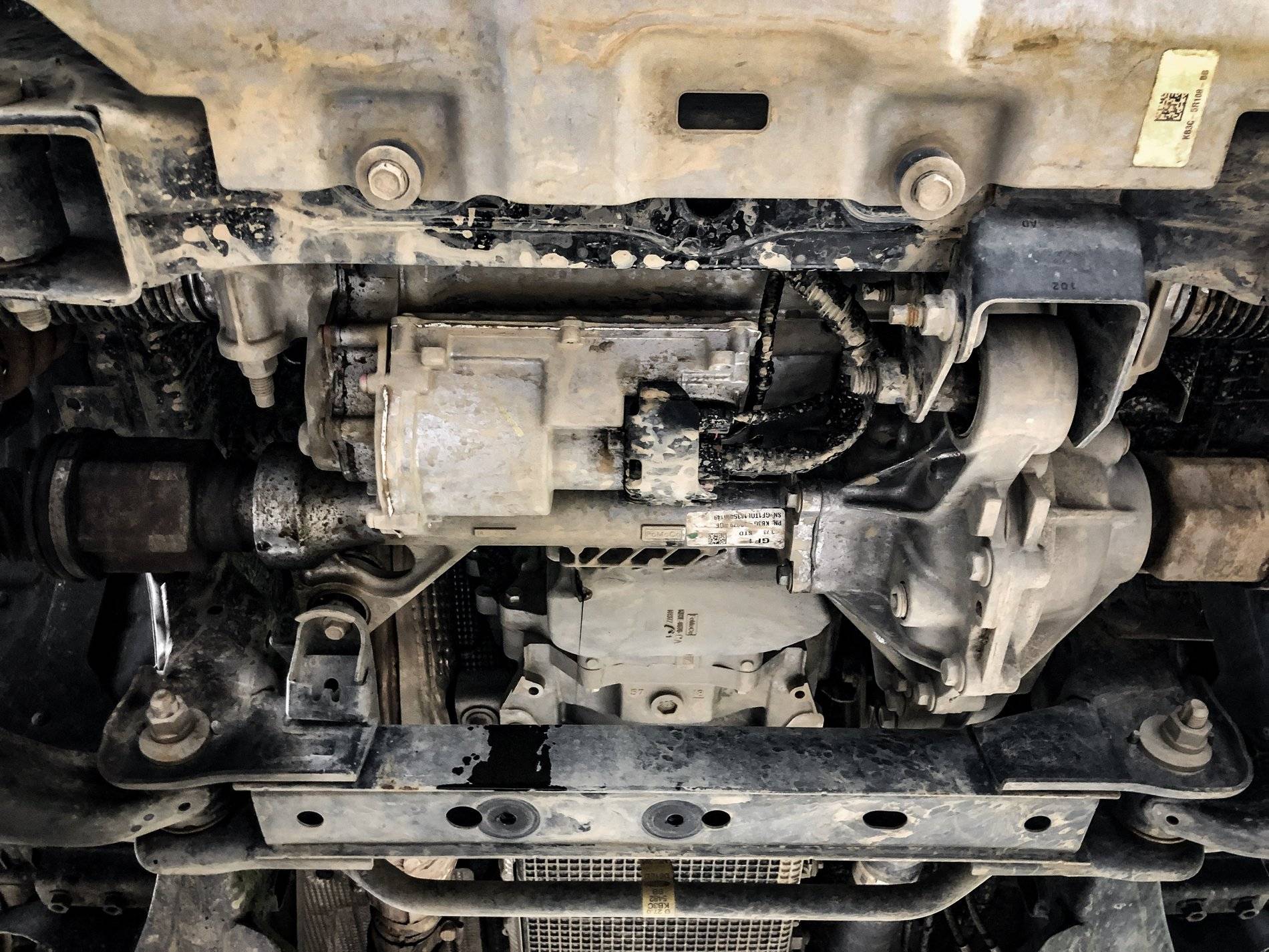

Pulled the plug and watched the nasty black oil drain out, I was not surprised to see it get on the crossmember.
Ford Ranger His name is Steve McQueen 94641E66-1C1D-4C59-8DF5-22F4A116B357

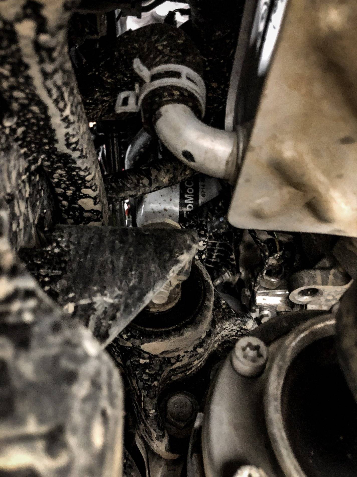

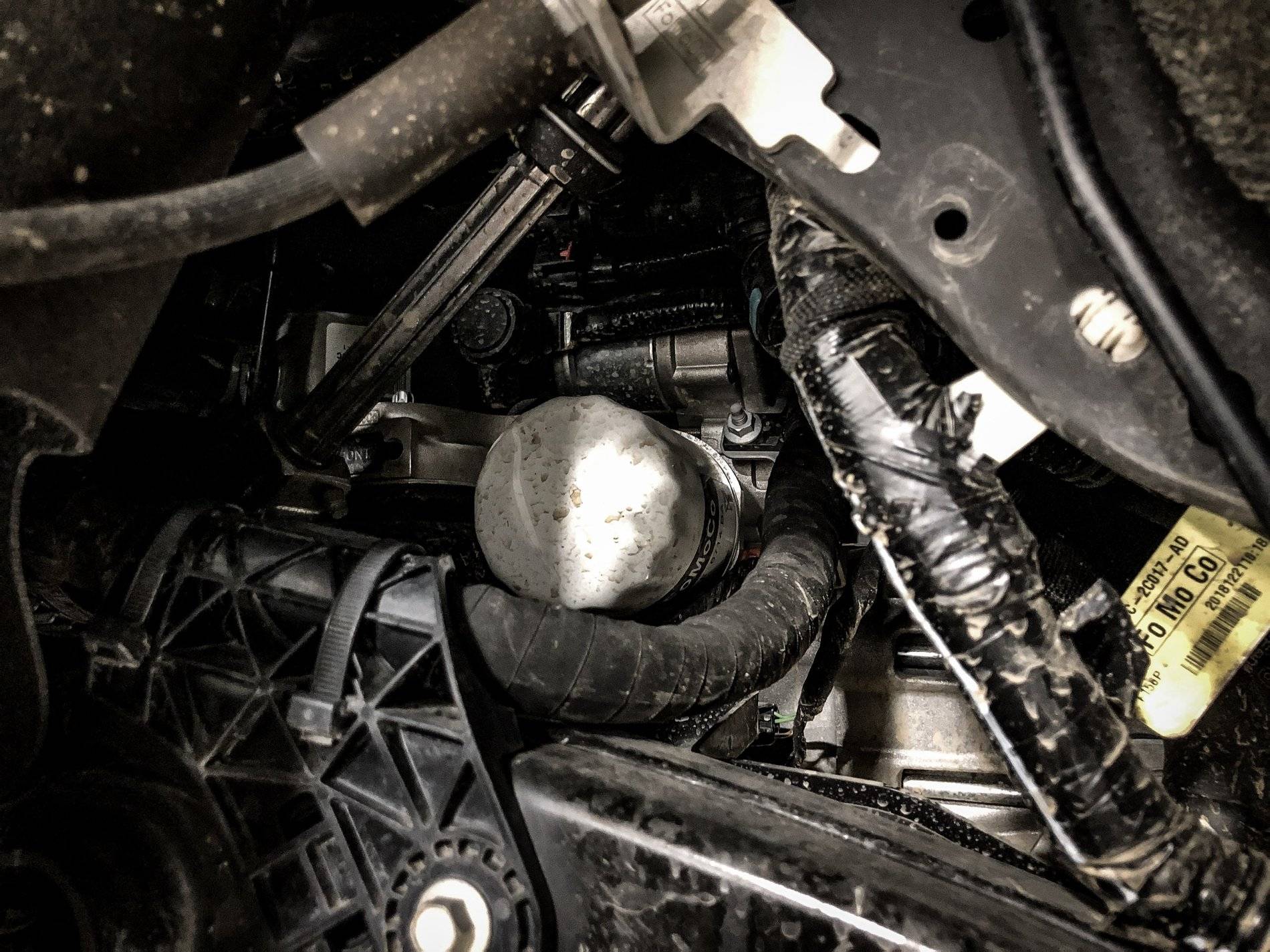

After draining the oil I found that Ford decided to locate the filter in what seemed to be the dumbest area possible.
Ford Ranger His name is Steve McQueen F48C0FC4-B0E2-4555-8086-AEBC2845B727
Upon further inspection I found that in the wheel arch there is a rubber mud guard that can be easily removed to make room for my oil filter wrench, needless to say it was much less terrible than I initially thought.
Ford Ranger His name is Steve McQueen DF85C928-21A6-4406-8E18-4E5C9B1ECB1C

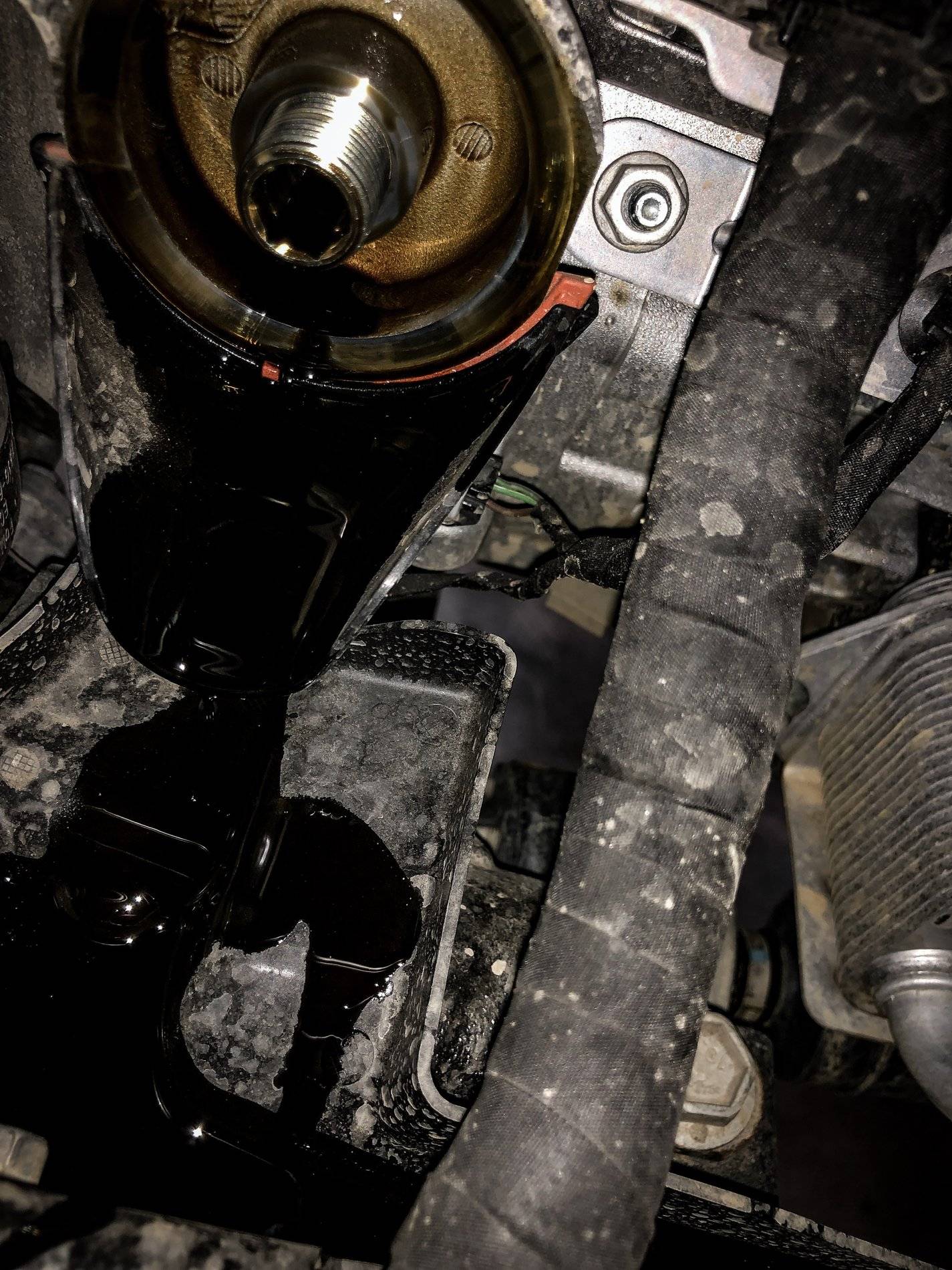

Once again it seemed that a mess was going to be made, thankfully they thought ahead once again. Under the filter is a channel that helps the oil flow out of the back of the engine compartment which keeps the oil from going everywhere. After I replaced the filter I hosed the area down with some brake parts cleaner to rinse the residual oil out and we were back in business.
Ford Ranger His name is Steve McQueen F86C6B01-42F9-4F1E-9370-3CE45A795DA5

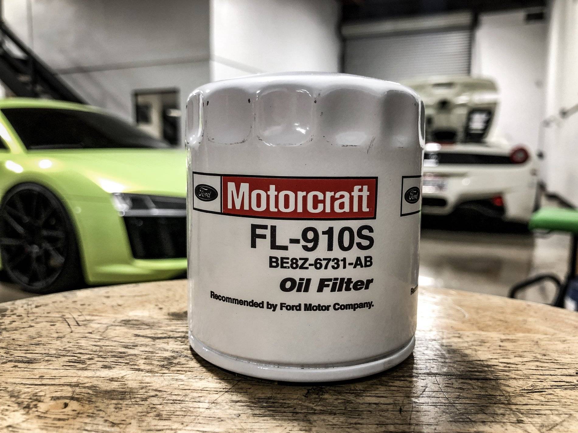

My parts supplier recommended an FL-910S instead of the FL-400S, from what Ive read either work fine.
Ford Ranger His name is Steve McQueen 42B4AFCF-3DE3-4064-88EC-5BFA13EF2211
What did it take to install the sub? Looking to get one put in, but were there low level outputs on the back of the radio? Would love some more info on the location and size of your install!
Will take photos and post info soon.
How difficult was it to get the cover off of the passenger-side of the dash? I'd love to remove mine to do some cosmetic work to the Ranger Logo that's on it.
it just pulls off if I remember correctly.
