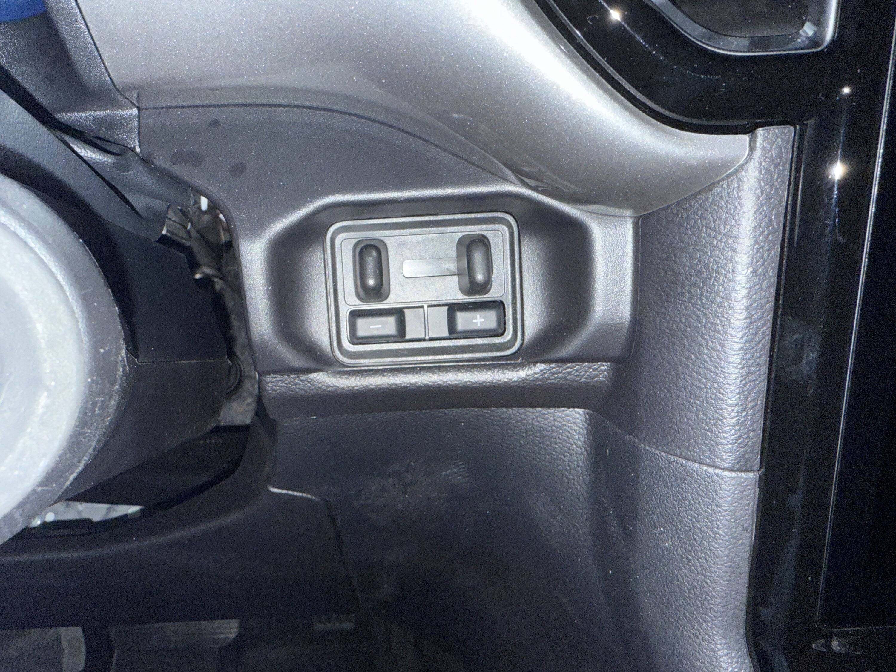

Hello,
Please forgive my ignorance. I just bought my Ranger yesterday and honestly have no clue what this is for. I traded in my 23 Bronco.

In addition to the + and - Gain buttons,, to operate the brakes manually during setup or in an emergency (trailer sway), you squeeze the two bars together (slide the right one toward the fixed left one) to send current to the trailer brakes. You may never need this device, but it doesn’t hurt to know how to operate it….
I am not sure if this is exactly how the 2024 Ranger is set up. I have never towed with my truck.
