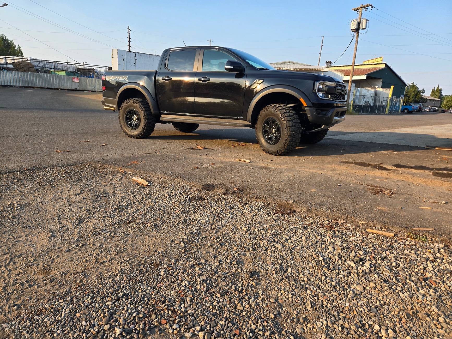

Installed a 1.75" spacer in front and 1.25" in rear.
leveled the rake out ALOT.
total lift is 2.375" front and
1.5" rear.
very happy with the results.

How has the ride changed? Thx
Great ride...a tad more body roll now ( as to be expected) haven't noticed any difference in suspension stiffness....I was wonding about needing to reset the ride height in forscan , but so far I don't think it's necessary.

Wait, the picture shows 1.5” lift front kit..
You used that for the rear?
Need clarification cause I am looking for a spacer kit for the front myself.
I’m only looking for 1.5 for the front to keep my rake slightly but not leveled.

the Fabtech 1.5 will raise either front or rear end this amount...approximately. the angle of the coilover is slightly different front to rear, so is the ratio.

Did you need to pull the axle out of the hub to install? Thx

Why didn't you just use the Readylift all around? Did you need to have an alignment after the install?
Because I did not want to lift the rear a full 2 and 1/2 in.
I already had the Fabtech ones from previously using them on my Bronco.
We did take it in for alignment but it wasn't necessary after looking at the paperwork
