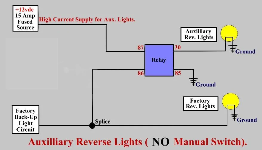

I have done this with my last vehicle. I wound up tapping into existing reverse light and also adding a relay so they would come on when the reverse lights came on. Worked great for years. Something like this....

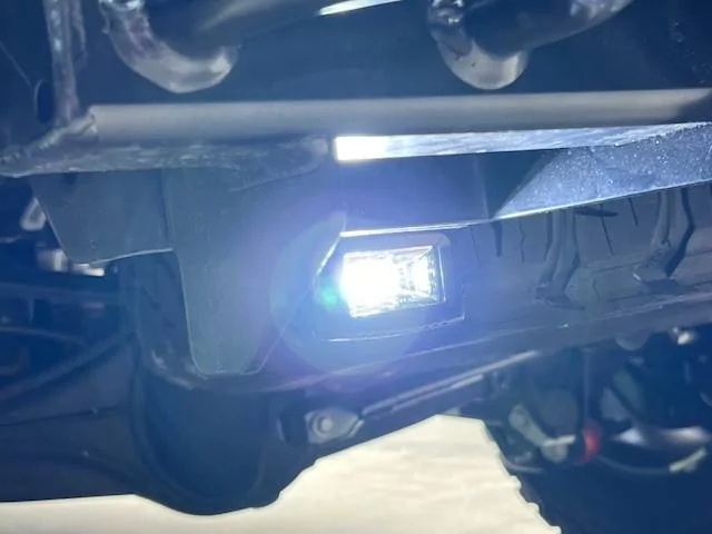

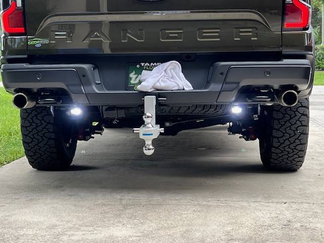

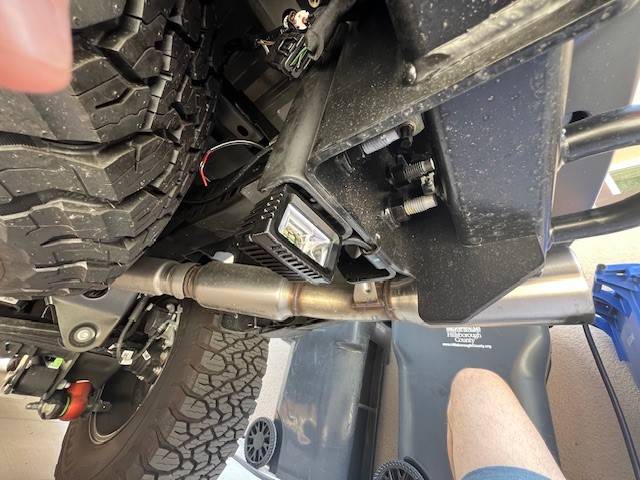

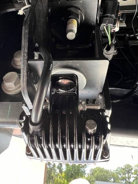

I added these last weekend from Amazon for about $33... They are low profile and pretty bright. I mounted under the bumper in existing holes and used the AUX 3 circuit that is already back there by the bumper in wire loom on driver side.
