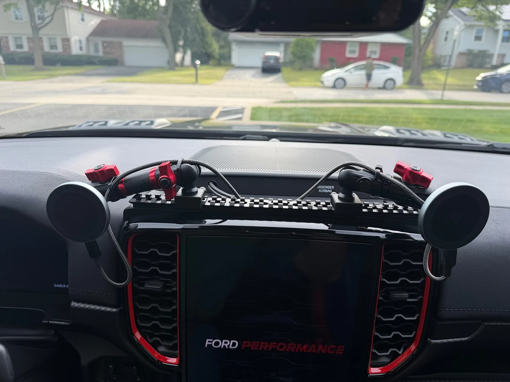

Looking at adding a MagSafe charger/holder to my RR, but I hate wires dangling everywhere. Has anyone determined if we can fish the MagSafe charger wire behind the center stack to the center console USB port? Or is there a plug and play aux charging system like in the Bronco that moves a chart port to the top of the infotainment screen right by the MagSafe mount?

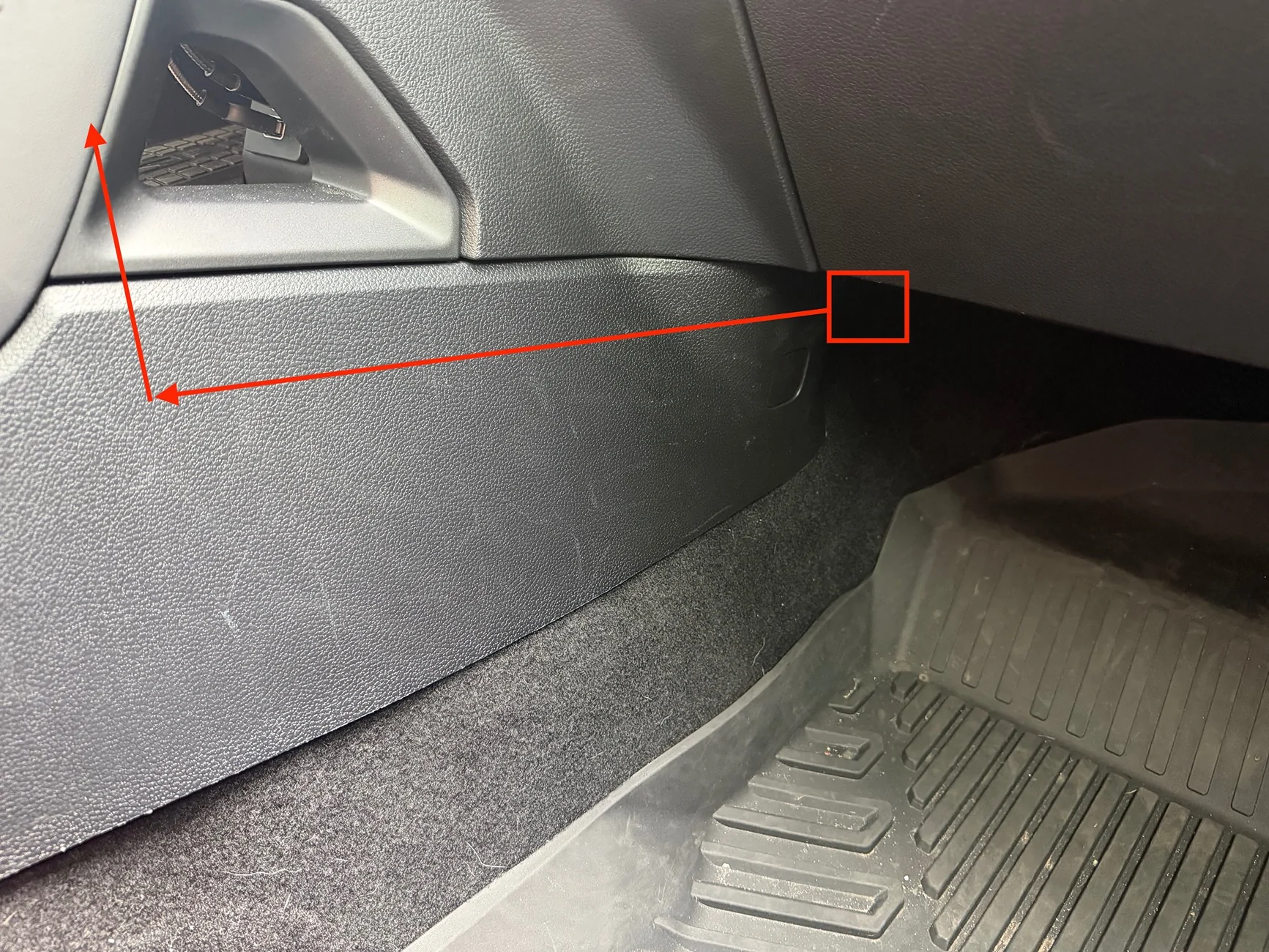

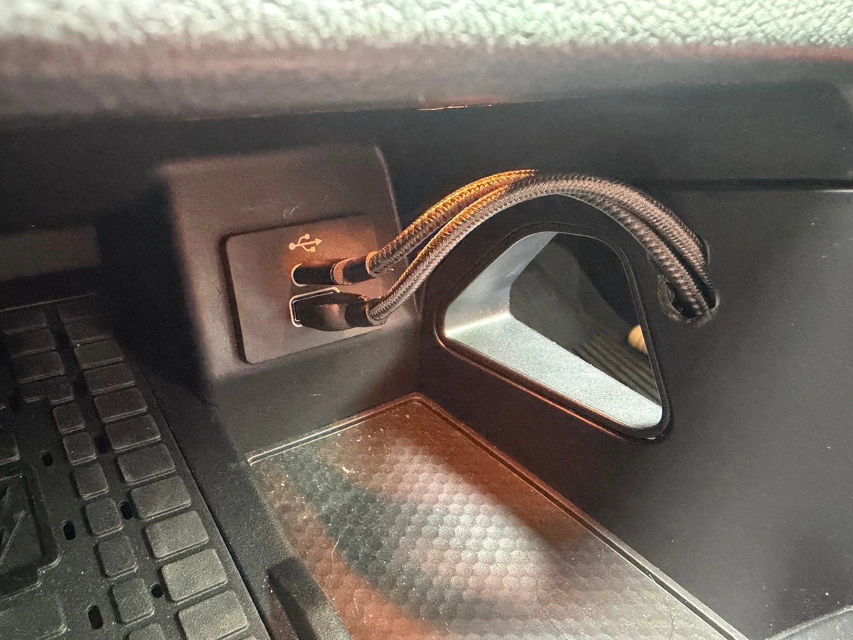

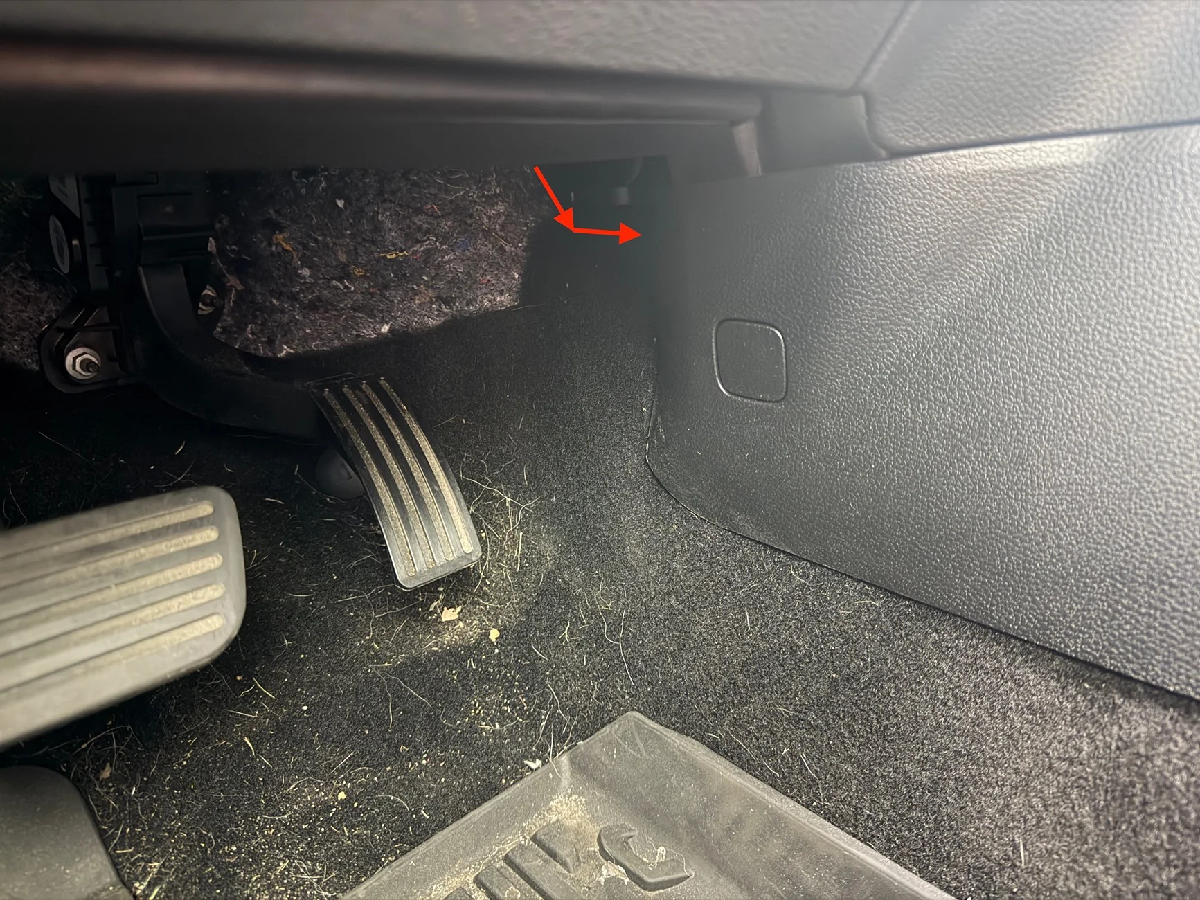

From another thread, I saw someone running cables down through the center speaker hole and followed in somewhat the same direction. I was able to fish a 10 ft USB-C and a USB-A cable from the center speaker hole to the driver side after removing the center speaker, then was able to use a fiberglass pole to get it to the passenger side, then routed it up to the USB-C and USB-A ports. Attaching some photos of what I did. Took me about an hour to do it all, so it want too bad, just need to get some rubber gaskets to clean up the 2 or 3 holes I had to make.
