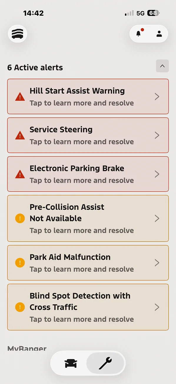

Our 2025 Ranger XLT ( 850 miles )had a host of Messages like what the OP has , No or little Brakes , mobile Techs will come out tomorrow .
will keep update & what they say , it will probably need a Toe to the Dealer Advanced Braking system needs service , was one of them , but it seemed everything was affected .

Of course when the Tech. started the Truck , no codes . Went for a test ride & all was ok , he updated the Trailer control Module & when for a second test drive & BAM , no or little Brakes & all kinds of the same messages , kinda scary . Has to be towed to the Dealer , he thinks something is shorting out the ABS Module , we will see .
If any of you are old enough to know Cable actuated type Brakes on the Old Harleys , it's like grabbing the Front Brake to stop , that kinda scary . Like a slow down not stopping !

Well the ABS module took a dump , back ordered till 4/27/26 .

Got the Ranger back yesterday , seems they replaced the complete EBB & PMI''d ( not sure what that means ) the ABS module & bled the Brakes .
I will post the work done page if anyone wants to see it .They said they pulled strings to get the parts early & its the fist time this problem has come up ( ya OK ?)
