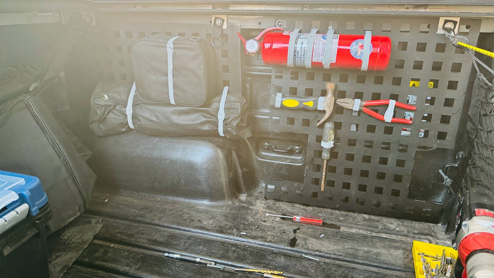

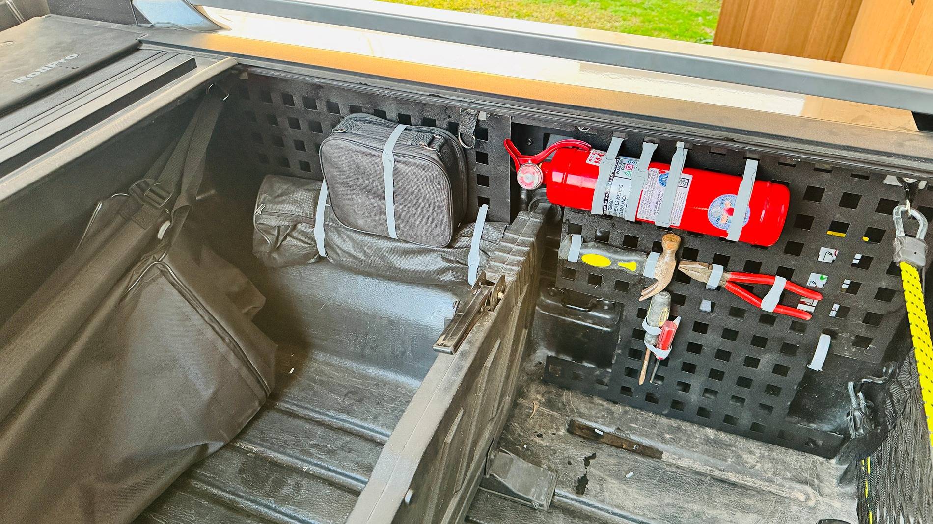

Well, I saw the post related molle racks available in the USA and I wanted one, but being in Argentina was a problem, getting that shipped may be difficult and also the price was a little high for me, so I decided to build my own racks.
I used a sheet metal, Rust oleum spray can, an angle grinder and some bolts.
Here it is the result. It is not the final version, but it is functional.. All the stuff has been fixed with "velcro" ties, so everything can be removed easily and put it back again.
I need to see how it goes during "rides" but everything looks well fixed.
Total cost: 90.000ARS aprox: 70usd.

I dont know how well the velcro will do but the racks looks good and are priced a lot better than others on the market
