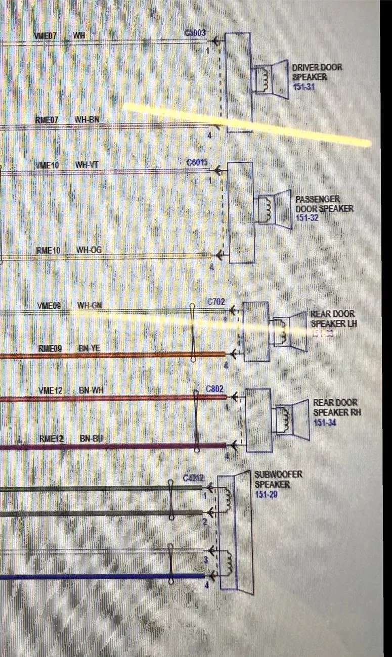

If someone has a wiring diagram for a Ranger Raptor or other (Lariat) B&O Unleashed, I need the wire color/diagram for rear door speakers post amplifier.

I think this is what you are looking for. Sorry for the quality, but the wire color codes are on there.
Ford Ranger Need Wiring help IMG_1764

Yes. Thank you very much. I appreciate it
