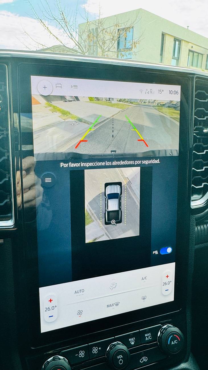

I was working with a 360 camera view setting that initially displayed "UNCONFIGURED OR PARAMETERS NOT SET" and functioned perfectly with the camera views filling the frame properly.
However, I decided to experiment with the other available options: "VERTICAL TOP," "VERTICAL," and "HORIZONTAL." After testing all three settings, I discovered they all render the 360 image significantly smaller than the frame, creating unwanted empty space around the image.
Now I'm trying to revert to the original configuration, but the "UNCONFIGURED OR PARAMETERS NOT SET" option is no longer available in the dropdown menu - only the three problematic options remain visible.
How can I restore the original setting that properly sized the 360 image to fill the frame? Any assistance would be greatly appreciated.

You can revert back to your original settings by restoring the backup you made before you started modding the settings. You know what setting you have working so it would take no time to change those.

I havent backed up!! :( this is how it is looking now, you can see that the 360 area is smaller than the black frame. it did not fit the whole screen but the black square.

Yup, you either go through the asbuilt module for what ever changed that and conpare it to your original saved settings, line by line, or you reload your stock saved profile and redo the other stuff that you want
