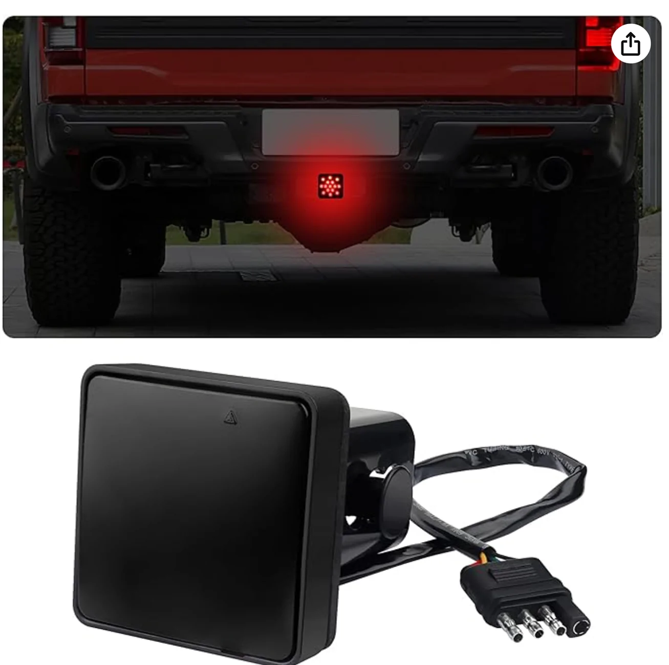

You can try something like this.
It should be enough to fool the auto trailer detection into thinking you have trailer which will trigger your mirror cameras to activate with the blinker.
Note:
To keep some of your other safety features working like blindside monitors, you can setup a dummy profile for the trailer that it is detecting that is not there.
You can setup a trailer profile of like say a 2ft long trailer and that gets the BLIS back on. Your rear park sensors would remain off.
Ford Ranger Side camera view when turn signals are on ... Can I program this? 1765736597327-3x
https://www.amazon.com/carleef-Rece...brake+light+trailer+plug,aps,151&sr=8-16&th=1

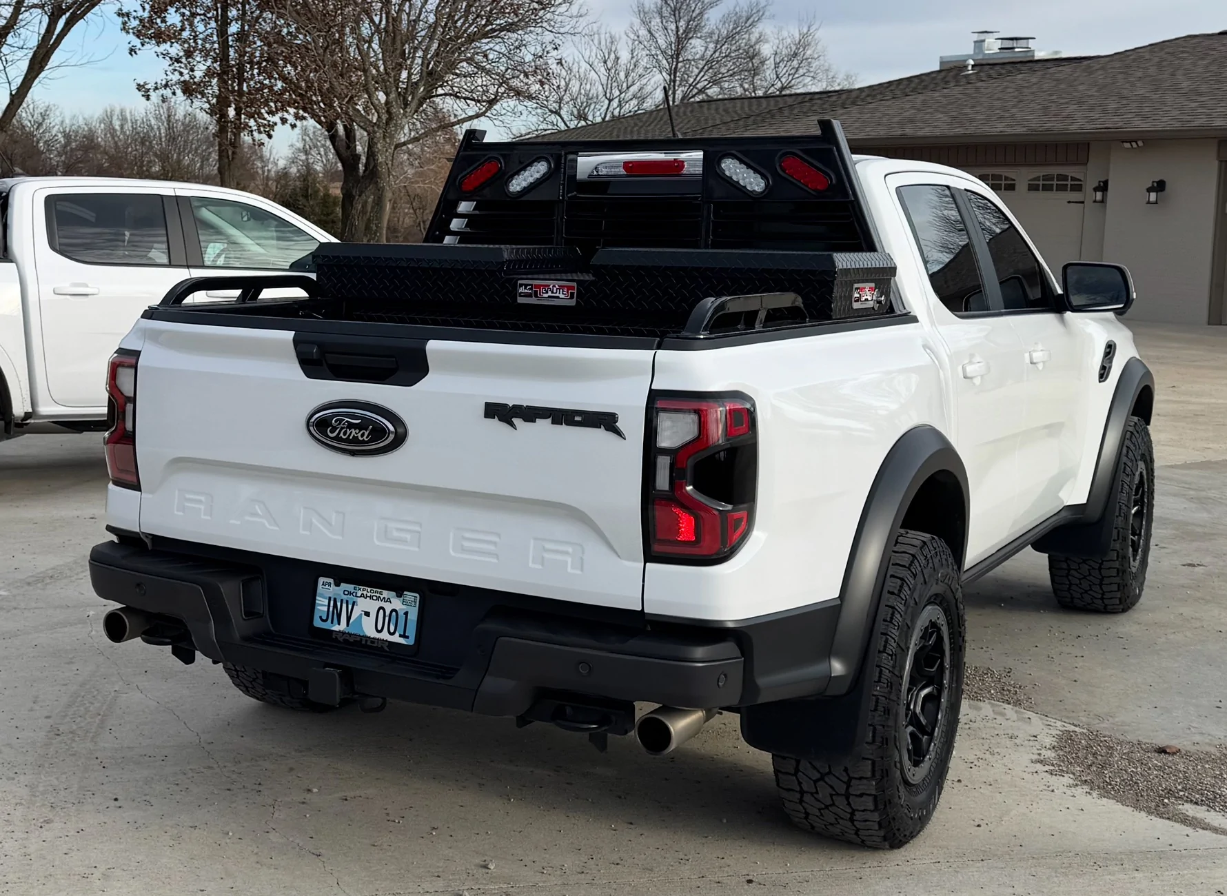

I had to do these things with my lighted headache rack, since when tapped into trailer wiring the truck always thinks it has a trailer on it.

Thanks. That's a reasonable suggestion which I may try, but I'm hoping for a "cleaner" solution.

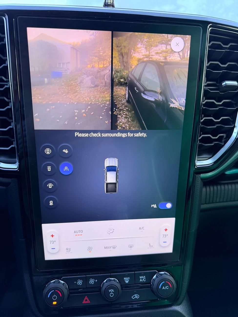

I suspect it can be enabled in FORScan but I can’t say for sure. Shortly after I bought my Ranger I used FORScan to change my wheel/tire size, and while there I also enabled the camera side views while driving. The attached photo shows the view (it’s not a great photo because the truck is sitting in my driveway) but on the road it’s nice to see at a glance if I’m centered in my lane, or if I can “hug” one side more if I need to. I just don’t recall if I saw an option to enable a side view with the corresponding turn signal.
