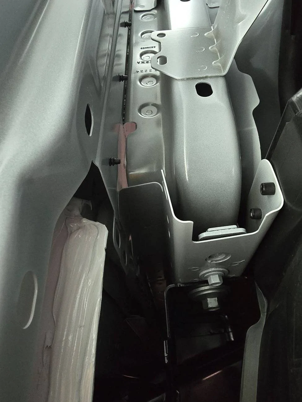

I would have a look underneath. My build date is 8/24/2024 and has the updated bed. The official doc has build date from 1/4/2024 to 7/15/2024.
Link to the doc
This is what the updated bed looks like:

My RR was built the week after 7/15 so maybe I need to take a look underneath and see if I have the updated bed that doesn’t need the J-braces. It got delayed 2 weeks, so maybe this is why it was delayed.
