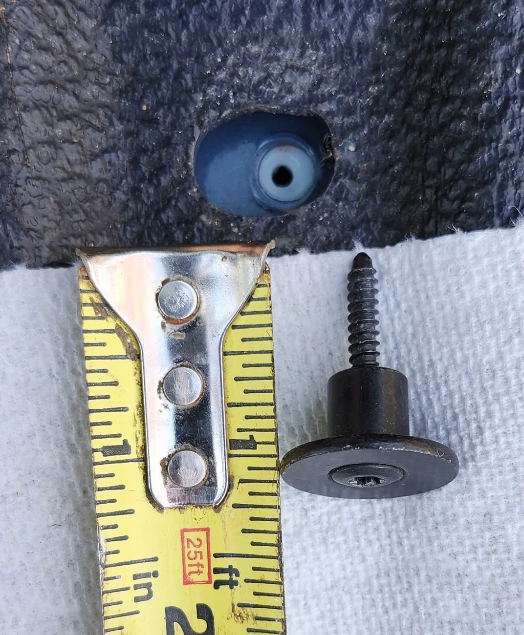

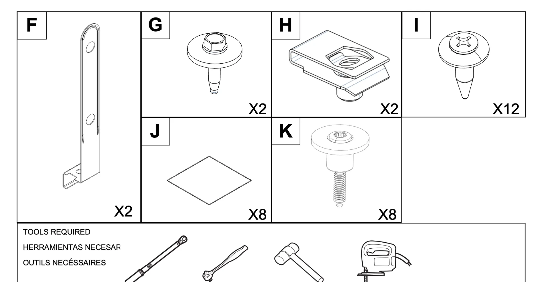

The fastener is a 1" self-threading screw, with a with a 7/16 stand off. It's part of the 'kit' I installed and here's some info. It's not described so I just went a took one out. See part "K" snip and as in the page 10/11 of KIT, PICKUP BOX LINER and TAILGATE LINER document SKR1WJ-J286D64-AA, © Copyright Ford 2023.
Ford Ranger OEM tailgate liner tailgate_fastener_K_
Ford Ranger OEM tailgate liner fastener_K
