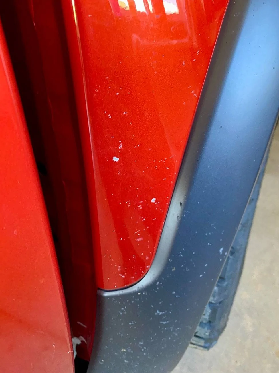

Be advised before taking off the existing steps you will need to protect the rear fenders with something. The front tires pick up rocks which will significantly chip the fenders and the plastic extenders. I learned the hard way. If you use a clear wrap go up the fender as high as the bottom of the gas filler cap.
Thanks for the feedback. I have heard the stone chips are an issue, but one picture is worth a thousand words. I am looking at ppf options for the affected areas.

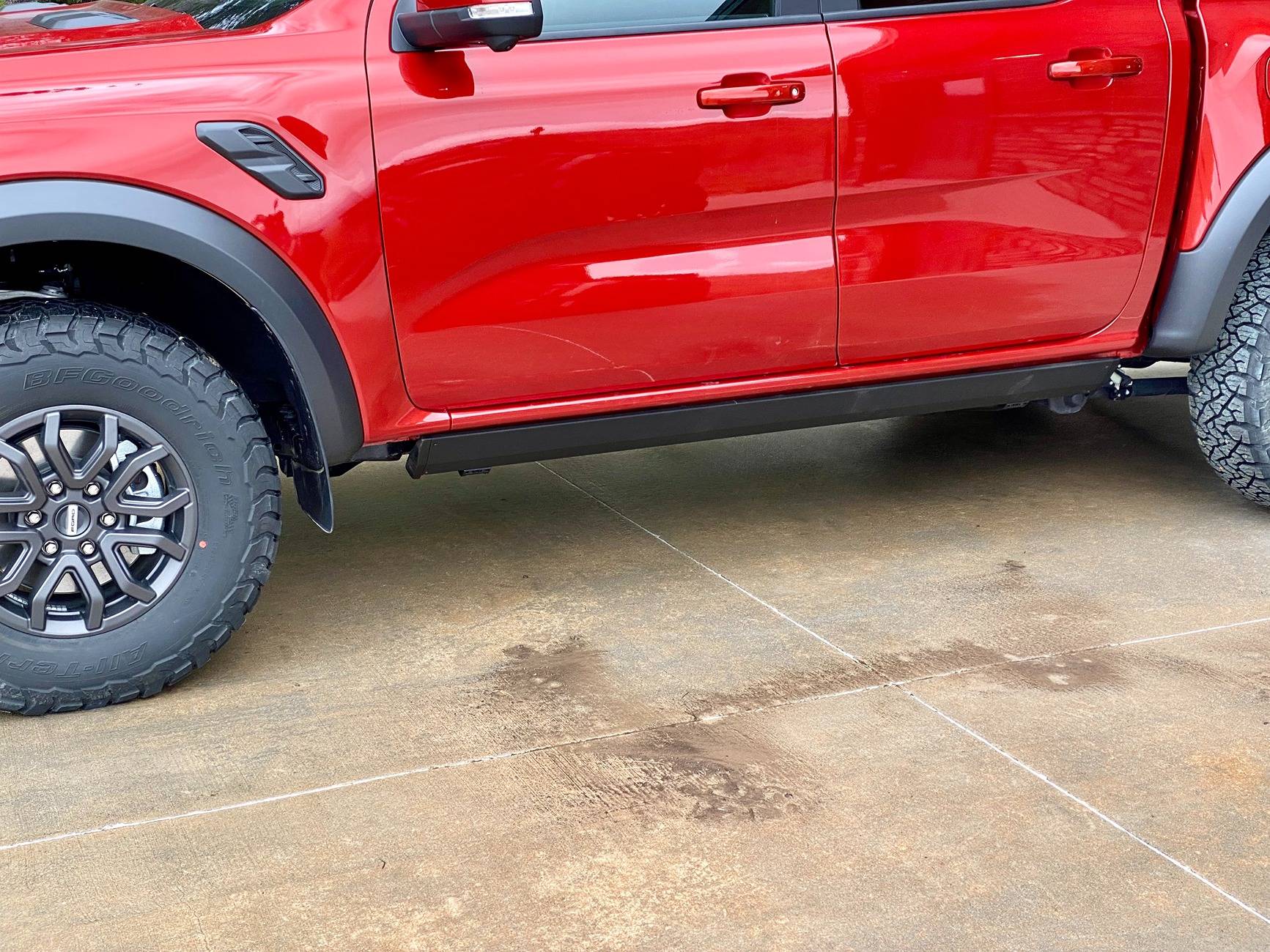

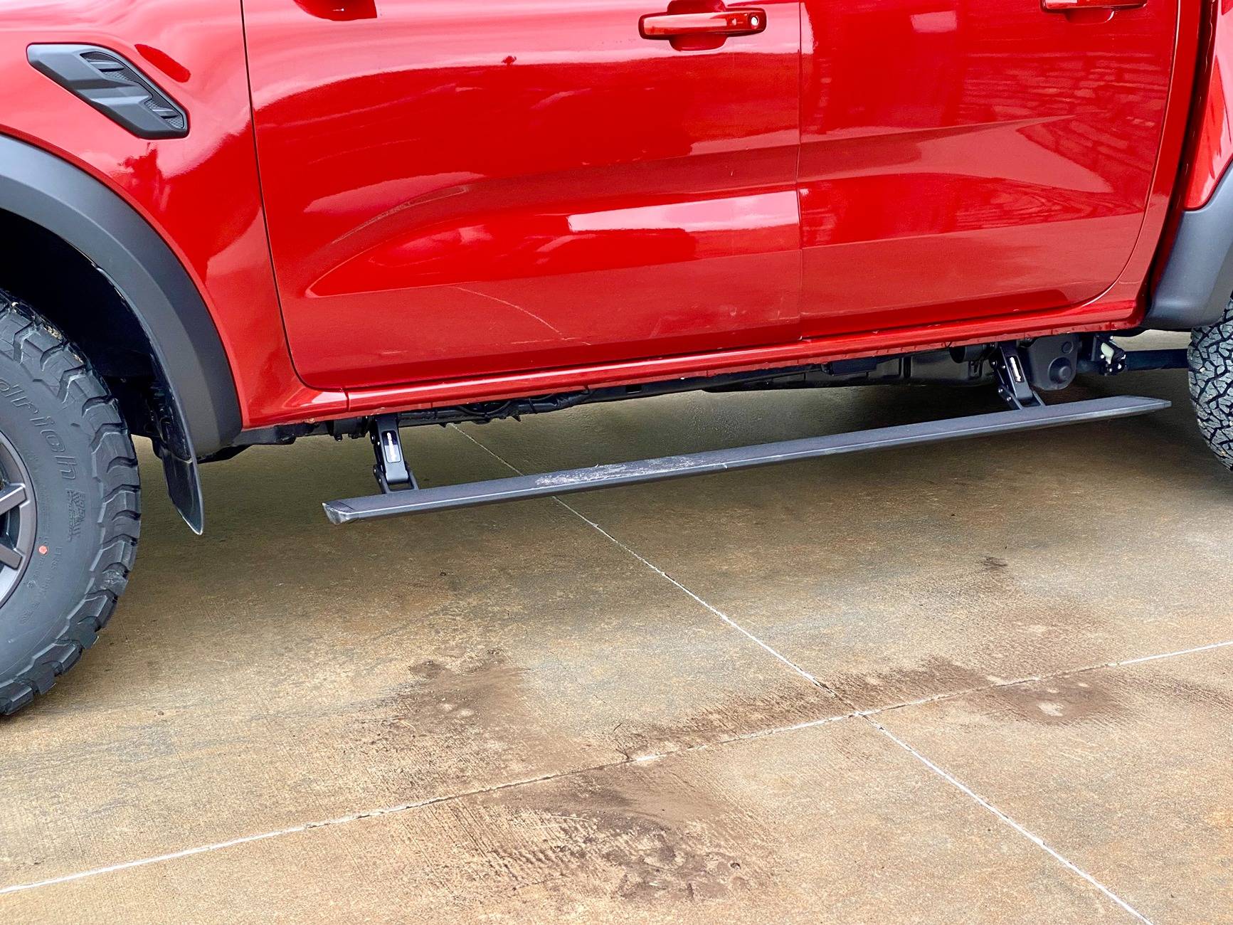

Here's my E Board Saga:
Ordered the Go Rhino Volt Steps. Got them on sale from a Real Truck local dealer. Came in, brought the truck to the installer (same place I bought them from), left the truck with them was home for an hour. They won't fit, they couldn't square up the brackets.
More forum research.
Ordered the AMP Research E Boards off Amazon (they had them in stock, nobody else did). Got the boards Lickety-split from Amazon. Opened the box, directions were online, scanned the QR code, directions say for 2024-2025 Ranger but NOT THE RAPTOR! Call AMP Research and they confirmed saying, Raptor electronics differ from all other Gen 6 Rangers. Amazon picked up the Boards the next day and refunded my money.
Westin said their boards were out of stock, but I found e-Trailer said they had them so I called and ordered a set. The nice Lady said they would ship directly from the mfg. I informed her that Westin said they were out of stock. She asked me to hold while she called Westin to see when they would be back in stock (I couldn't get Westin to let me speak to a Human) and to as specifically if they fit a Raptor. She had me on hold for a long time but came back and said 2 to 4 weeks until shipping and they definitely fit a Ranger Raptor.
In the meantime eTrailer sent me a list of installers near me and the one closest to me called me the next day. WOW! I explained the boards were back ordered, and he asked that I call back when they arrived. They arrived last week (3.5 weeks after ordered) and they were installed today.
They look great, work great and were worth the wait.
