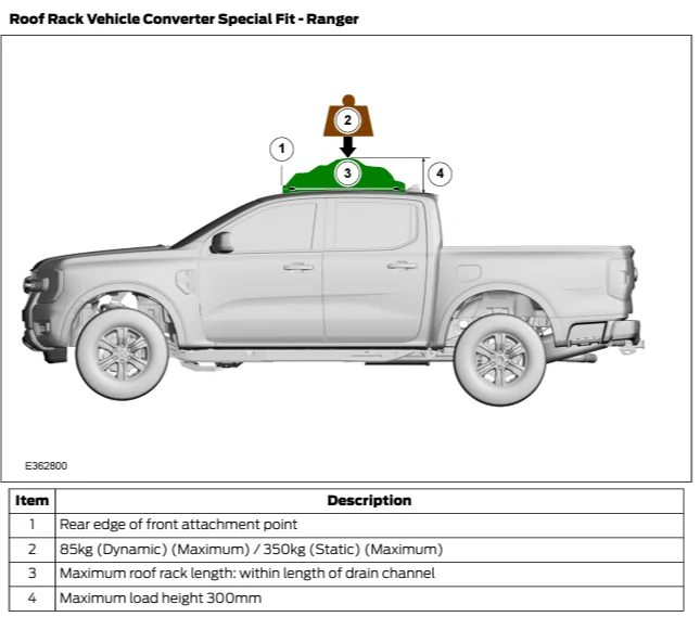

Thank you sir, with this i identified how much weight can handle the roof racks !!
