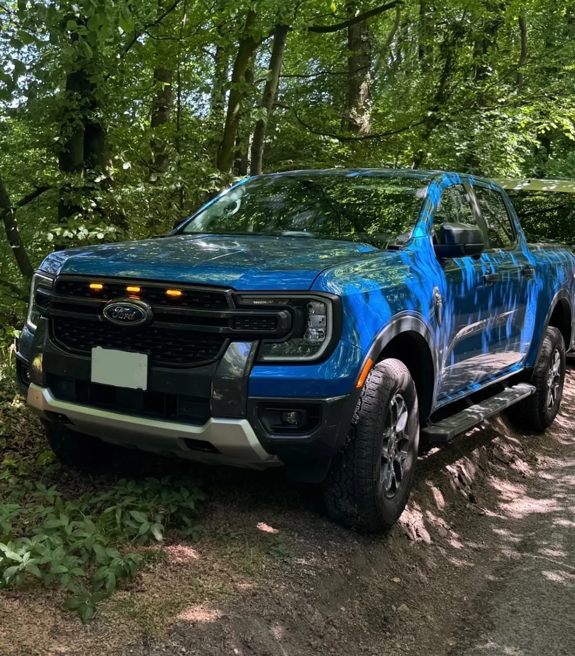

The link you sent was for non-Raptor grill lights - but the Ford Ranger T9 (global model, slightly different from U.S.-spec).
That T9 grill is not the same, so I don’t recommend getting those.
I was an idiot and bought raptor grill lights for my XLT. Rather than return them, I drilled holes with a 5/8th bit through the grill and use a bit of permanent mounting tape.
Has held up well for over six months.
Recommend tapping the marker light on the drivers side. A fusebox tap exposes the box to more corrosion.
