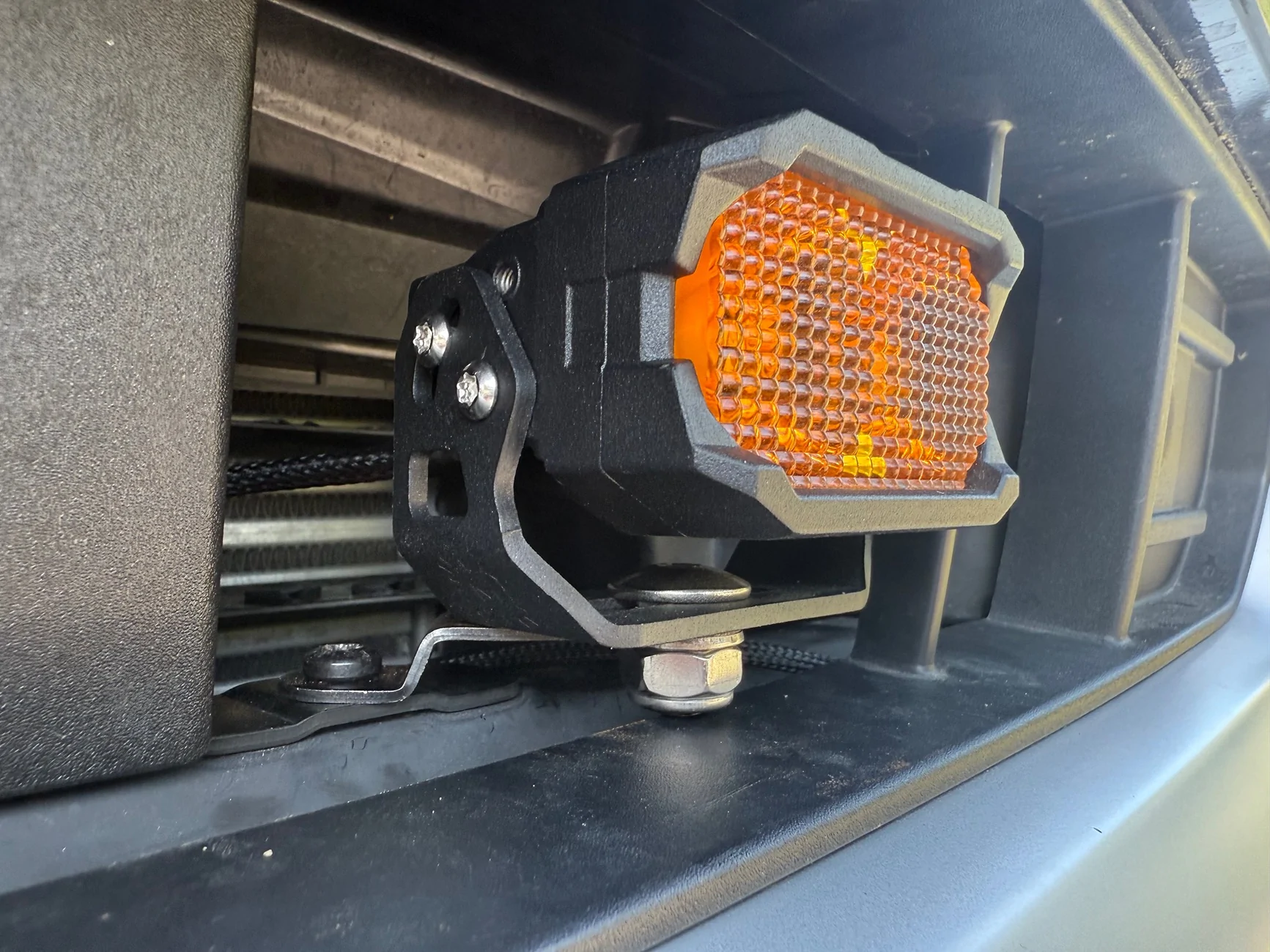

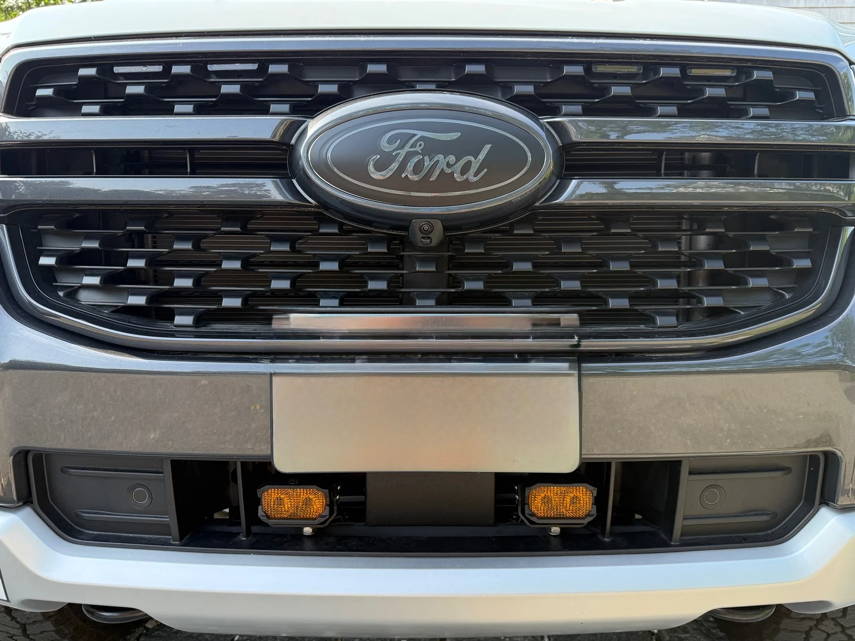

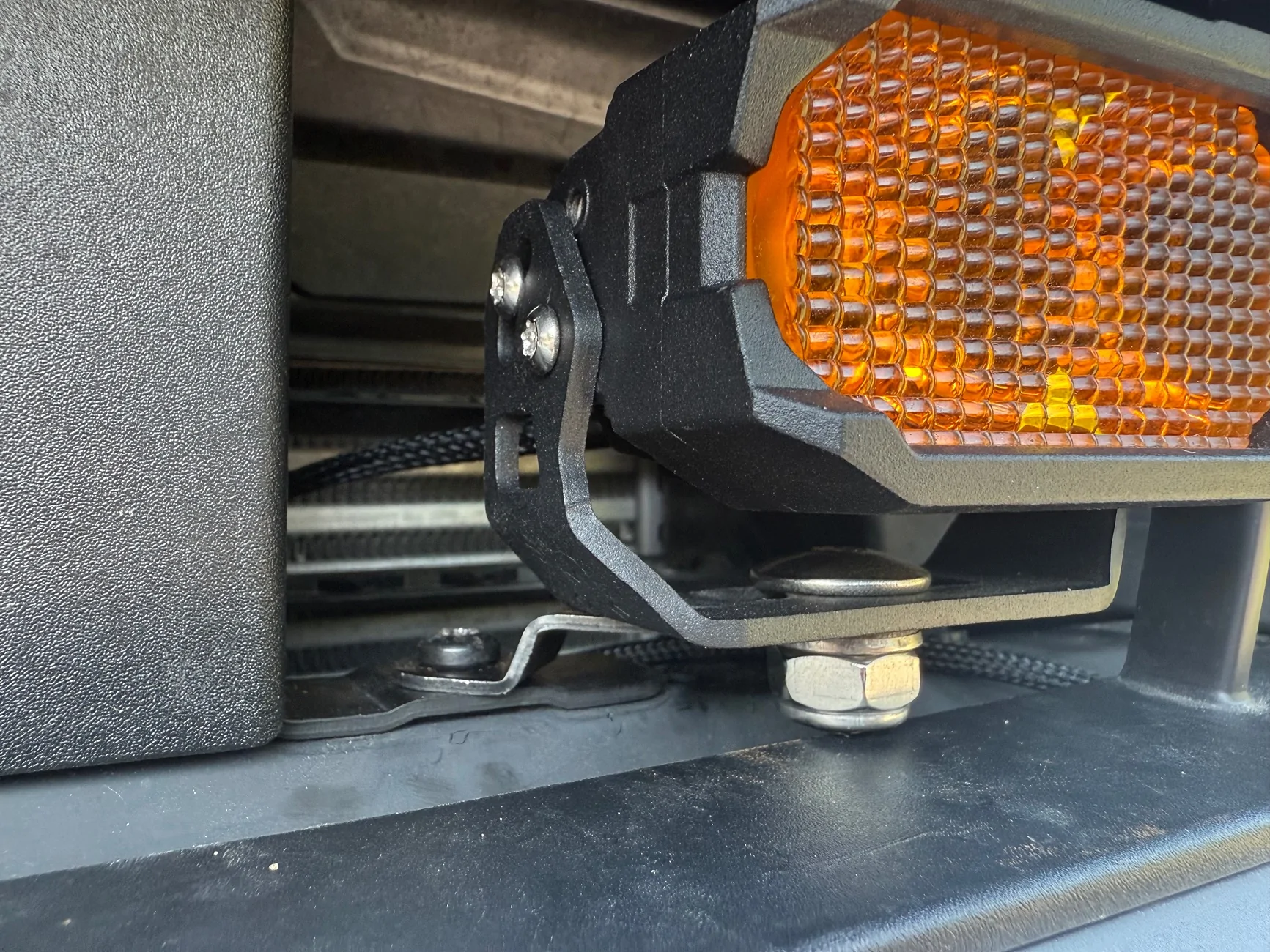

Finally got my aux fog lights installed. Tried a bunch of different brackets before I found something that worked well. They seem very solid. Need to add some washers but otherwise good to go.
only modifications needed on the bracket were drilling the holes larger. Also had to grind down the morimoto bolt to make it fit.
morimoto 2 banger wide beam
<<Deleted original bracket link because they rusted. See below for a link to a better replacement>>
here’s the bracket (I pray they don’t rust)
Mewutal 10pcs Z Brackets 1-3/4"... https://www.amazon.com/dp/B0DV36ZS28?ref=ppx_pop_mob_ap_share
No interference with the Adaptive Cruise radar? I like this setup, smart!

No issues at all. I’m going to swap the brackets out for something more corrosion resistant eventually but otherwise they work perfectly.

The original brackets corroded almost immediately (as I suspected). I have now replaced with these which are Stainless. Had to shorten them with a saw and dremel but no issue and the dimensions are otherwise perfect.
https://a.co/d/aeWjSKv

Awesome! Have you installed upfitter switches? If so, which did you go with?

They look great! What upfitter switch solution did you go with?
