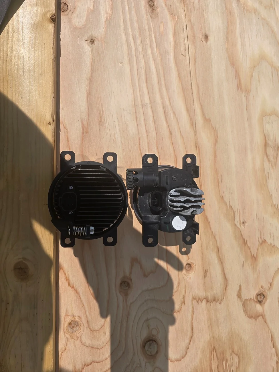

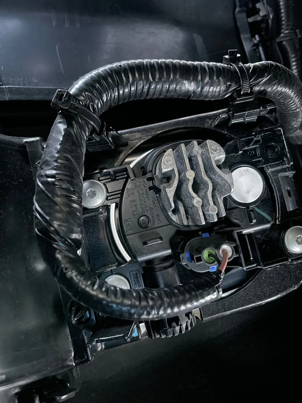

Not sure about the bronco fitment. But i can confirm 5th gen ranger foglights fit. I am running diode dynamics ss3 pros. From 5th gen ranger. Ive attached a picture of the oem foglight best i could

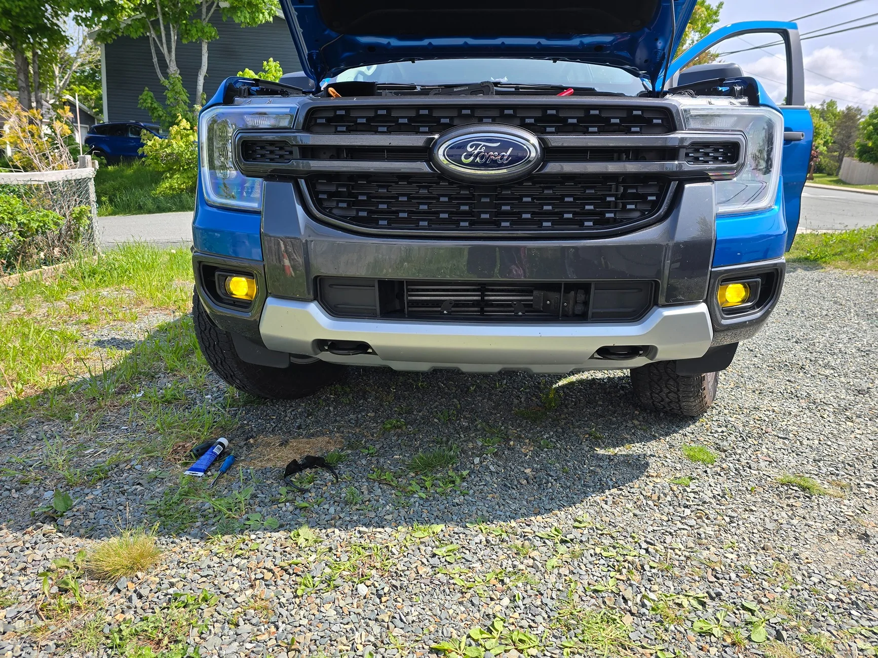

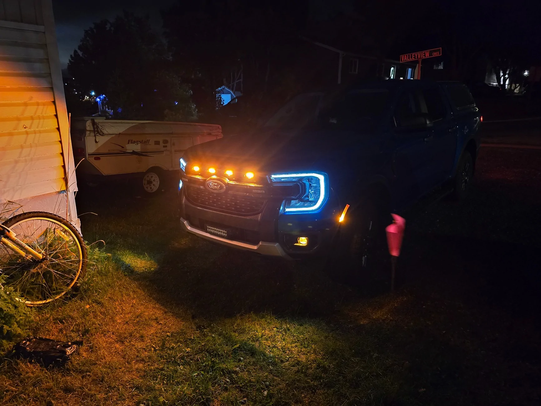

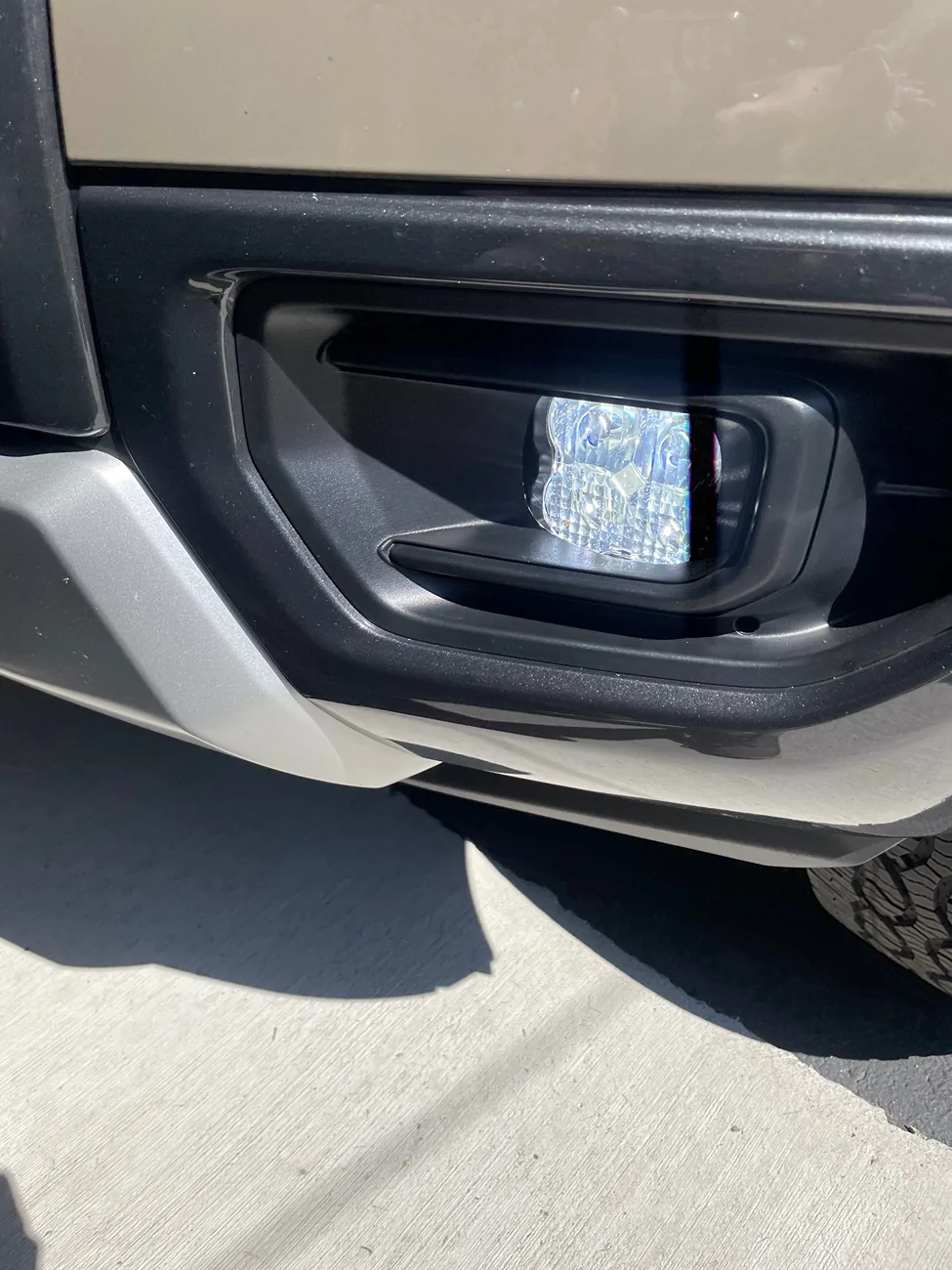

and Im running gen 5 diode dynamics elite series. instead of the ss3 pro's I had on my 2012 escape, so I could upgrade to a new pair later down the road to a set of ss3 max's for my brush guard.

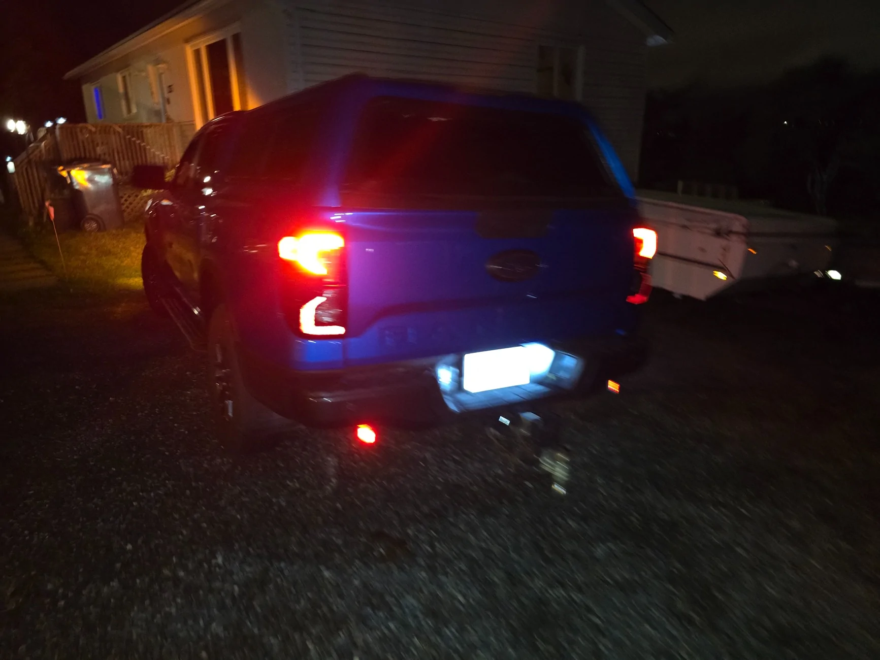

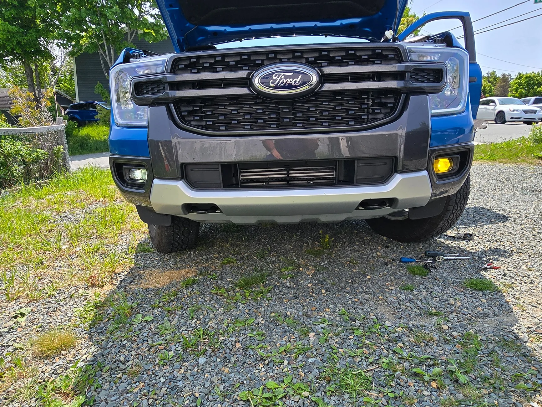

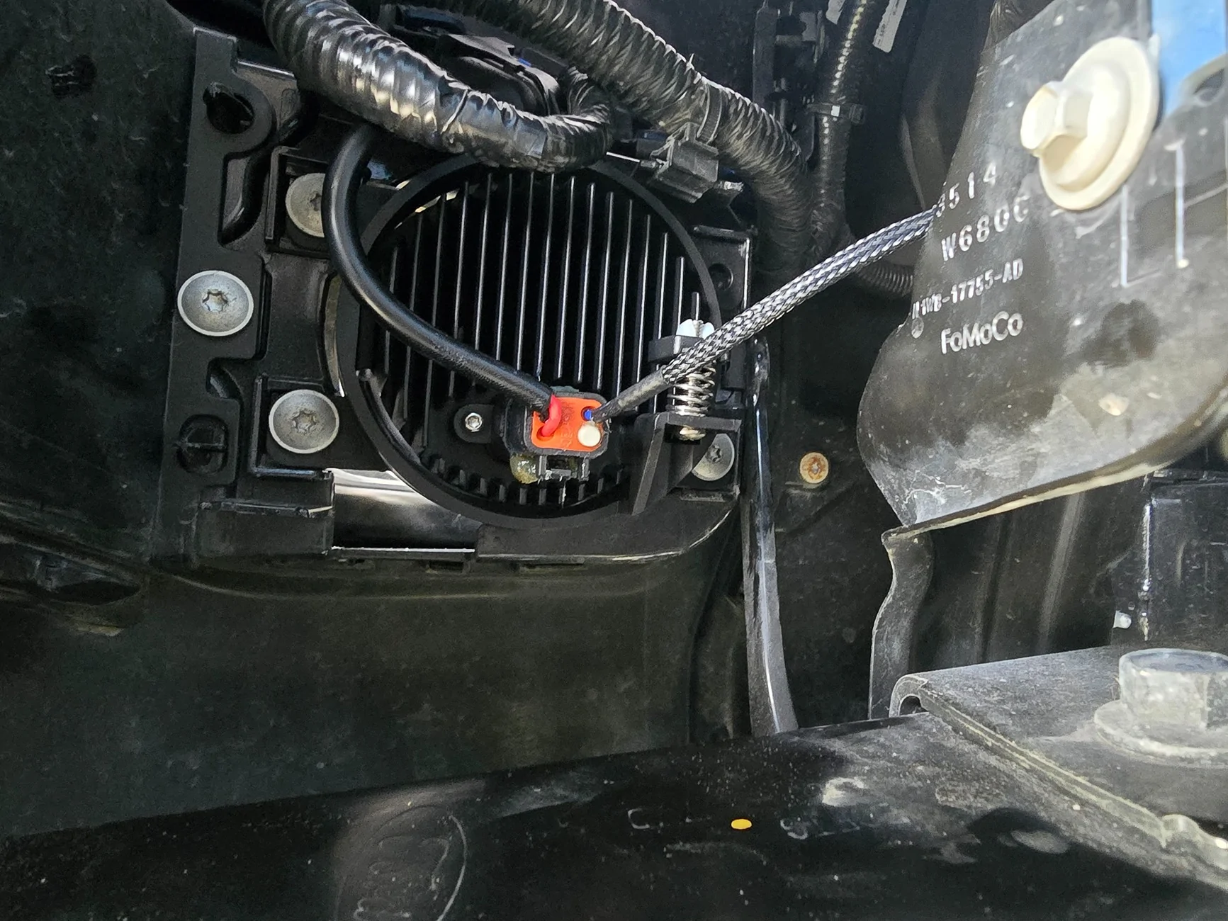

Wasn't bad. I did it sat on the gravel driveway. throught the wheelwell. Turn the wheel to the right for the left side. and vice versa. A lift would be of been nice. But you can do it without taking tires off. Just a few pop clips and move the liner back. I bent mine back and hooked it to the control arm/tie rod to keep it back.

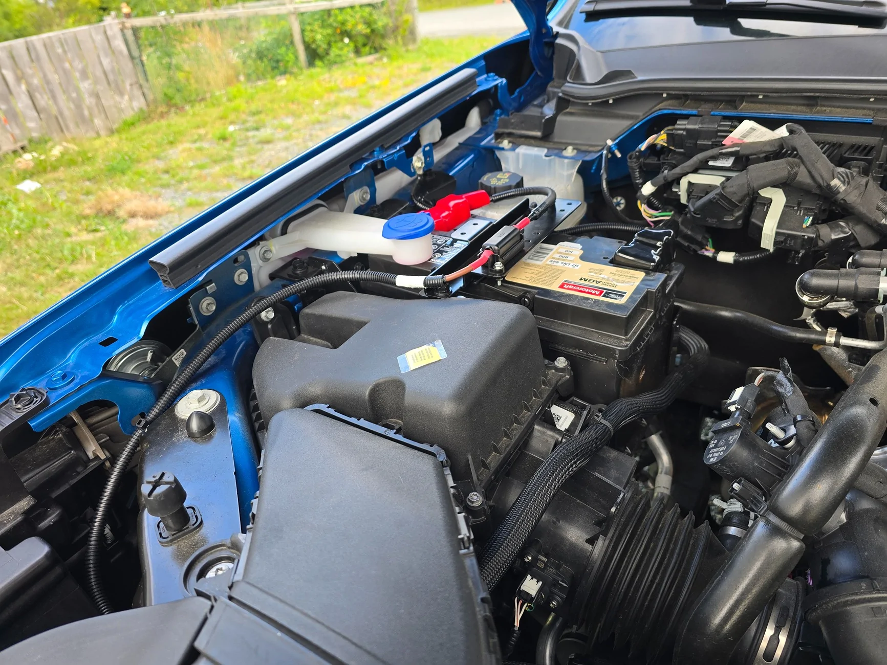

and mines a lil different :p even running arb dual battery kit that I had to order from aussie land. not available in North America ;)

Did you find the new fog lights pretty much aimed properly out of the box or were some adjustments needed? I have these on the way.
each vehicle is different, so I had to aim them. had to bring them up
